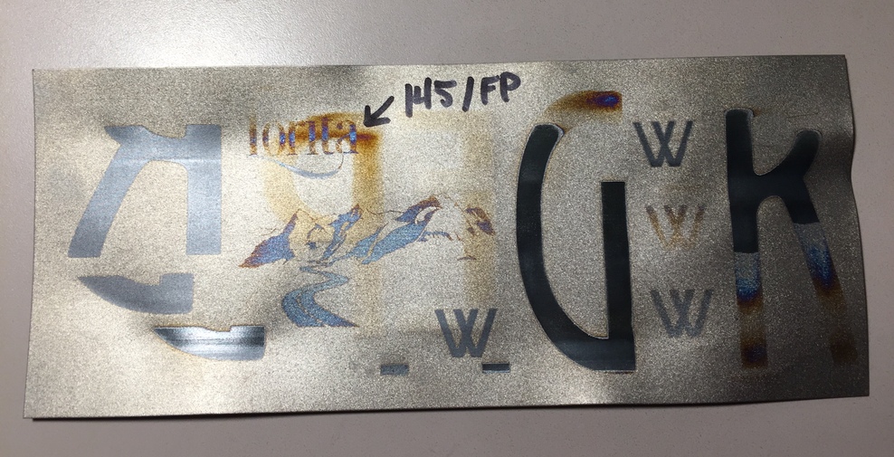

This is a piece I ended up using for testing…it’s a wavy mess from all the various places the laser beam hit it.

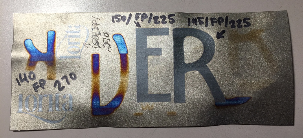

Cool experiments! In that test where you got the nice gold, blue, and purple… the increase to 270 LPI would deposit more heat. Closing in on the sweet spot there looks like. There is also that sweet purple outline to the blue, great effect!
Between focus, power, speed, and resolution there is a lot of possibilities to play with!
You may be able to tap that piece flat with a mallet or some soft blow besides a metal hammer so you don’t get any tool marks on it.
Sort of made me laugh…that ‘great effect’ is actually the back side of the piece…it’s the reverse side of those large black letters in the second photo on the right side…which the laser didn’t even completely finish. I would love to get those colors, but it’s all a crap shoot. So far, the image of the mountains is the only thing that comes out with color. I found that the image and the smaller texts do just great at 270 LPI, but the big letters have to be at 225.
I bought a nylon hammer to use to form the Ti into the basalt basin, but won’t bother trying to flatten that test piece…it’s too far gone.
