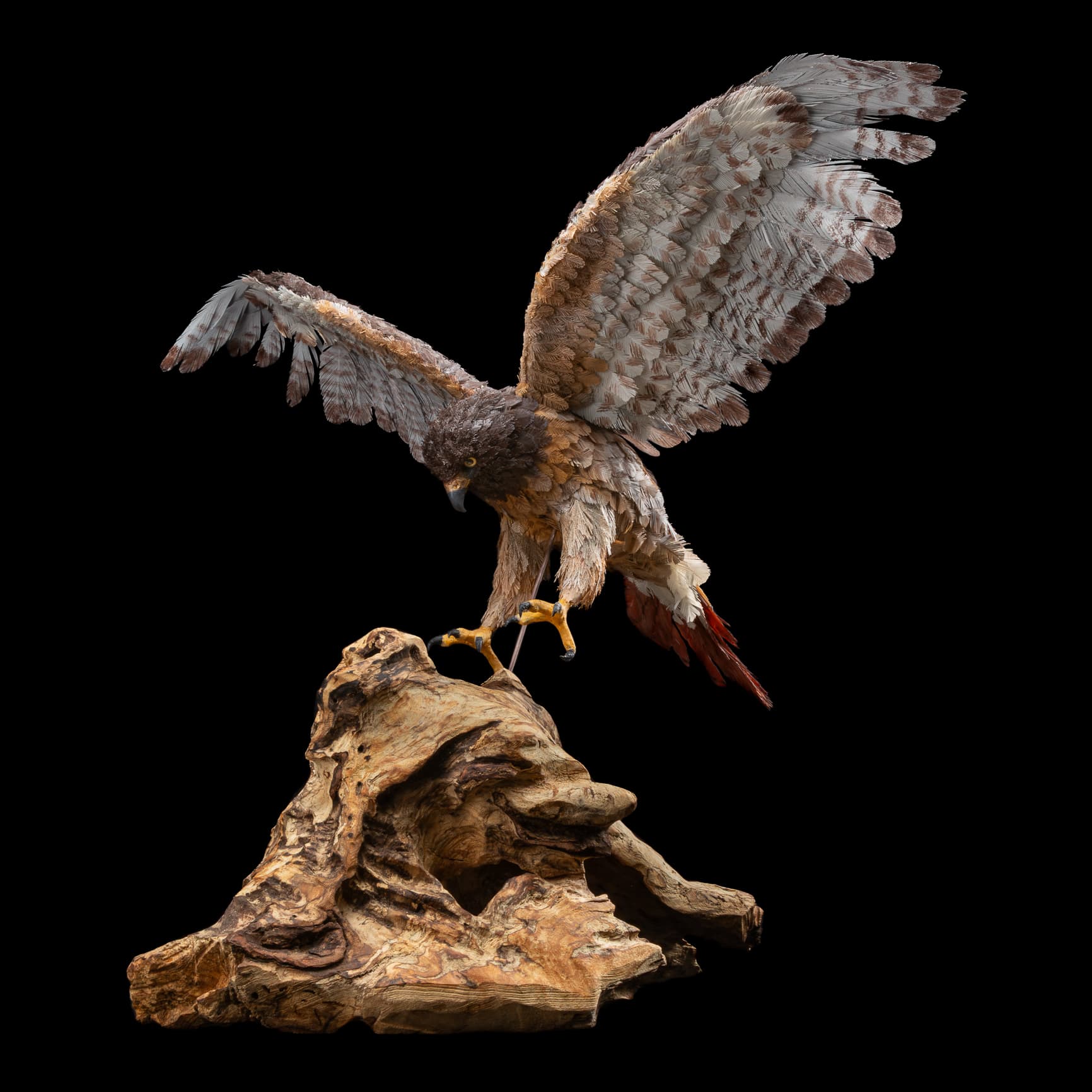

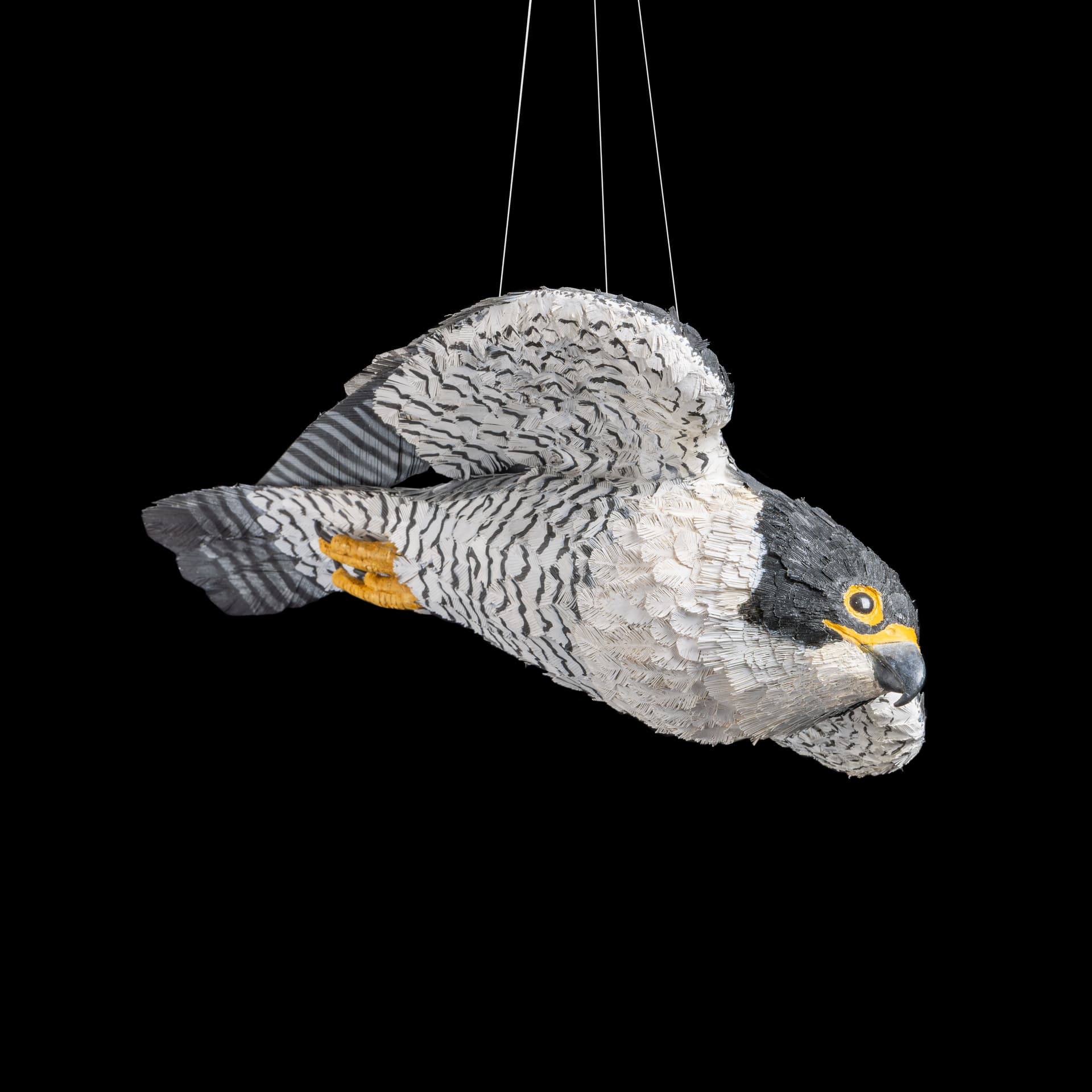

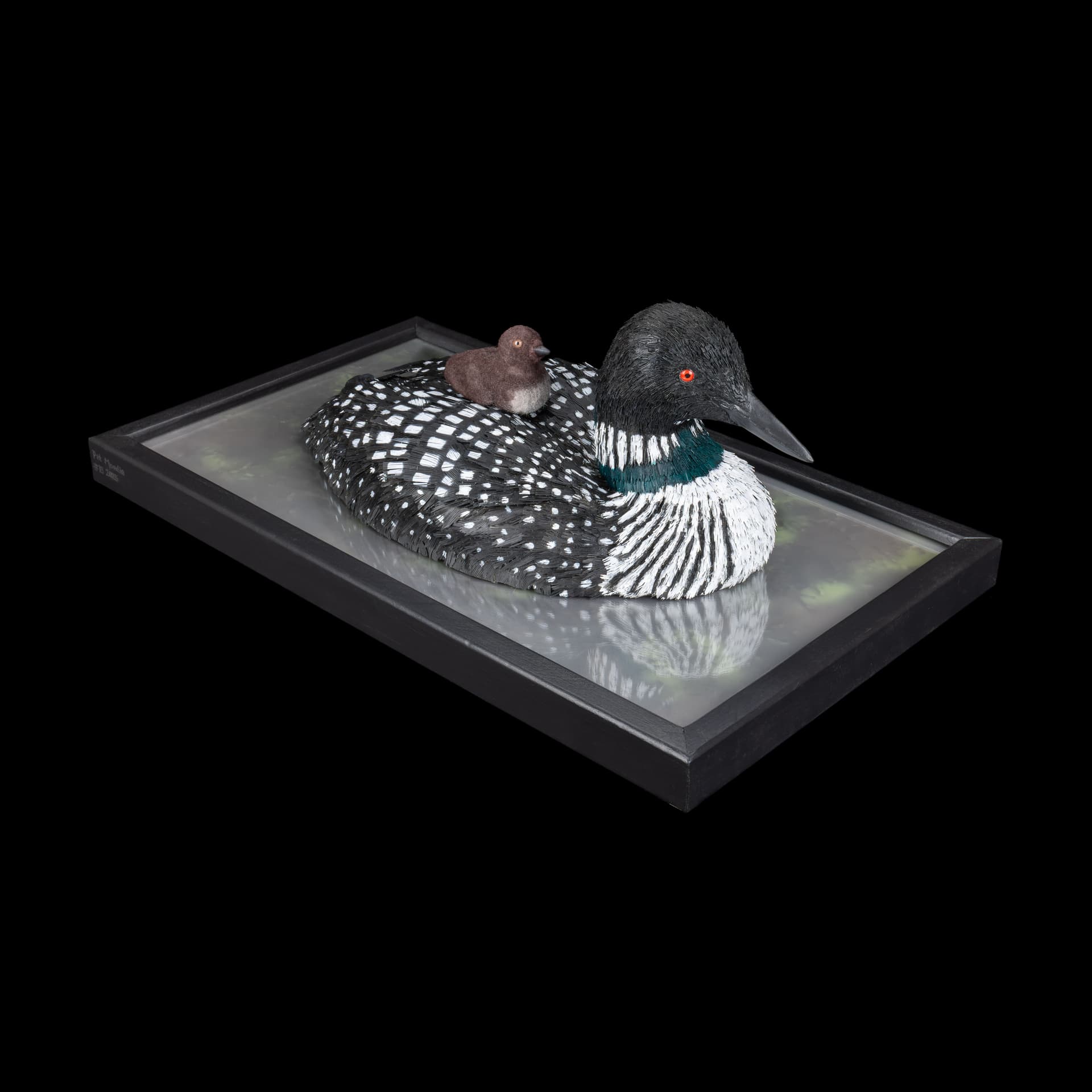

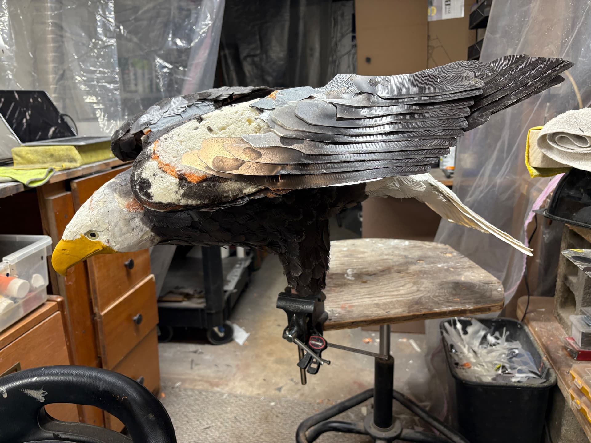

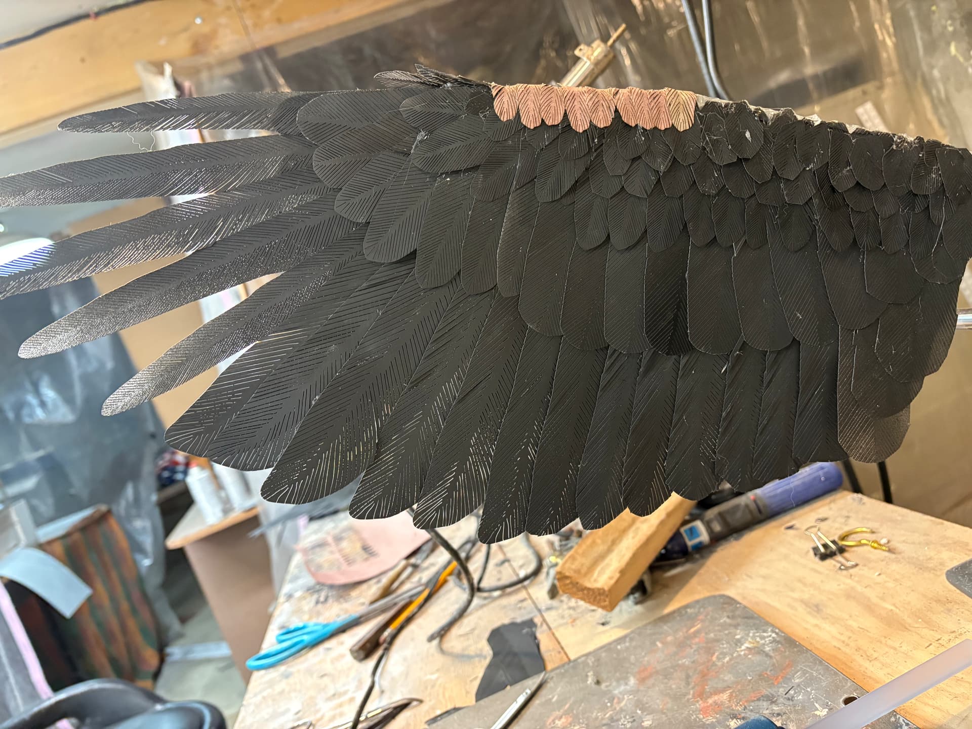

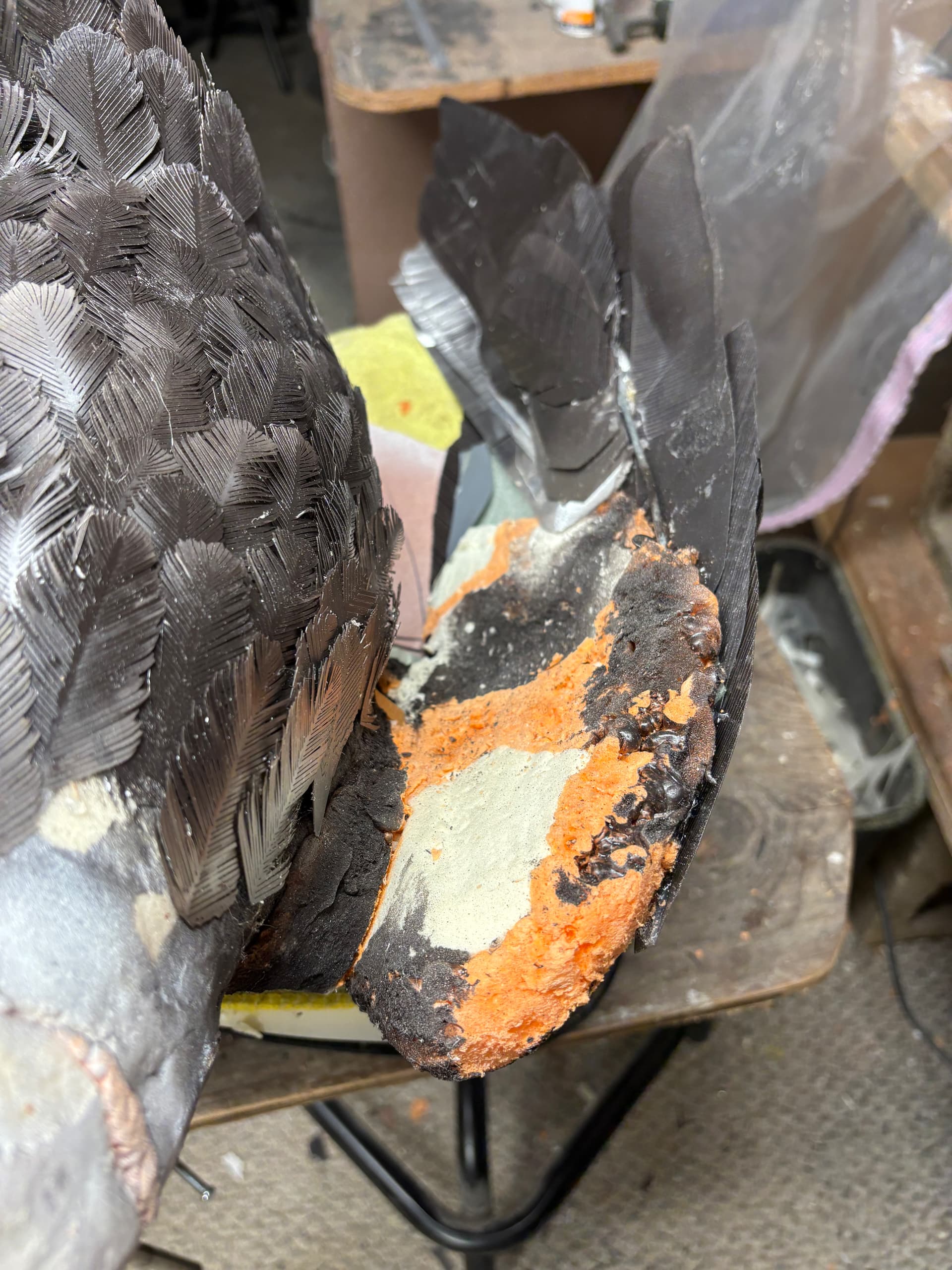

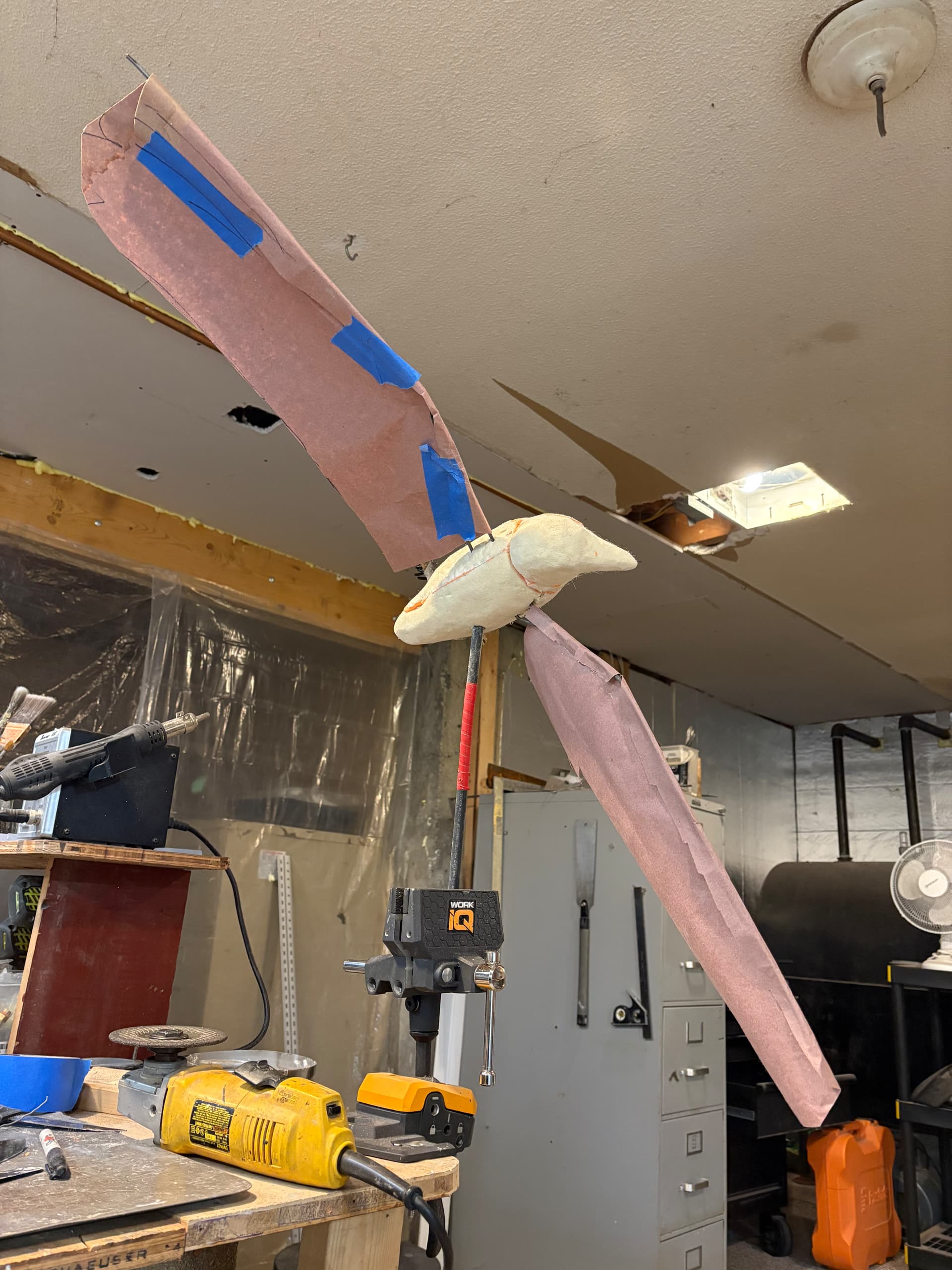

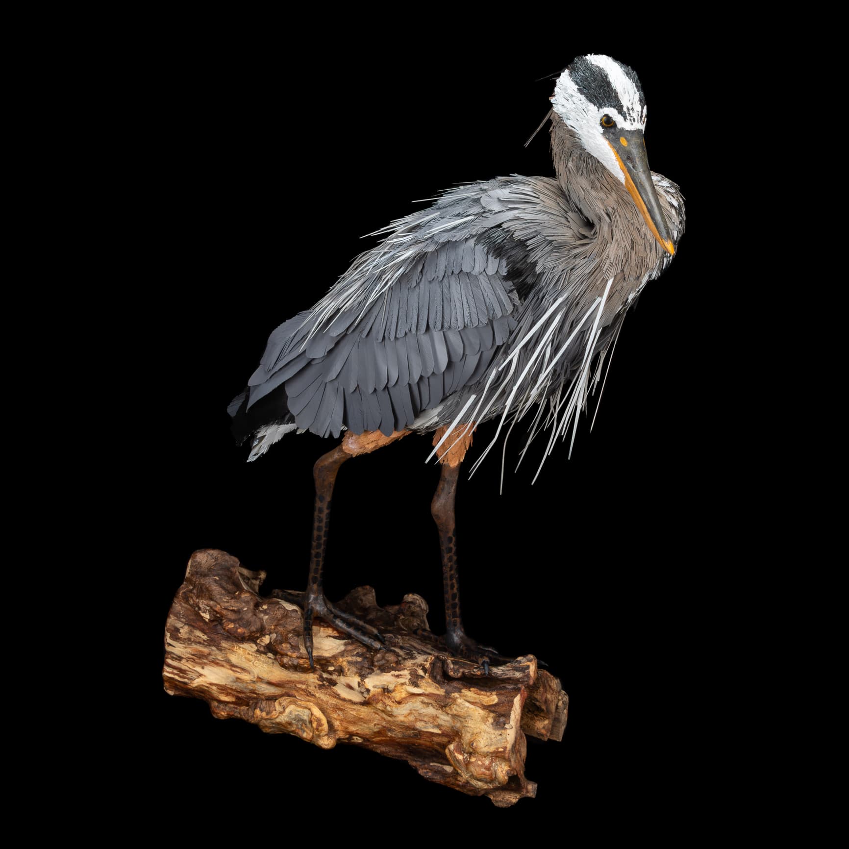

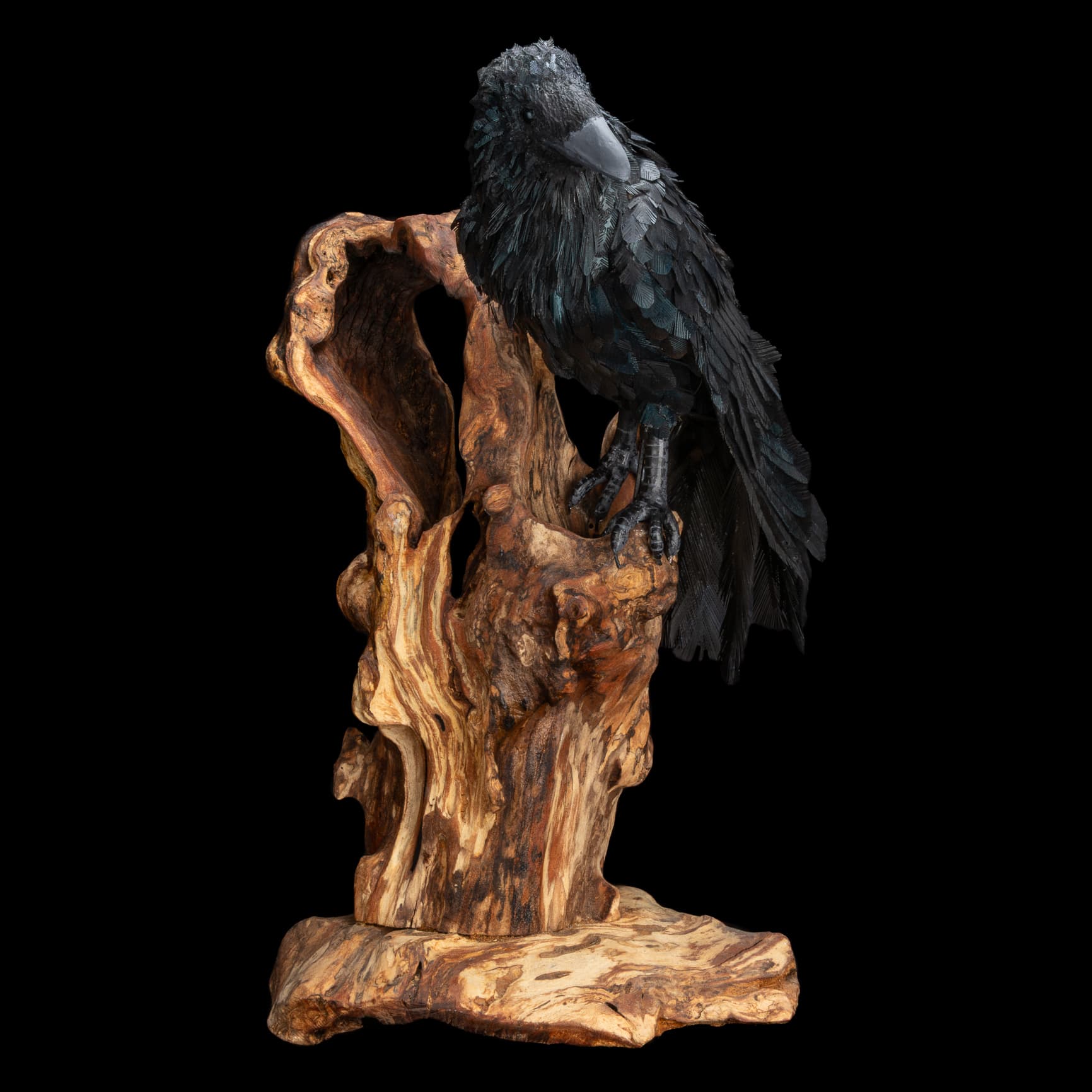

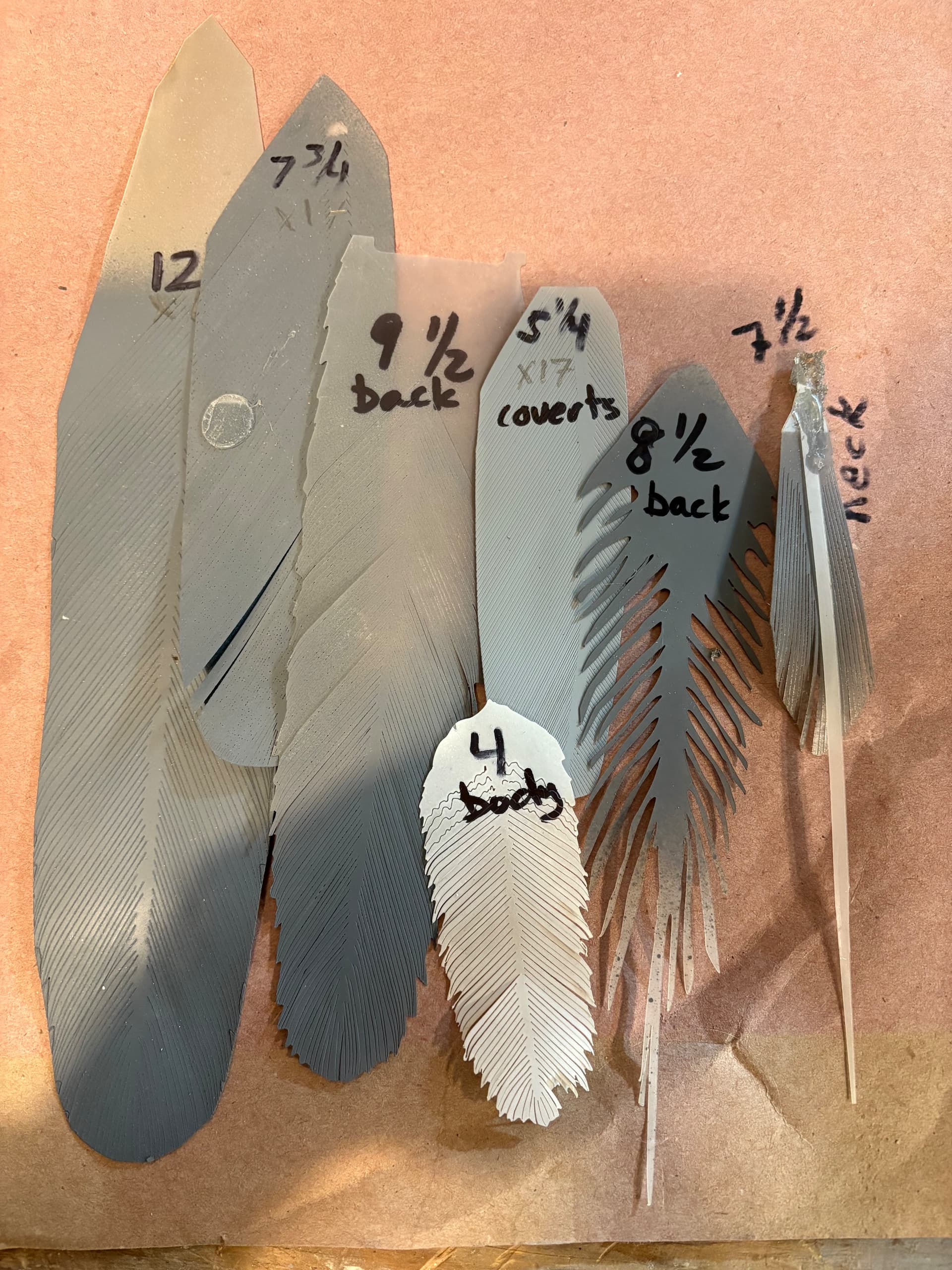

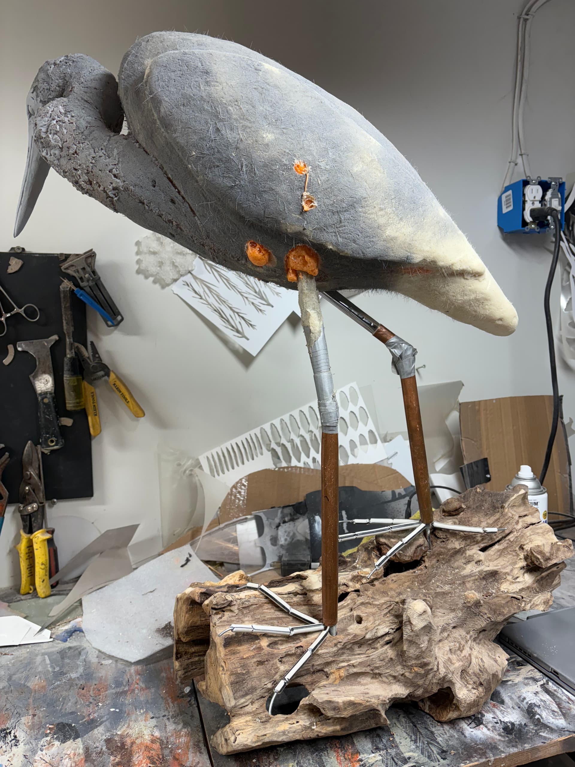

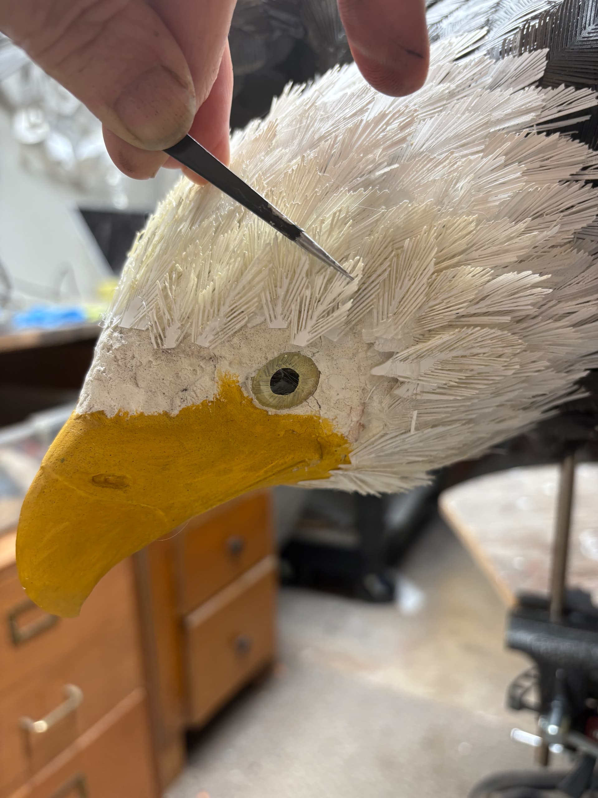

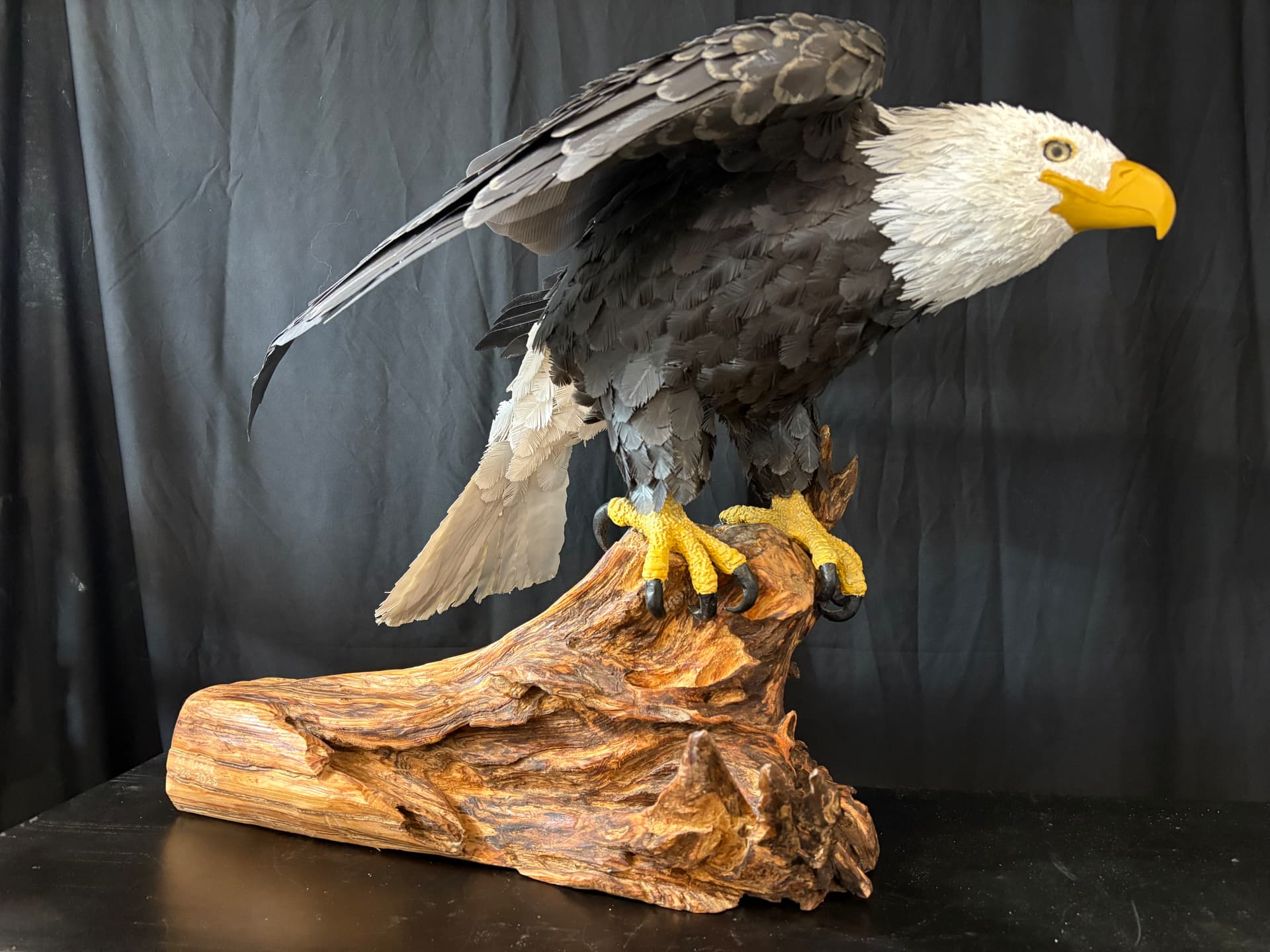

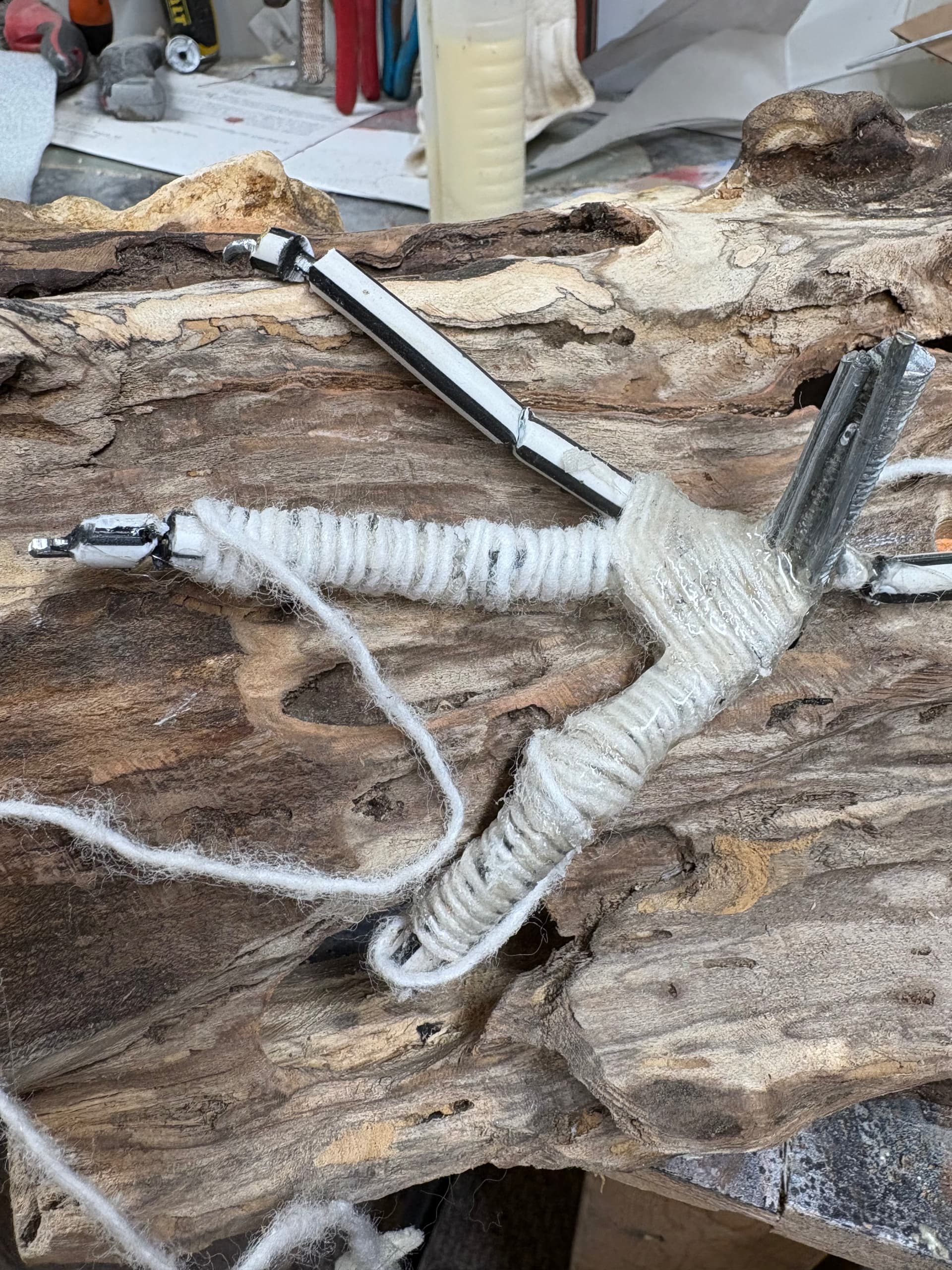

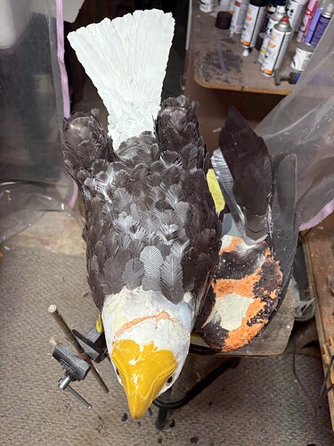

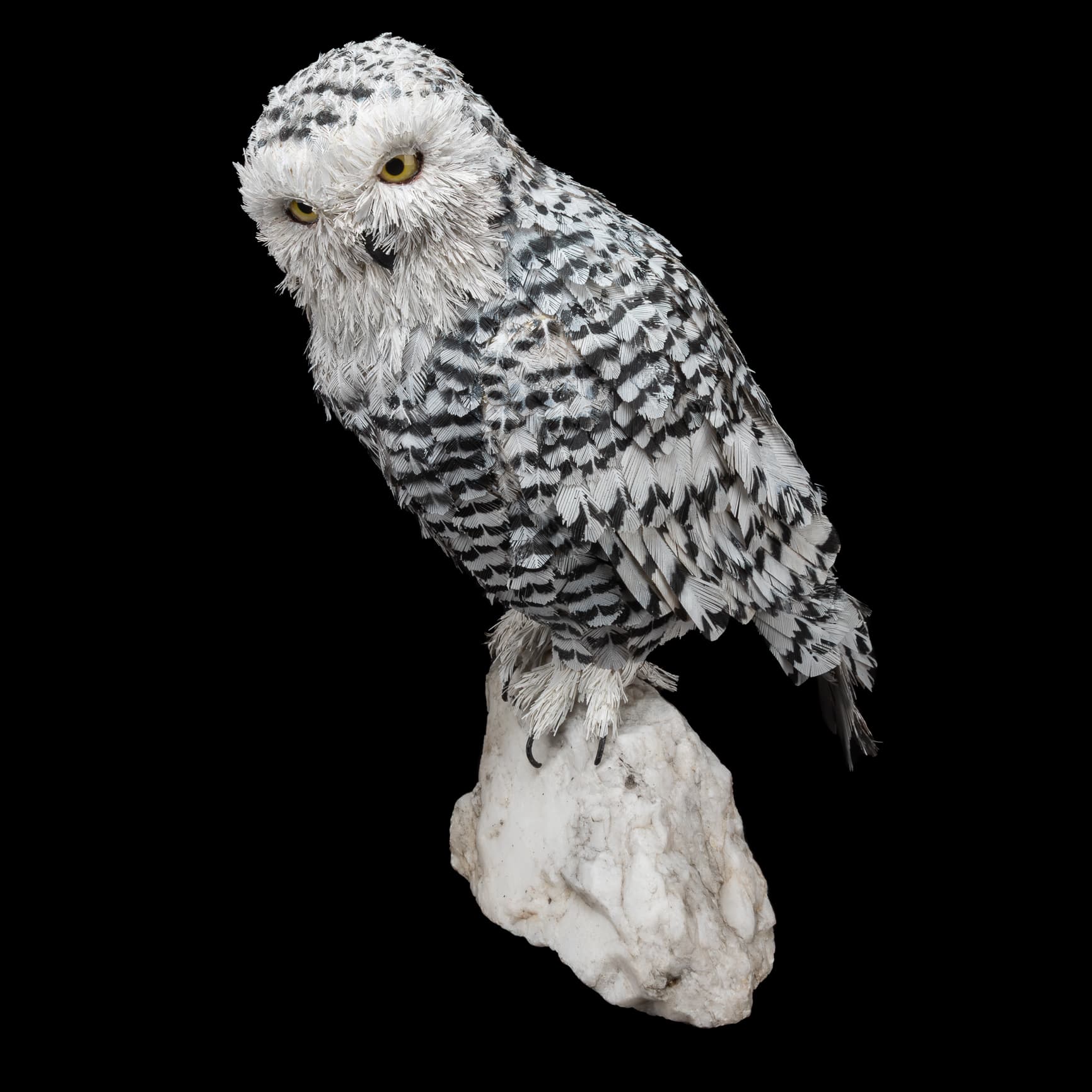

With all my projects I try to use only recycled, used, trashed, or otherwise discarded stuff. The birds are primarily made from plastic sheets found inside TV and monitor screens and rigid foam insulation used in walls and ceilings. I design the feathers and cut them on the Glowforge. (The material is safe to cut. I have been using it for years. I vent outside) They are then shaped with a small heat gun, painted and then glued on the body (foam). For a while I was counting the feathers and the Snowy Owl had 1006. Probably 500 of them were on the face! Here are a few of my latest birds with some ugly in process pictures. Have fun deciphering what’s going on. I have an instagram account for more background: thinking_out_of_context

A lot of false starts and the beauty of the foam is I can just carve it some more, or glue more foam where needed, or cut off the head to reposition it!

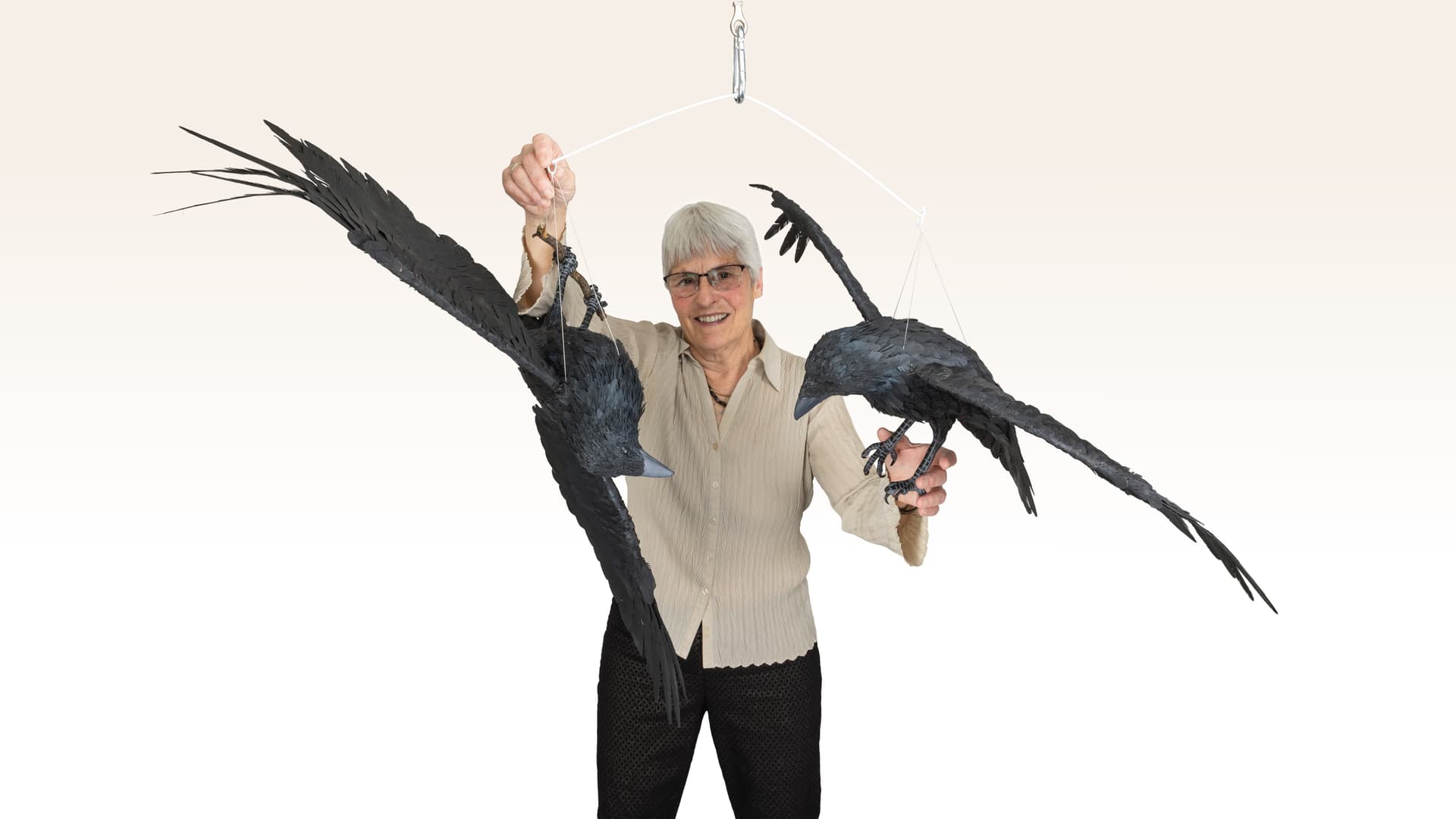

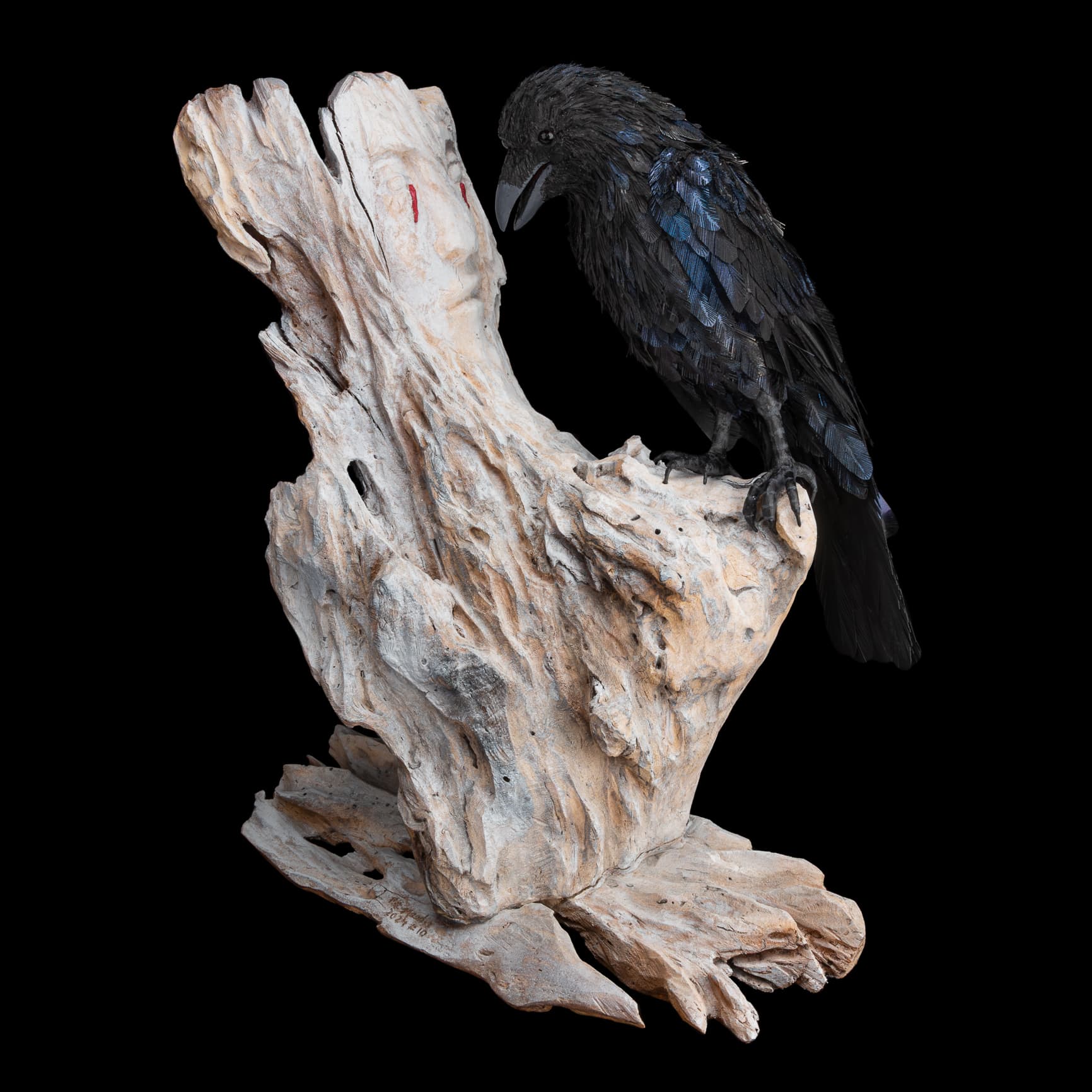

I had a lot of fun with the ravens. For the hanging ones it was a challenge to figure out how to get it just right. The one with the white wood face, that’s the Three Eyed Raven and Weeping Tree from Game of Thrones.

Thank you! They are time consuming, about 150-180 hours, but I am getting faster as I learn more about how wings work!

Reusing materials is the challenge. Wouldn’t be nearly as much fun if I just bought everything I needed. I love the ravens, too. It’s fun to see if I can get a personality out of them.
