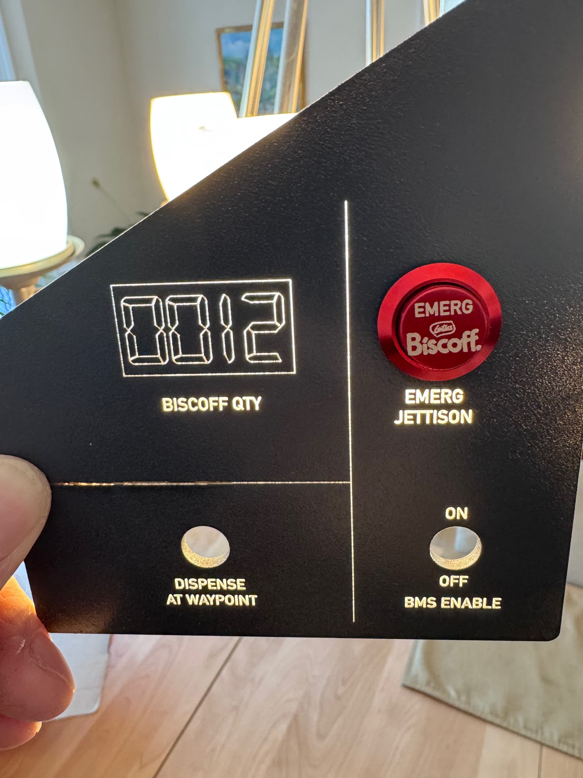

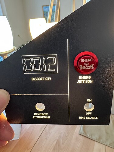

As I have gotten so efficient in making backlit instrument panels for the A320 Sim-Pit and the whole sim is nearing a fairly complete state, it is time to add the fun panels. I was talking with my son the other day after he had just been operating, normally he flies under the United airlines livery but that day had been flying under Delta’s Livery which means Biscoff Sandwich cookies, which are his favorite. We joked that they are on the MEL (Minimum Equipment List, the legal minimum equipment a plane may dispatch with), which led to the rabbit hole of the BMS Panel (Biscoff Management Panel) which will replace one of the cockpit lighting control panels on the Main Instrument Panel. It is controlled via an Adafruit Feather with a 7-segment LED Backpack (hasn’t shipped hence the fake LED display). The button is an aerospace grade pushbutton (helpfully anodized) which I 3D printed a custom holder to allow it to be engraved without the crumb tray. When the dispenser dispenses, it also plays the Biscoff Theme and the Y’all ready for this from Space Jam. I haven’t installed it in the Main Instrument Panel so this is just held up to a lamp. Now if I can (this is more of a learning experience in programming via the API into MSFS) I’d love to throw an ECAM warning when the cookie level gets low in the dispenser… Even funnier would be to send an ACARS message from the plane to dispatch to request emergency replenishment.

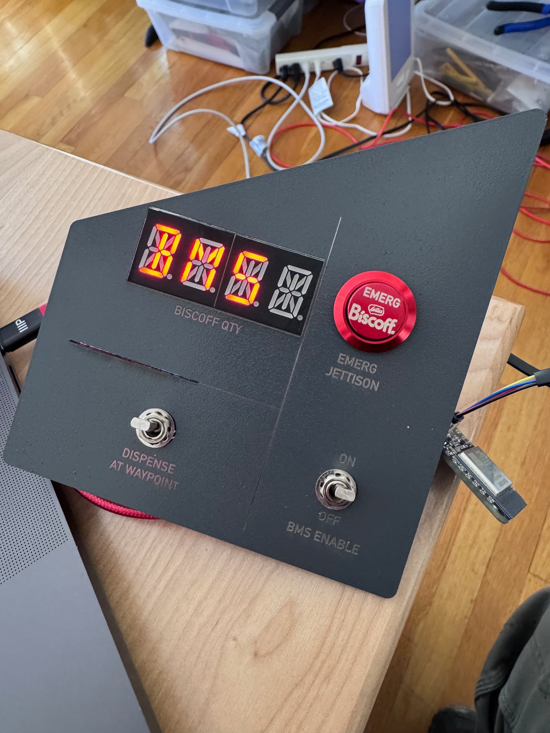

Startup sequence, need to add the button and microswitch from the dispenser, also needs a rotary encoder to set the number of biscoffs in the hopper tube (you know in case they swell with altitude?). And yes, before someone mentions is I will be putting the filter over the LEDs to make them legible in light, but this is not the final panel anyway (this is Boeing gray not airbus RAL 5014 gray-blue) but I have learned, don’t even think of working on the final panel before wiring/programming is done or you will regret not having a screw hole or something…
