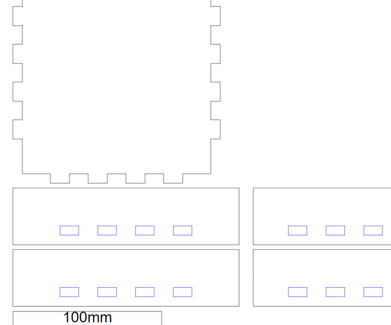

I’ve enjoyed using https://festi.info/boxes.py/ to generate various boxes in the past. However, I am making a dice rolling tray for my friend (current draft:
I was wondering if anyone knows of a way to change the settings so that the holes are in the bottom piece and the fingers are on the side pieces, instead of the other way around? Or if there is a different program that can do so?
Thank you for your time!

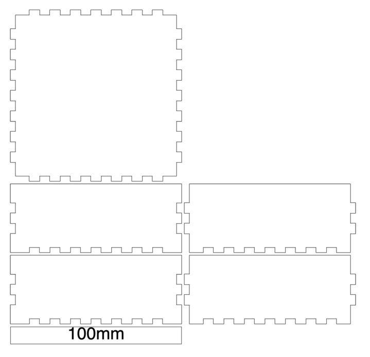

You can also just pick a different box style on boxes.py, for example, the “closed box,” set all the measurements to what you want, then load the svg into your editing program, like Inkscape, and make the upper edges into a straight edge and get rid of the panel meant for the top. Play around with it until you get what you want.

Like this?
That site also did not have it as an option, thank you though. There is no top in a rolling tray, so I’m a bit confused, but sounds like i’ll just have to learn inkscape
If the holes are in the bottom they will have to be inset some so as not to break or on the edge like the one above.
Correct, this is like what I meant:
(I just poorly edited that in paint to show what I was trying to say)
That’s why I was wondering if there was a generator that made it as the option like how the first does it for the sides. ^^; It seems I’ll probably have to learn the inkscape software, I was just hoping for a shortcut to crank it out in time for a birthday present.

You the two piece box and ignore the base.
https://festi.info/boxes.py/TwoPiece?FingerJoint_angle=90.0&FingerJoint_style=rectangular&FingerJoint_surroundingspaces=2.0&FingerJoint_edge_width=1.0&FingerJoint_finger=2.0&FingerJoint_play=0.0&FingerJoint_space=2.0&FingerJoint_width=1.0&x=100.0&y=100.0&h=40.0&hi=0.0&outside=0&outside=1&play=0.05&thickness=3.0&format=svg&tabs=0.0&debug=0&reference=100&burn=0.1&render=0
Unfortunately with the two piece box, it’s the base that has the bottom holes, so it would have an edge around it where the lid would fit
I’m dumb, I now realize the issue and what I can do/limitations. Thanks!
