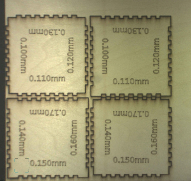

Is anyone using boxes.py seeing the burn test having everything thight as long as it is on the grain side and everything loose when it is against the grain ?
For me I have the problem, is it because I repositioned the squares so they take less space on the sheet ?
I was never able to get their tests to work successfully - either things not actually sized the way they said they were, or something in the import process changed them…so it may not be you!
