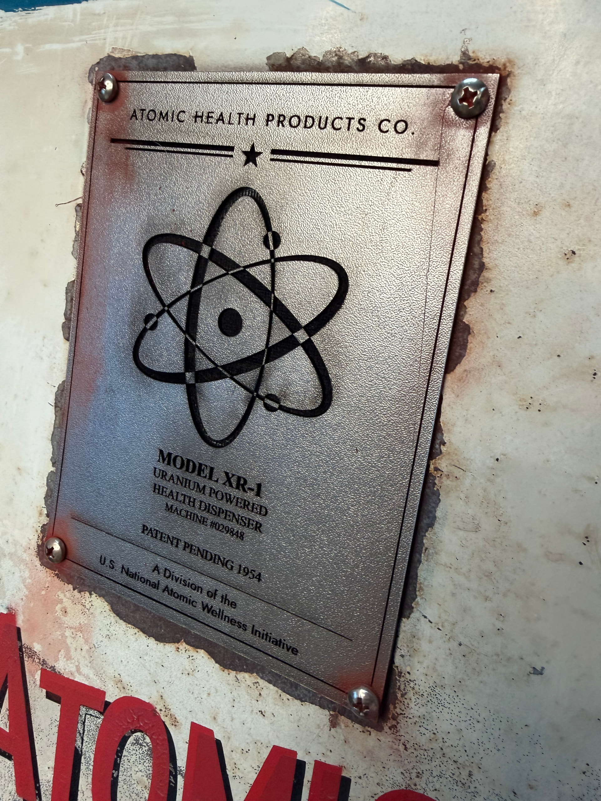

worked like a charm! thanks everyone
This is great.
Which material did you end up using?
the textured nickel:
i also bought brushed nickel but haveny tried that yet, its super shiny
How about settings and which model Glowforge you have?
I have the aura.
The cut was 10 power 10 speed 2 passes
engrave was probably a bit too high:
100 speed, 10 power, 270 lines
it went really deep

It was the textured nickel on this page:
If anyone wants to see the full finished product:
