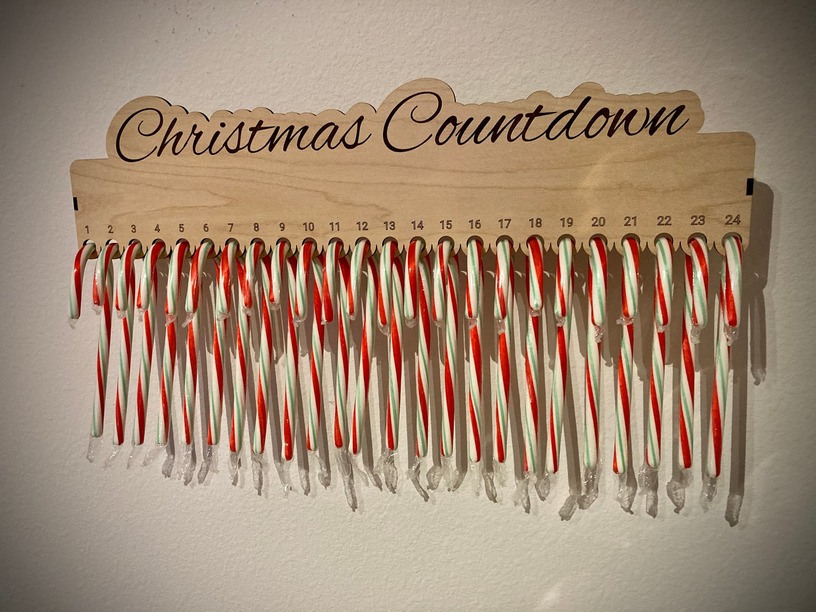

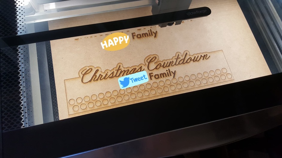

I put a row of 24 quarter inch holes (my best estimation of what a standard candy cane diameter is) for each child in the sibling pair, and then offset the holes so that the candy canes wouldn’t be competing with one another for space. In addition, I let The Small One have a say that, “Rectangles are boring,” and she wanted the top to be, “Bouncy.” So I used Inkscape and did an outside offset of the top text, 10 times (10x). In case you wanted to recreate this yourself with different top text or a different font, I’m giving you all the tools to do it!
The font was chosen by The Big One who said, “Christmas is really old. Make it an old font like cursive.” I was looking more at calligraphic fonts, but if she believes cursive is appropriate to the Christmas spirit, I’ll give it to her.
Under that we put the family’s name in sans-serif because I honestly couldn’t find a more decorative font that paired well with the cursive chosen for the top.

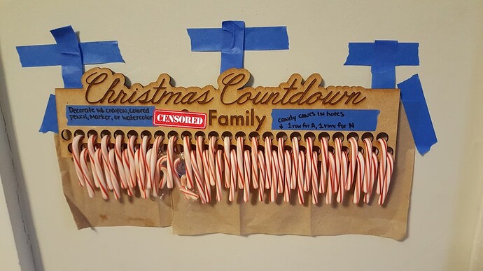

And then it was off to the Glowforge to engrave and cut. I used medium draftboard because it is a prototype. And also because it is a prototype I hadn’t given any thought to how to hang it but my friend/their Mom figured something out with painter’s tape as shown. Also, because it is a prototype, I hadn’t given any thought to how difficult it would be to put candy canes into the top row (mini candy canes are shown in the image, still untested with full sized ones) but I discovered that rather than approaching the candy canes from the front side of the countdown on the short side of the hook, if you thread them through from the back side of the count down with the long side of the candy cane, they go in rather smoothly to that top row. The bottom row doesn’t require any tricks to get to hook it.

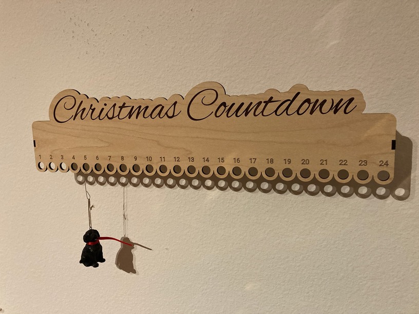

I tried recreating a version using Cuttle. The could not get the alternating row to be centered. So in the case of multiple children, I thought you can just make two or more! Additionally you could choose different “flavors” for each child.
Here is an SVG sized for 3mm material.
Christmas Countdown - layout
I haven’t cut this one. Use at your own risk.
I also guessed at the dimensions, but it should be easy enough to modify in Cuttle.

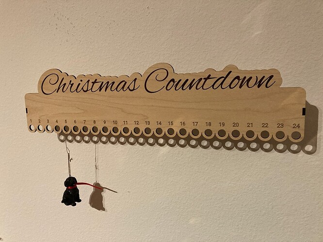

So, I went ahead and printed it out anyway.
I didn’t have any candy canes, so a labrador ornament is standing in.
A few notes…

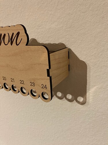

  • I underestimated the size of a pan head screw, and had to use a small nail for demo purposes.
  • I am concerned with the spacing from the wall and the strength of the bracket. Small children my try to yank off a candy cane.

The mount still seems to fragile. I would make it larger and or double the material thickness.
