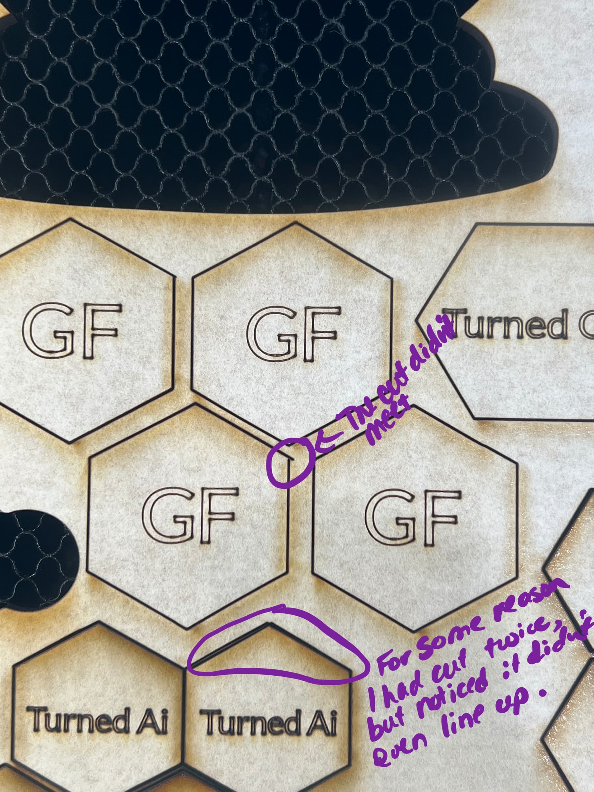

Catan edges not lining up. Has this happened to anyone else?

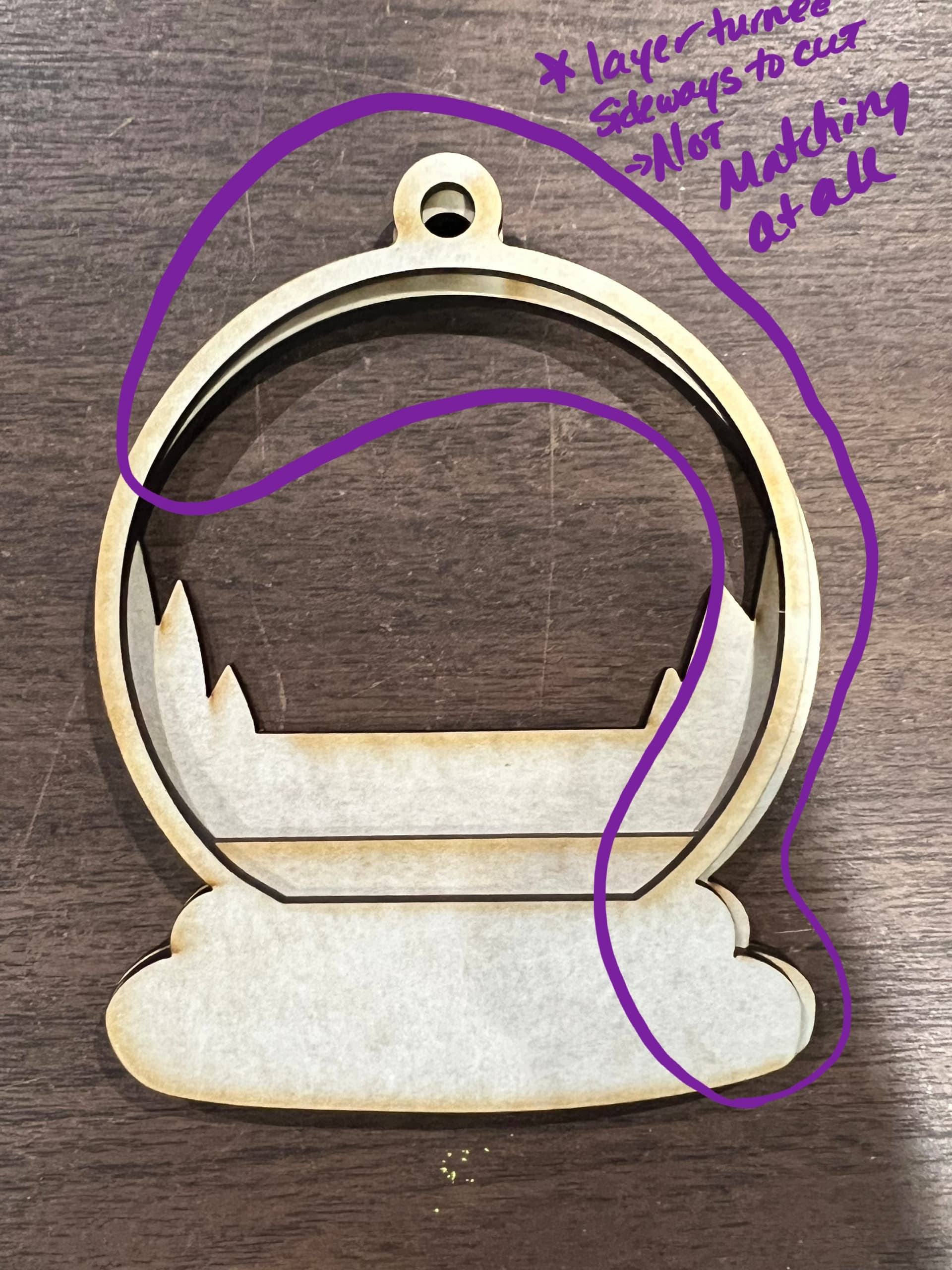

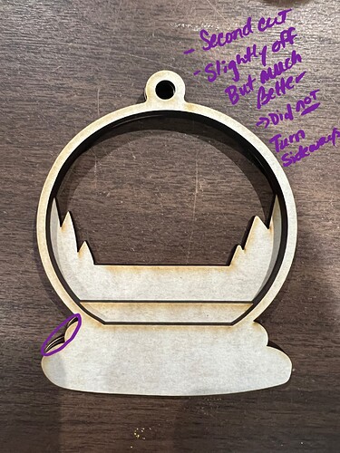

I went back and tried to print the Glowforge Snowglobe Family ornament and the top layer I turned sideways the first pass … it cut completely distorted! (I was SO careful to only move the handle to turn the object and didn’t resize anything. Then I reset everything and cut that top layer without moving it. It seems to match up almost perfectly.
The next thing was to try to just create a hexagon in Glowforge, not move anything, copy paste and print. It looks like one side doesn’t line up on one piece. Then when I would them together even the piece I didn’t turn was wonky. I imported a quick svg with hexagons I made in Illustrator… (realized after the fast that I had two lines to cut… but, that mistake showed me something else)… that second cut didn’t line up over the first on one of the pieces.
I keep wondering second guessing myself and double checking every single thing I am doing… Is there a way to measure the angle within the glowforge app right before clicking the print button? I don’t think so.
Hexagons made in GF and AI

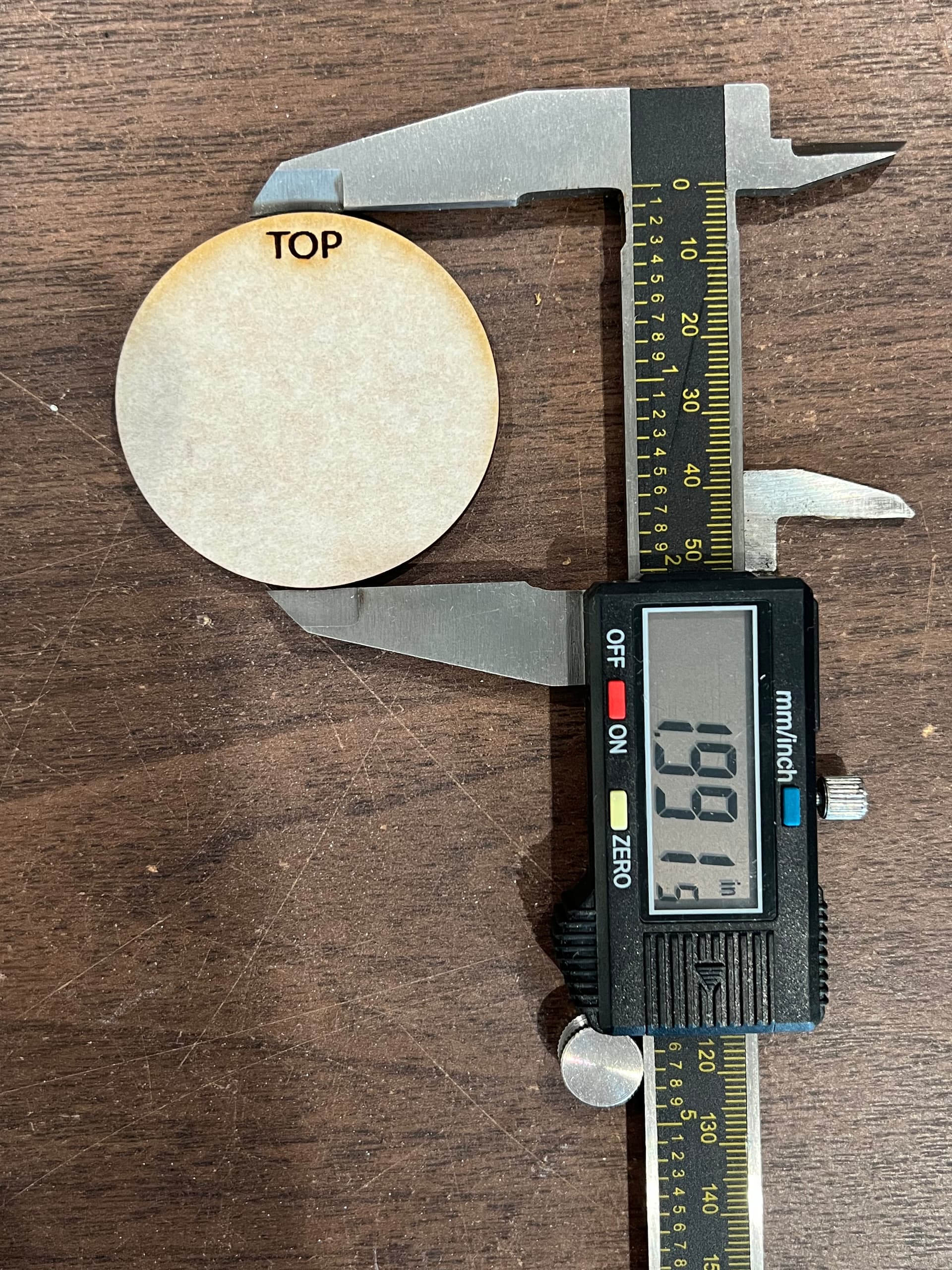

Those off curves make me wonder if rather than a squaring issue you’ve got slipping teeth. When you cleaned them, did you take a good look and make sure none were missing/cracked? Especially if it’s going quickly, there’s a lot of pressure on those teeth!

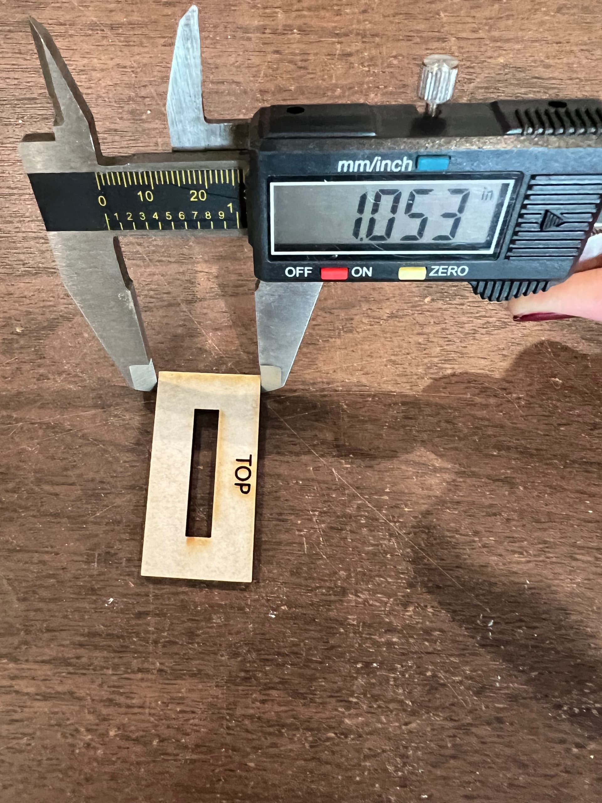

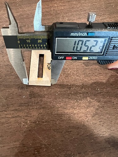

Well… I think I am at a loss. My machine is out of warranty even though it doesn’t have a lot of use on it. Support hasn’t been able to help. The new carriage plate wasn’t the issue. I went through a couple of tests after squaring the arm once again. Support says that I can send the pro back in and pay the $1,500 for a refurbished machine. I just don’t see the point in doing that.
If anyone has any other ideas I would be open! I’ll check the belts again and see if there is anything at all broken. I have a brand new belt with the carriage plate. I’ll inspect the side belts thoroughly.
It does seem like the laser head catches a bit when sliding back and forth…I have to go very gently to feel it, but it’s there. If I loosen the belt a lot I don’t feel it and it goes smoothly. But, when it is tightened it is definitely there.
I’m open for any additional thoughts, otherwise I think I have a dud machine now. :cry:
These were from the test that support had me do: (It definitely seems like the circles are giving me more issues)
