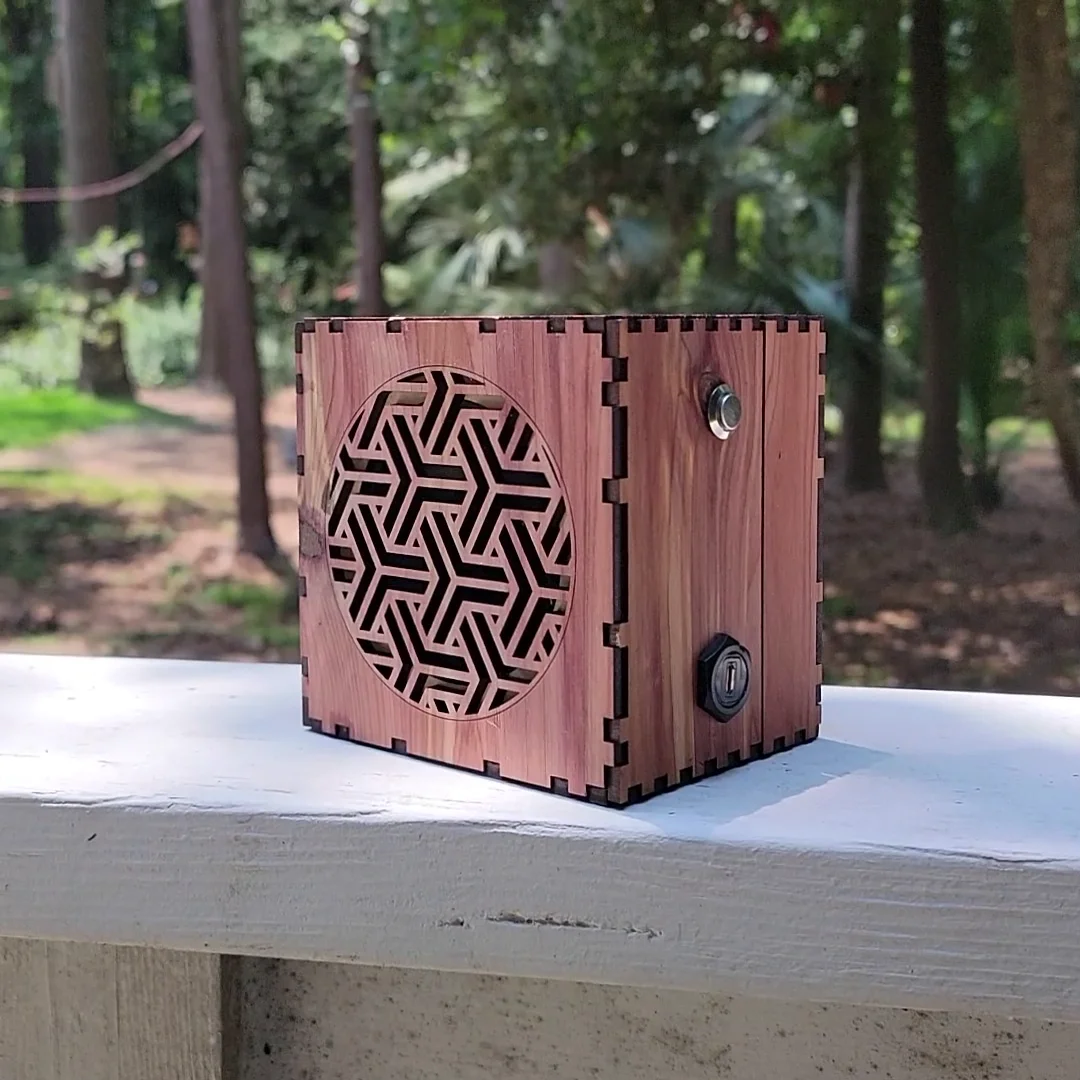

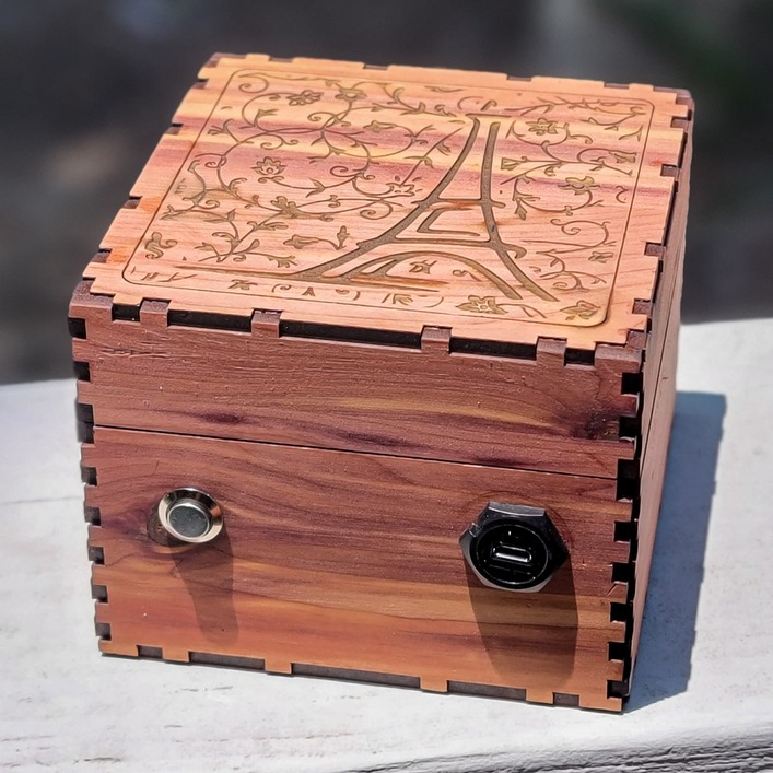

So this is a custom Cedar box with a Speaker and an electronic chip you can drop MP3 files and have them play audio with a push button. The chip came with a crappy 1.5" speaker that I replaced with a 3" Adafruit speaker that has better sound quality. The design was originally made for slightly thinner material, but I changed to cedar at the last minute, so the only part I don’t like is tabs don’t fit flush. I may sand all the edges rounded. I also added a different momentary push button and a charging port.
I made this for a friend who does therapy for a mutual acquaintance, who has dementia, and may not be around that much longer. He speaks French, and is helping my friend learn French because she is travelling to Paris next year. I called him and got him to record a few things in French for her, and put them on this sound box. Now she can press the button and always hear his voice.

Yeah this is great. The sanding trick should solve your corner issues.
You are probably all set on sanding technique and equipment [1] but if not… I’d probably start mechanically like with a Dremel or even better a belt sander to rough it out, then use a nice sanding block to get the final shape and surface dialed in.
