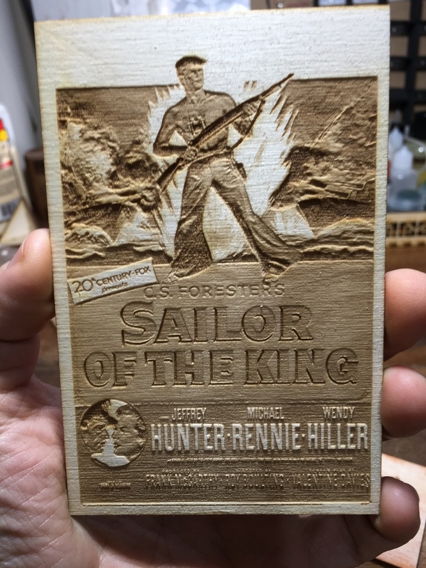

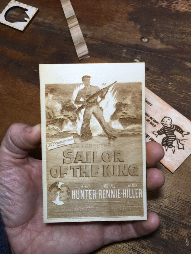

I chose one at randomish and did this:
With a sharper light angle, more detail emerges…

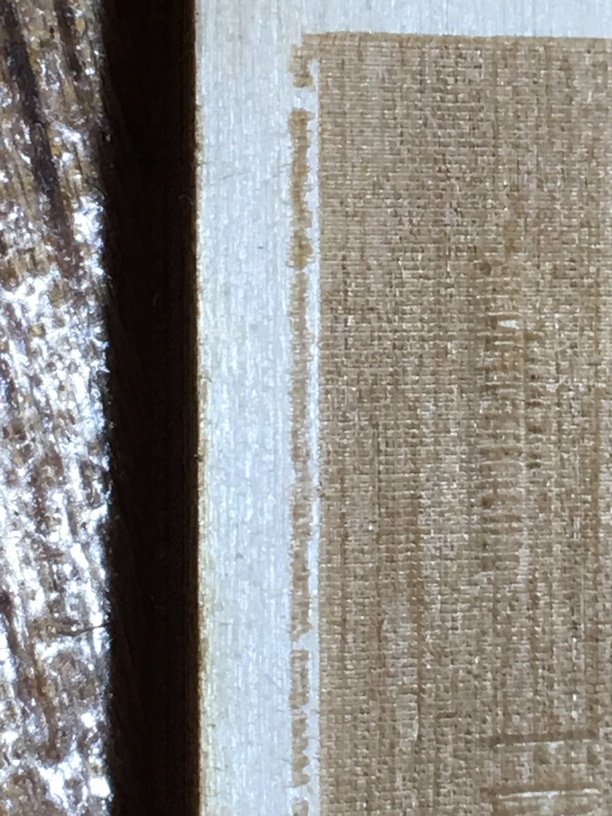

I may have pushed the size a bit small, there’s some barely illegible text here:
and here… (sorry about the rotation, in a hurry.)

Original image of the one I did, chosen largely because it had a simple-ish layout and a clear subject that has decent contrast from its background, which works well for engraves in the 6" or smaller category: CONTENTdm)

Good job. How much editing before engrave?
Not much, pretty standard workflow…
GIMP: Convert to BW, curve to set contrast and black to white points the way I wanted it, rotate 90 degrees to make the engrave time somewhat shorter, export to png.
Inkscape: Import png, set scale the way I wanted it, draw cut rectangle around image. Save to svg.
UI: Import SVG. Set engrave settings to 700/70 (birch ply), default LPI, convert greys to power. Cut 220/full (pro). GO!
