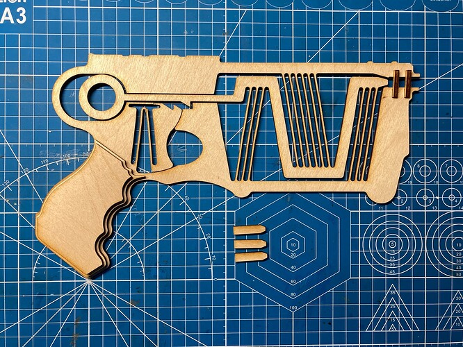

It broke after the third firing. A few things to note, I was able to get the grain at the perfect andle and I might have used wood that was too thin (3mm baltic birch).

Awesome, I think you just have too much travel on the trigger, reduce the catch and put a stopper for trigger travel should get you there.
These projects are fun because you can print just the trigger area until you get the design tuned in.
