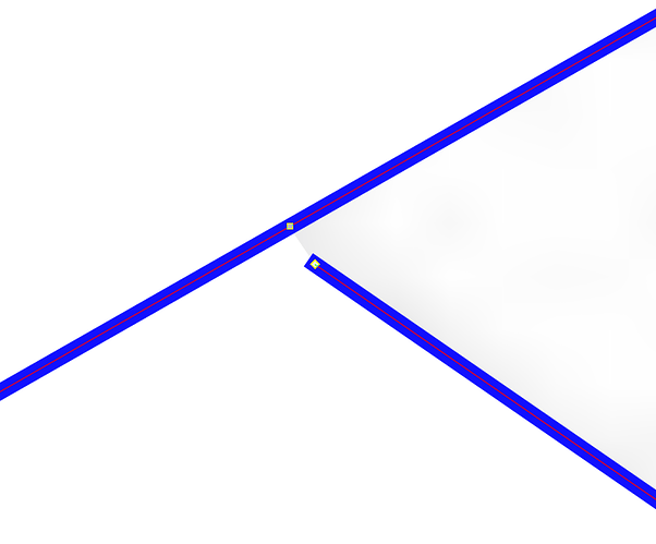

Ive tried to connect two nodes together by selecting both with a select box around them, Pressing shift and both nodes then hit connect but they still will not connect. Any advice on what I doing wrong, The whole picture has been converted to path.

The nodes have to be on top of each other - when you move one over the other, it will say “cusp node to cusp node” - when you release, and select them, they will disappear because they are perfectly aligned, then you can join them. Obviously, they have to be part of the same path - combine if not.

To be 100% accurate if the nodes are from two different paths they will get joined and the two paths will be merged automatically. You don’t need to combine them first.
That you do need to be sure of is that the two nodes are end points. You can’t join nodes that aren’t “loose ends”.

Okay you’ll have to break up the top line because both need to be ends.

is there not a way to connect more that 2 end nodes to one point? I broke the one line so now I have three end nodes but when I tried to connect them it connected only two of them
No, because they have to both be part of the same object. An open path can only have two ends.
This is what you can do though and in the end is more logical. Close each of your two paths and then run the boolean called union in Inkscape. You will find that under the path menu.
OK technically this is correct, but it’s not what I’m referring to. What these buttons do is remove a segment between two nodes. What you want are the two buttons to their immediate left, which join two nodes of break a path at a single node.
