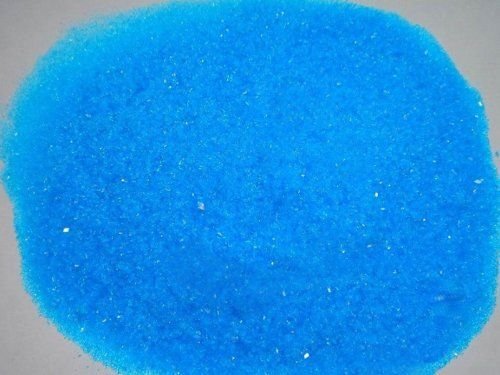

Although he uses Ferric Chloride in the video, the same methods apply.for elecroetching.
Aluminum just uses vinegar and Salt for the electrolyte.
Brass uses Copper sulfate as an electrolyte. I’m looking for a local source for "Root Kill"
http://steampunkworkshop.com/electroetch-shtml/
It is available cheap on Amazon $6 a pound with Prime
