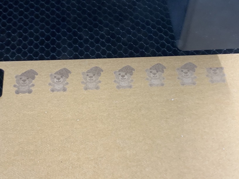

Doing a logo for my daughters beanies and I added the first one on the left. Then copied and pasted the remaining ones. Why would the get lighter and lighter as it moved down the line of logos. Using Kraft Tex fabric. image|666x500
Material not flat on bed, or tray not seated correctly in base of machine. Possibly optics not clean - which can happen, even if new.
If not that, it’s a beam alignment issue that would require replacing the machine.
