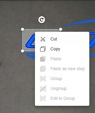

It would be awesome if we had an option on this context menu for “Copy Position” and the ability to “Move Back” to that position.

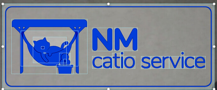

Often I have to move pieces of a design to clean up items that I don’t want in the final output. For example, in this image I’ll eliminate the cat nose and the vertical triangle in the plant. However, both of those items are underneath other pieces so I can’t simply mouse over to grab them. So I would need to grab the cat, move it, delete the nose, then move the cat back. Today I write those XY coordinates down and then manually plug them in to move the piece back to its original location.
It would be so handy to copy location, move it, perform my underlying image changes and then, click the object I moved and choose ‘move back’
