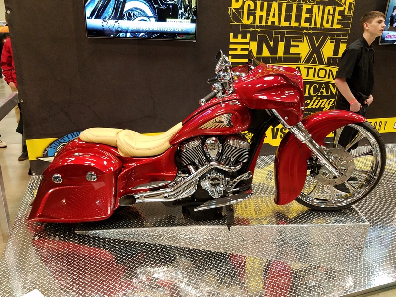

I really don’t need the background. I only want my bike. I am trying to design a brochure/post card. I want to put my contact information on the back side.
I can use photoshop and remove the background giving me a clean image of just the bike. I don’t know how to create a file that will engrave the bike and cut out the outline of the bike.
Perfect, the easiest thing then would be to make a duplicate of your clean no background bike image, fill in the entire bike with black or some other solid color. Import that into Inkscape to “trace bitmap” to get the vector cutline, set that to a stroke color with no fill. Then import your clean bike image into same document, line up with the cut line and then export both of those together as one SVG or PDF.
