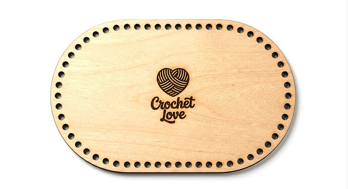

Do any Glowforge creators have a template for crochet basket bases and handbag bases?
Being able to input size and shape? Popular shapes are circles, ovals and squares.
It’s pretty simple to find basic shape templates that you can scale to be whatever you need.
Is there something more complex about them? Do you have a link to something like what you’re trying to make?
It is 4 inches and the inner circles are about 5/8 inch.

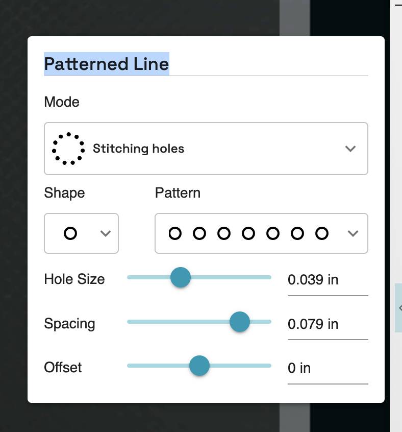

If you have the premium tools it is quite easy to create these. Simply select the template for Patterned Line. Choose the hole size and spacing that works for your project.

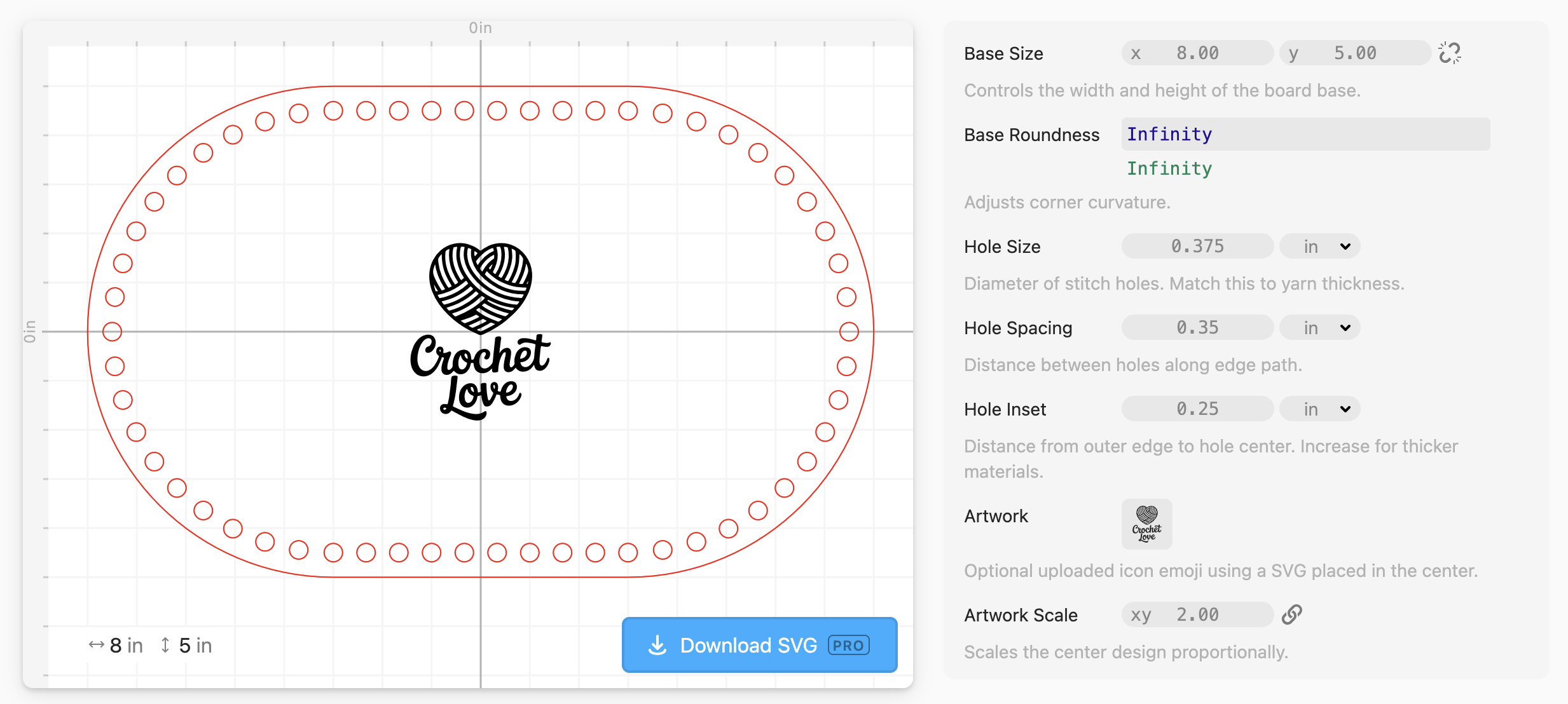

Do you have a Cuttle subscription? I made a parametric (you can enter the dimensions) one that allows you to type in the size and spacing for the holes.
