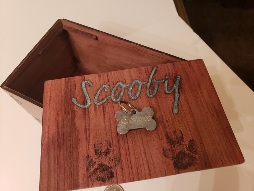

An employee that I work with dog died (18 years old) and she had it cremated. Wanted me to make a box for her to put the ashes in. Not really sure of the type of wood, but the darker wood is wenge. The paw prints are engraved from an ink paw print they took before he died. His dog tag i used to make the handle on top of the lid. The lid and the base are slightly recessed. The name on top is epoxy filled with a silvery blue tint. (Which matches a bandanna that her dog wore that shes going to tie around the box).

Nice! How did you achieve the coloring in the name?
Mica Power in epoxy resin. I mixed pearl white and a little bit of cobalt blue.

How did you get the resin in without it overflowing? I have trouble with just paint getting under the tape.

Hi! With the resin, i found a little trick a while back that i use for all small areas. I use a small syringe and just slowly lay the resin in with that. I make sure to slightly over fill it and then sand it back down to the wood level.
Before that though, I brush on a layer of sanding sealer to make sure none of the resin soaks into the wood, discoloring the edges. This makes for a sharper looking line/edge.
