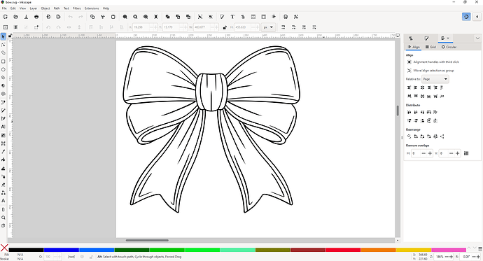

Good Evening,
I have a SVG file I uploaded into Glowforge that I want to cut. However, the Glowforge cuts the file into individual pieces. How do I get the Glowforge to cut the graphic as a whole file instead of separating it when it cuts it? When I take it off of the tray, each piece is individual.
Any help, guidance would be appreciated.
Thanks.
You will need to share a picture of the file so we can see where the cuts are. Perhaps you are supposed to score rather than cut some of the parts.

Attached are the files I am trying to cut. I did try the score and then cut, but it did the same thing. I also set my cut and score features to - 10 | 10 | 2 passes. Let me know. Thanks. Michele

These files are not laser files. The solid lines are going to get cut and that means a whole bunch of parts and no whole. It is possible that you can engrave the lines, but then you will have no outlines cut.

All of these files are laserable, but they require some extra work. I’ll take you through the process and then put the modified files at the bottom for you.
I’m going to assume that what you mean in all of this is that you’d like to engrave the pictures and then cut the outlines, so that you have a standalone bear, bow, or elephant.
The processes for doing this are similar, but the three files are of different types – the elephant is a jpeg, and the bow and bear are SVGs. These are what we call raster and vector, respectively.
Let’s also introduce you to Inkscape, a free vector editor that I’ll be using to do all of this. Almost every vector editor does similar things, so if you see something I am doing here, but are more comfortable or familiar with a different editor, it’s probably just a matter of figuring out what that program calls the functions in question.
Let’s talk about the bow first.
When you get a new file like this it’s a good idea to inspect it to see what you are working with. I opened bow and see this:
The first thing I do is right-click on the bow and select Object properties to see what type of object it is.
On the right side, we can see that it’s a single “Path”. This is good news, paths are easy to work with.
Inspecting the path and preparing it for engraving, I am looking for a few things: The path should be filled with a color, and have no stroke assigned. In the lower left you can see that it says Fill and Stroke are both “none”, so we should assign a fill color. I’ll choose blue just because:
Cool, the bow’s ready to go. What we need now is a cut outline. This is actually very easy to do when you have a single path to work on – we just need to isolate that outer edge. There are many ways to do this, but the simplest looks like this:
Steps to create a cut outline for the bow:
  1. Duplicate the bow. Select it and go to Edit → Duplicate.
    It’ll look like nothing changed, because it makes a copy right on top of your original bow.
  2. Path → Break Apart
    This looks like something’s really wrong, because what it just did is separate all the different segments of your bow into their own path elements (Note all the selected object boxes in the blue area), but they get a default fill color, so it looks like a solid blob.
  3. Path → Union.
    This looks similar, but you can see it’s one solid shape without a bunch of smaller shapes inside. Union essentially joins all the selected paths into one flat shape. We want to cut this outline, so…
  4. Remove the fill and turn on a (thin) stroke:
    I used a red stroke and zoomed in a bit so you can see what you’re working with.
    This reveals the original blue filled path underneath the outline you just made, perfect!
Optionally, it’s a good idea to select everything and “group” them, so you can’t misalign them going forward if you move them around.
OK, so that’s how you handle the bow.
