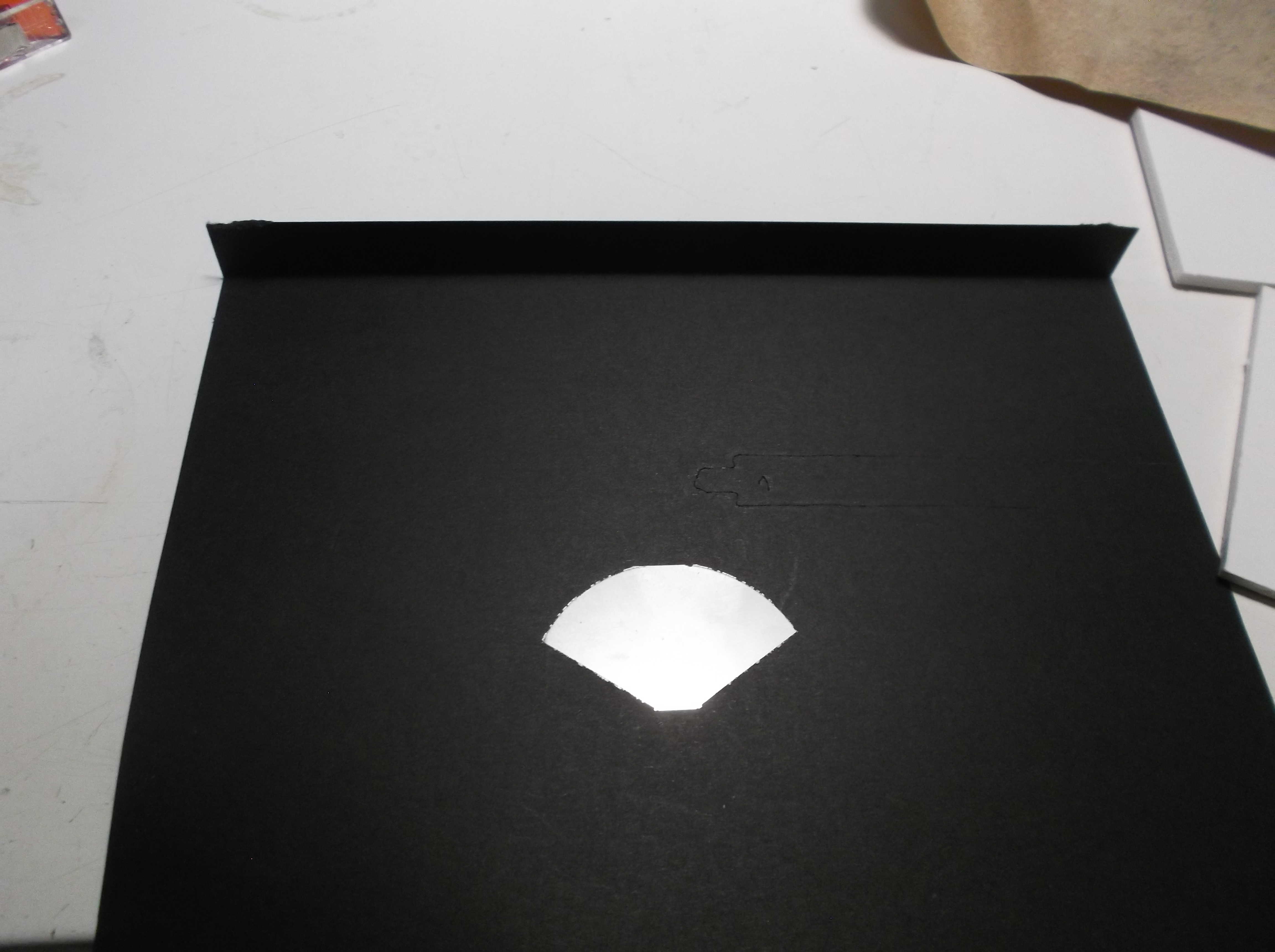

I have boxes of glass microscope slide cover clips, each is 24x50x0.17mm thick.
I need to cut them to a fan shape (guess why!). So far I’ve only tried a small diamond wheel, with the glass clamped between two layers of GF cut draftboard. I think that the vibration from the dremel just shatters the glass, so while I experiment with different rotary tools, I’d be interested in any off-the-wall suggestions.
I will be trying dripping water on the tool, and somewhere I have a diamond tipped glass engraver to scratch the outline, but I think the pressure might be too much.
Perhaps gluing it down first might be better ?

Try a glass cutter to score and then use nipper to remove excess.
You can also try a tile saw with a diamond wheel.
It probably won’t work, but 0.17mm is pretty thin, so maybe? What happens if you hit them with a (CO2) laser? I’ve often “etched” glass using my GF Pro. The mark isn’t very deep, but I’ve only ever made one pass.
I’ll give that a go. If it produces even an etched line, that line of weakness may be all I need !
Getting there. Not perfect but the rough edges will be covered by the frame lid.
Will post pic when finished(I hope!)
:upside_down_face: John

Ah! Never mind, at least I can saw it out !
