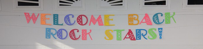

Definitely a fire concern, but I’ve done 3 layers at once. I made a jig to hold 2x 8.5 x 11 sheets in the same place, over and over, and then magnets on the edge of the sheets and in the middle of the piece cut to keep fly-away from being an issue. And then watched every cut - I think cuts were ~60 seconds, maybe a bit more, so wasn’t that painful to stand by and make sure nothing happened. Ended up cutting out ~200 letters without any issues or going crazy. For me, I think 3 was the most reliable setting - too much inconsistency in the paper to get more than 3 without cranking up the power so much I ended up with too much smoke/char on the paper.
[Edited to add in a picture of the cut pieces - I made ~15 things like this]
