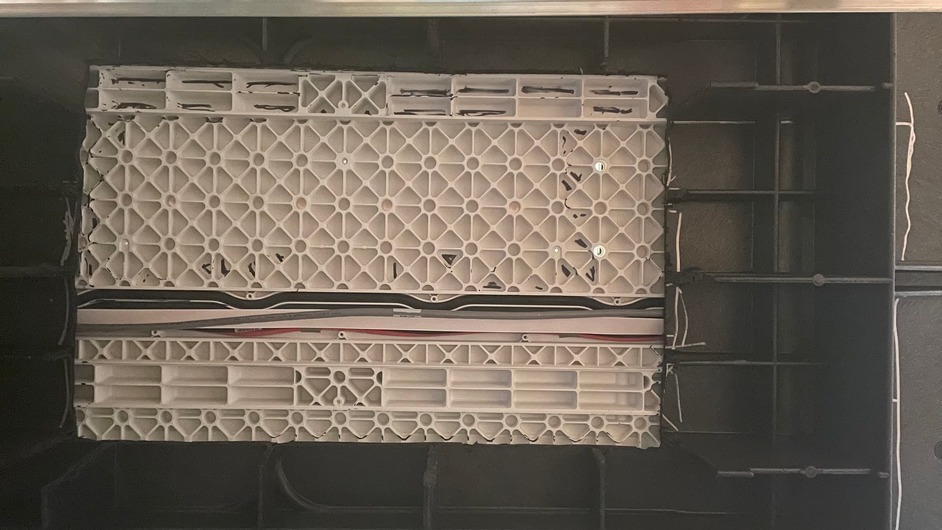

When you cut out the bottom, how did you check to make sure you where not cutting thru any tubes, or wires?
can you put the tray in, and use it?
what are you doing about venting the smoke out?
(My curiosity runs wild)
Jonathan
I took out the crumb trey then removed the silver plate that’s underneith the crumb trey on the inside of the GF. There’s 5 small star screws that screw in from bottom the GF. Then I measure 1 1/2" from the center of the back screw holes on both the right side and left side and drew a straight line across. That gave me the cut line for the back side nearest the gantry when it’s in the home position. I measured a 1/2" from the trey removal door on the front side on both sides and drew a line across the front. That gave the cut line for the front. Then I measured 1/2" from the little notches that the crumb trey sits in on both sides front and back to get the side cut lines. I squared it up and cut it out with a dermal cut wheel and a jigsaw. There’s a metal price on the bottom that has a lip. It house cables. I can put the crumb trey back I’m and use as normal as well.

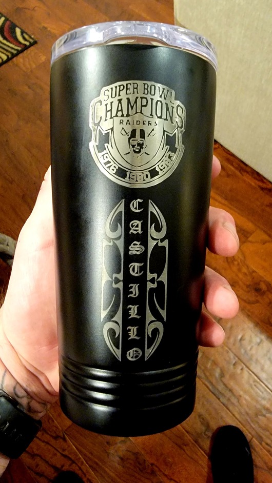

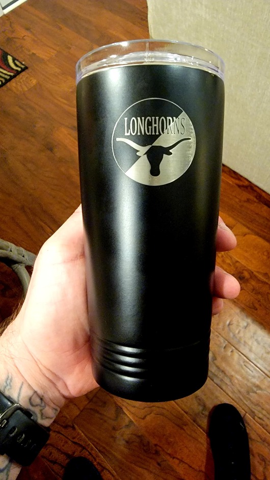

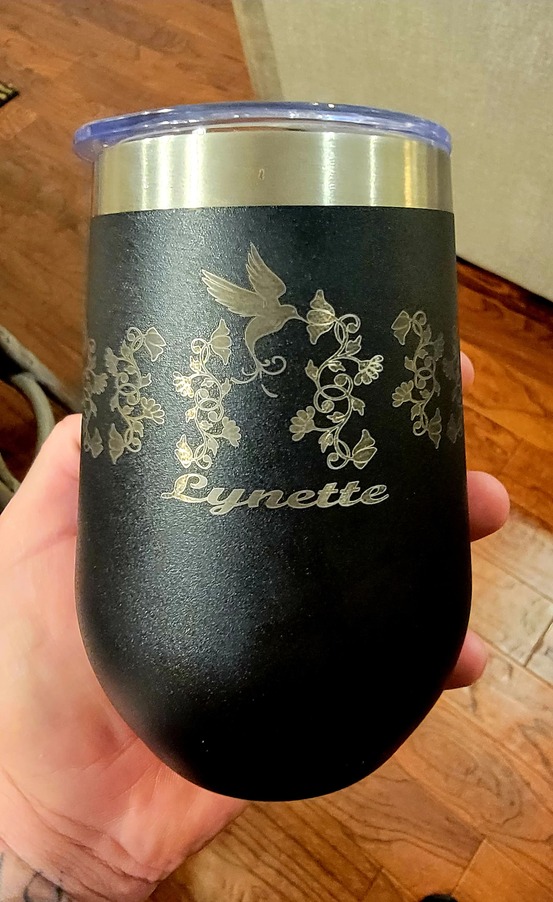

Been playing around with this new found space after cutting the bottom out. I think I figured out the cylindrical thing with out having a rotary tool. Had to manually rotate the tumblers and do multiple engraves but it workout pretty good.
One thing that might help is manual focus. But it would take some measuring. Basically, split the difference between the highest point of the engrave and the lowest point, and you’ll have a little more consistency over the curvature.
In the other photos you shared, it looked like you were probably going a bit too far out of focus at certain areas which changes the energy density, and how well it will engrave.
You can usually wipe it down with some LA Awesome cleaner (dollar store) after the engrave and it will clean up any engraving residue really well.

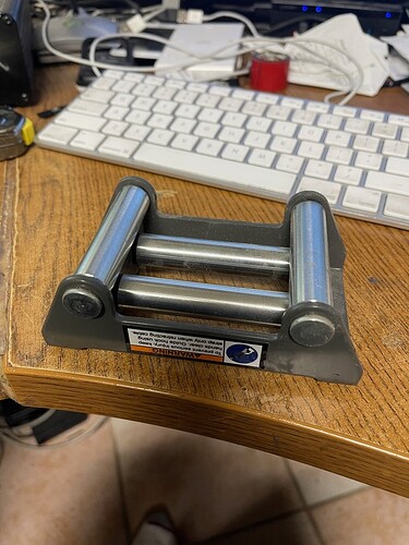

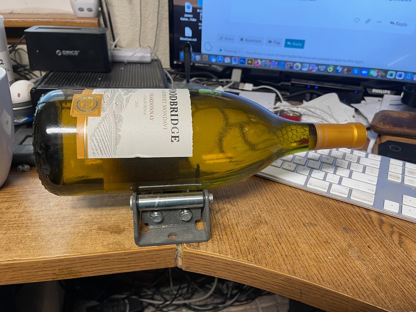

I found this in harbor freight, its used to manage pulley cables for a winch,
I think I paid like $20 for it.
Good luck finding one that works for that price.
I think the way @castillo_87701 did it is best: just measure in 1/2” from the metal plate. I did mine the odd shape because I was concerned it might hurt the structural integrity of the machine. It doesn’t, so just go ahead and make it a rectangle slightly smaller than the metal floor plate. That way, you can replace the plate and use it like a regular glowforge when the extra height isn’t needed.

my issue / question is there is about 6 cables, how did you move them to be out of the way?
[Orientation bottom is back / top is front]
You really wouldn’t need to unless the object you plan to engrave is that big. Cutting up to it is what most do since the laser can’t go back any further than that anyways.
