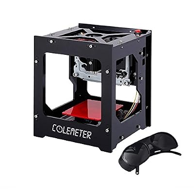

In my opinion, any rotation that is not controlled by the GF is a non-starter. I would stick to the Chinese laser.
To my point of view, I think that your choice is not a choice between two different machine but a choice on what will you do with your laser machine.
If pens and rotary engraving will be your only use of the Glowforge, I am agree with you, Chinese laser seems to be more adapted to your need.
I don’t think that rotation option is a priority for glowforge developpment team now. So I won’t be optimistic that this option controled by the glowforge hard-and software will be a possibility soon. Buut I don’t have any contact with GF team and I have no PRU so I can be wrong.
And I can’t imagine experiment myself a way to control a rotary jig with the glowforge. But with a 100 dollars chinese laser, you can clearly consider the risk to do a diy adaptation like the one in the youtube video.

A third is not acceptable when I can do 360 degrees with a $100 engraver.
Can you link to the $100 engraver please.
