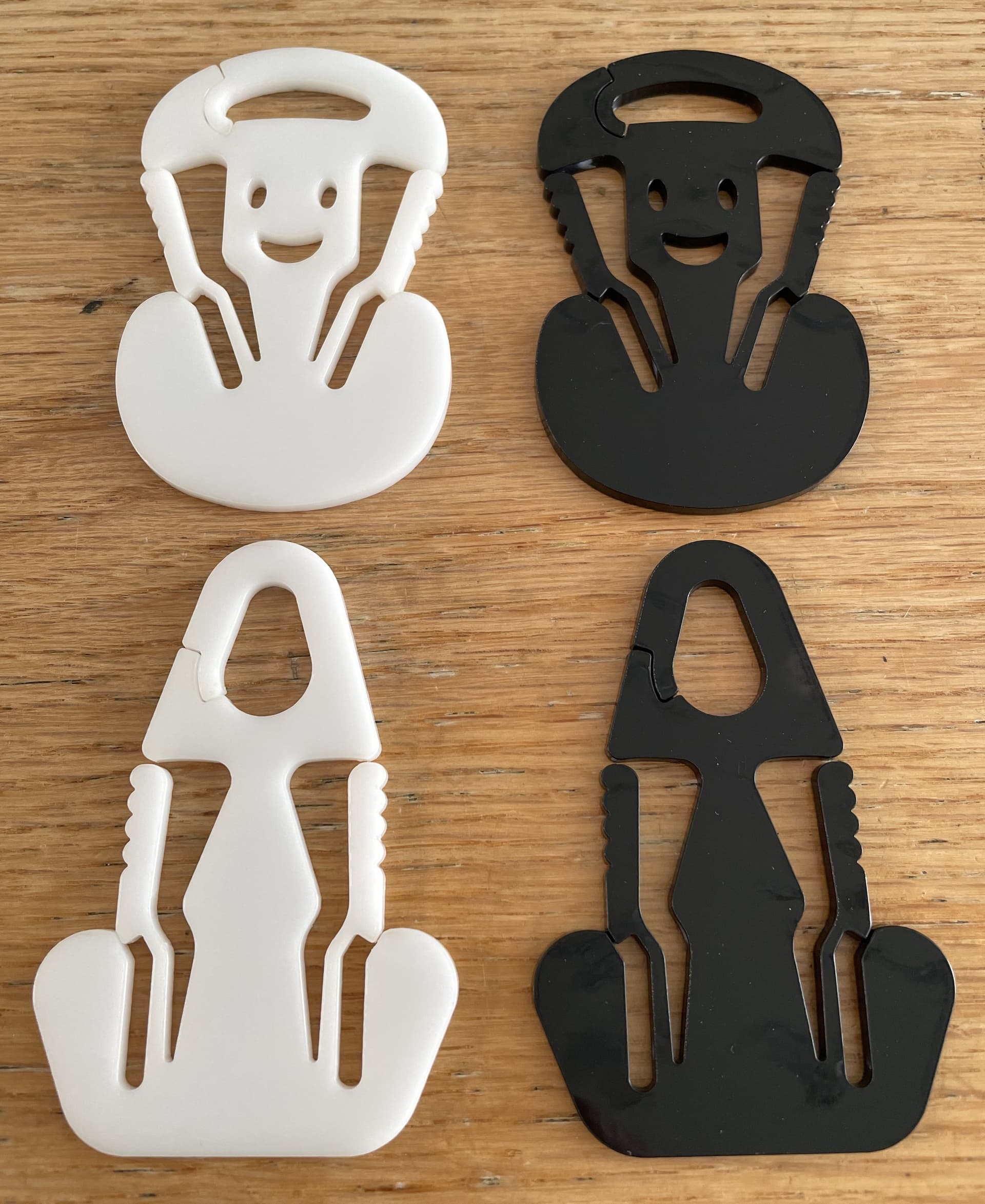

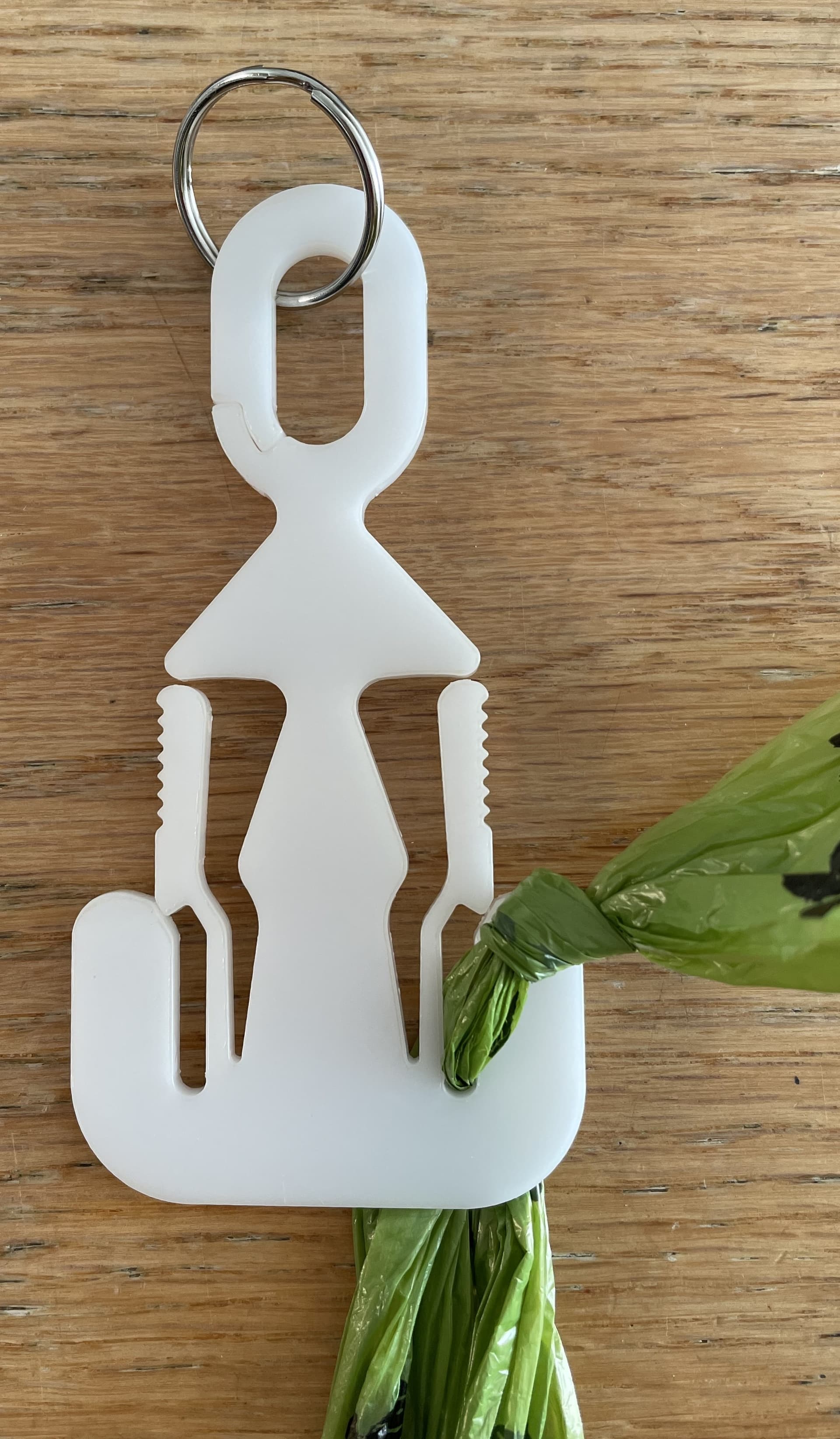

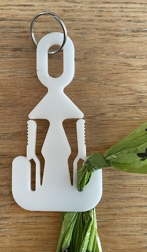

Dog Bag Clip
Designed some clip things to hold dog poop bags! They need to be cut from 1/8" acetal (Delrin). Files in link: Dog Stuff - Recent Projects - Erik Roby

Is it just me or do these look like far too happy dr who cybermen?
I thought the bottom ones look more of the Dr. Who Daleks
I can see it for the bottom ones. This isn’t the forum to say what I thought of them. :flushed:
But the top ones:
