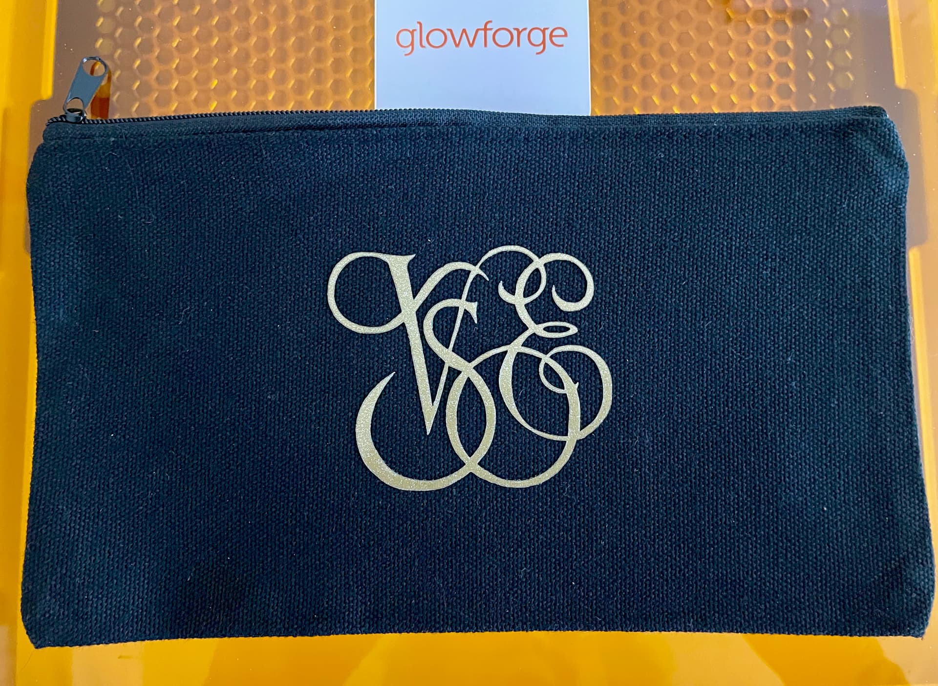

I have only tried it once, but I did get it to work. I don’t have a heat press either…in fact, since we moved into this apartment, I only brought a little mini table-top ironing board with me…so that’s what I used. I did go online to find out what the equivalent setting on a household iron would be for 350 and I’m pretty sure it was a 5 (blend) on mine (my iron is really old though). I had to press it down for longer than I thought it might take.
It was really delicate and a bit difficult to remove after cutting, but it turned out really lovely…it’s the logo for the Orient Express on a small canvas bag.
Thanks everyone. My experience with irons and ironing chores is quite limited in spite of my advanced age. I will exert more heat and pressure on a firm surface. @Xabbess your bag turned out quite nice.

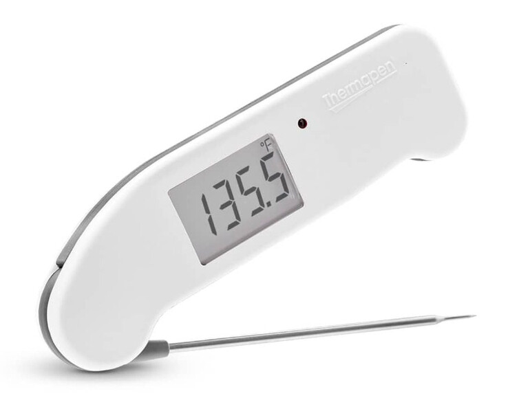

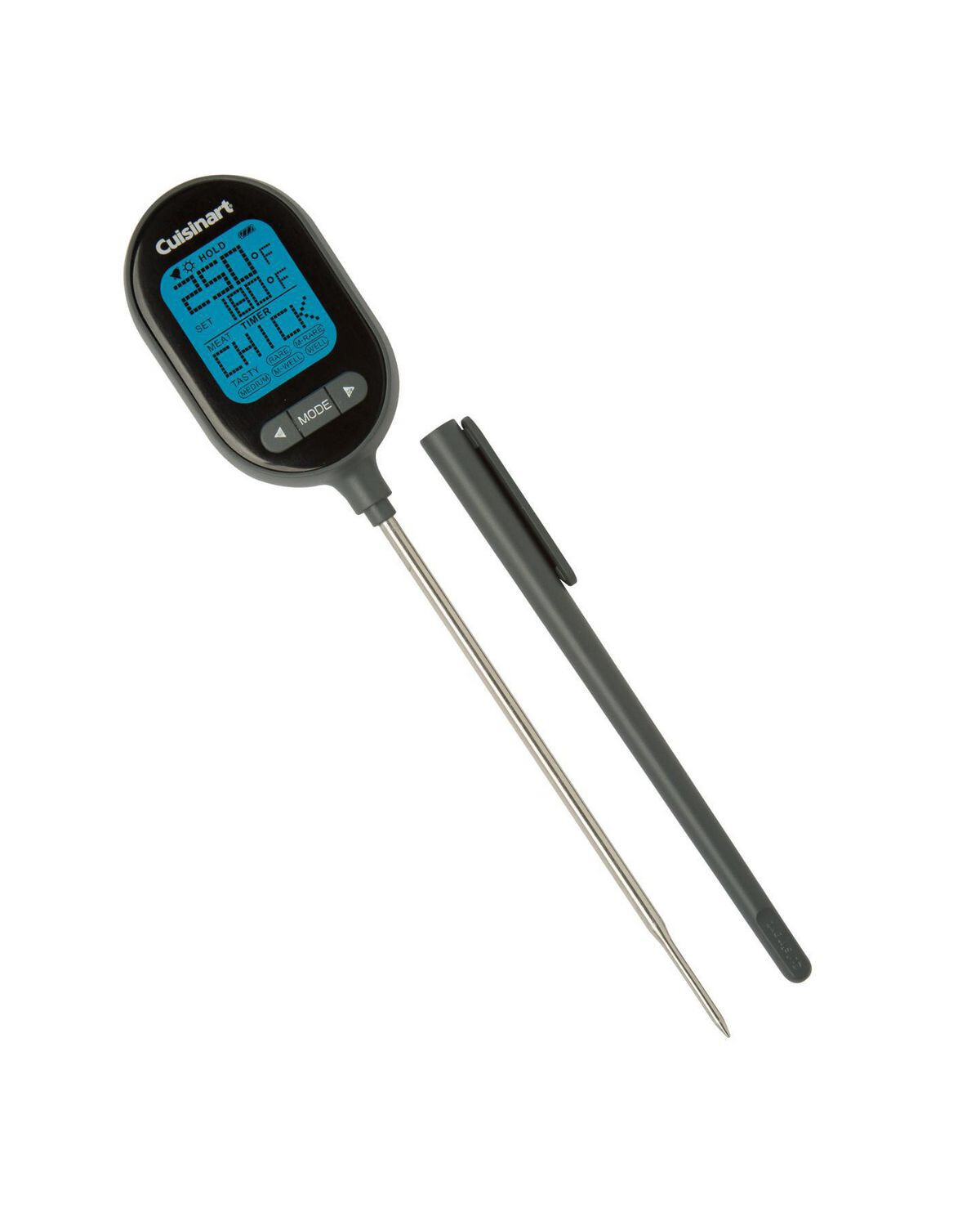

I use a non-contact thermometer to test mine.
If you have not dialed in the right emissivity for the iron’s surface you may be off target. I prefer a contact thermometer when practical because it eliminates that problem.
