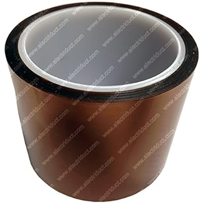

Possibly polyimide?
#6
This was going to be my suggestion. I’ve never tried it for electroengraving, but I’ve used it as a mask for electroless nickle plating.
Here is a 3" wide roll on Amazon. They have smaller rolls as well, wasn’t sure how wide of a part you were thinking of making.
#7
Polymide worked so poorly I forgot to mention it. :slight_smile: maybe it was my settings, but it just charred. I have a large roll of Kapton from my 3d printer I was hoping to use, since I don’t use it for 3d prints anymore.
#8
That stinks. From looking online, it seems people cut Kapton, but they don’t really engrave it.
I mean, unless you are trying to make Graphene. :grin:

I’ve done some masking with polyimide tape for powder coating and it works OK in my opinion. The method I used was to cut out the shapes I wanted to paint and then weed them out before coating. You’re right, it basically turns to ash… black fine ash. Another problem I have is that it tears so easily it’s a huge pain to weed and then it’s a huge pain again when you’re peeling up the masking. Features wider than… say… 5mm are OK, but ~1.5mm wide and smaller are really annoying.
I can’t remember if I’ve tried engraving away the polyimide. I have, however, washed a piece of aluminum that had masking on it and the mask held up basically perfectly, even with gentle scrubbing with a toothbrush. Perhaps the char could be washed away?

So I revisited Kapton tape today. It looks like it may be a winner after all. The trick was 2 passes. One at near 100%power and 150mm/sec next pass at 100/200, it’s possible a third would have been helpful to remove the remaining adhesive, I used an abrasive powder, and dishwashing soap to remove the light residue that remained. The tape held up well, and the engrave is pretty clean, although some of the serial numbers we lost.
#18
Looks pretty good!
Did you find out what went wrong with the serial numbers? It looks like some mask remained in the missing part of the “1”, did the laser just fail to hit that spot hard enough, or did something happen during the washing phase, or something else entirely?
Was the abrasive powder Comet or Ajax by chance? That’s what I use to prep my aluminum. :slight_smile:
PS, what thickness was your tape?
#19
It’s pretty thin Kapton. Thickness isn’t specified.
https://www.monoprice.com/mobile/product/details/12134?gclid=Cj0KEQjwxPbHBRCdxJLF3qen3dYBEiQAMRyxS6f0BvIg-B-9wrIhFasW7hSONpJxzCL0YPOop7G3Y0UaAg5k8P8HAQ
Yes some residue remained in the serial numbers. If I had a Glowforge I would have vector engraved them. I will probably wind up buying a number punch set. A set is 10-$20, and will be more authentic anyway.
