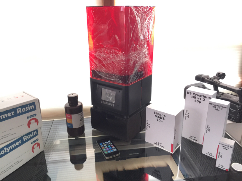

The price points fathomed by resin 3D printers recently have been irresistible, so I didn’t.
Resolution, build volume, release mechanism, and z-axis rigidity are the key features that’ll get my attention and that’s why the Elegoo Mars has earned its spot in the stable over other candidates in the near-$200 price range.
The Elegoo’s size is considerably more desktop-friendly than my previous three, but IMO a little bit more height would put it in a perfect ergonomic level when sitting on a desk…

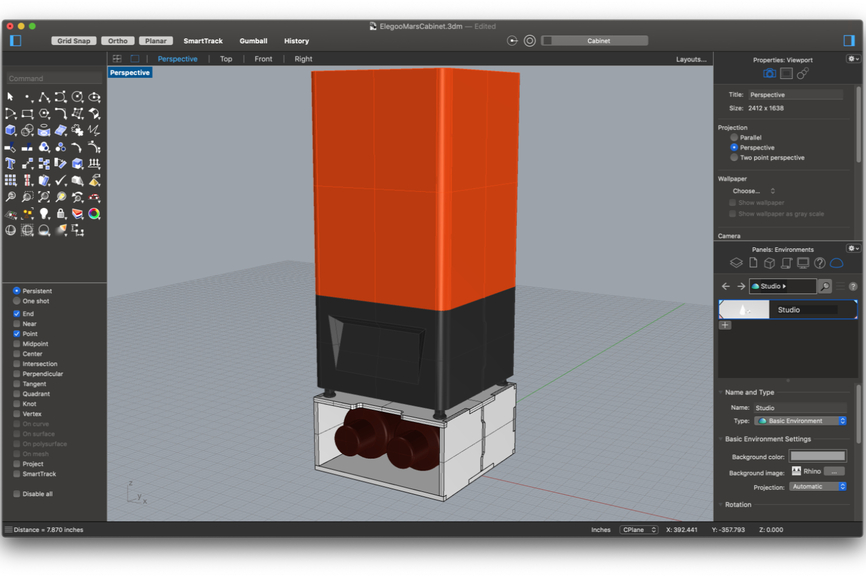

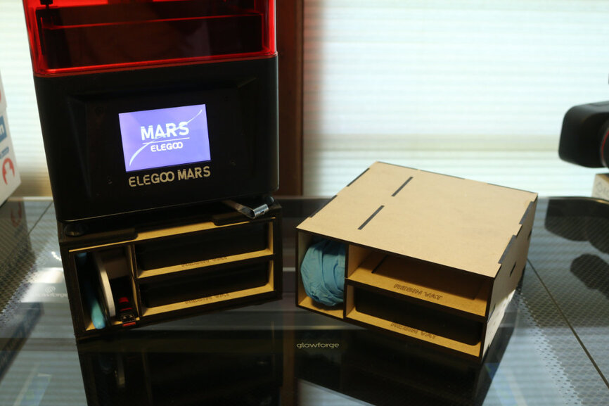

In this episode of Pimp my Printer™ , we make good on that threat to bust a CAD on that Assembled cabinet. General-use pull-out drawers? Maybe some other day if I find myself in a vegetative state…

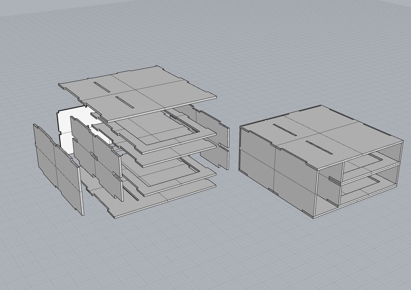

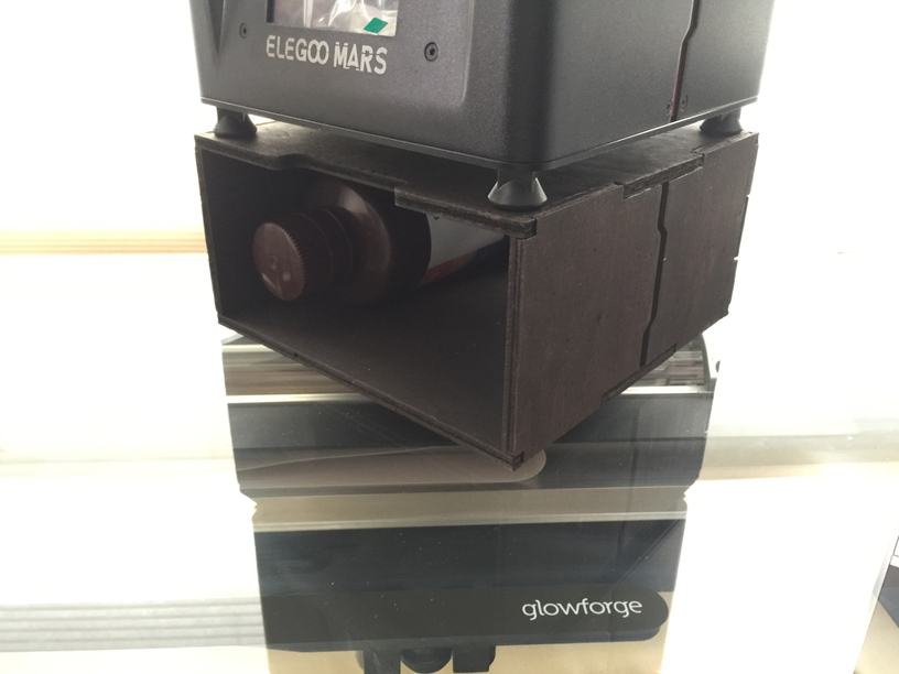

Behold functional storage for Resin Vats. The design goal is to support the vat at its edges and specifically minimize contact with the flush underside FEP film that serves as a crucial layer release mechanism in stereolithography printing. The custom-fitting nature of each slot ensures the covered vat sits in shadow to halt any stray 405nm UV light from getting at the resin.
Elegoo has released a bundled kit of twin metal vats. As if the Printer itself wasn’t the steal of the century, the Resin Vats are ridiculously underpriced considering what Anycubic charges for just ONE and moreso considering the cost of replacement vats on my first two printers from 2012: $500 and $120!

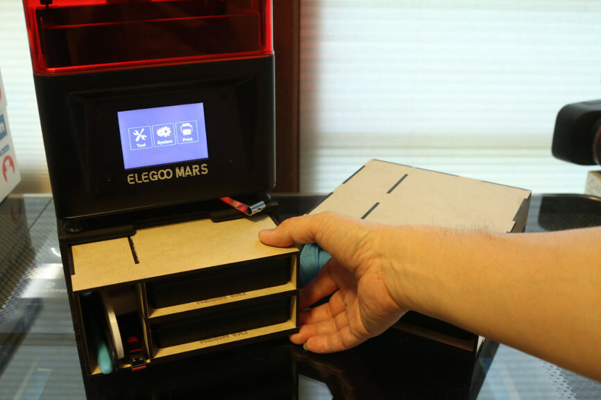

Modular design allows some of the fastest on-hand access to a grouping of resins for a particular project… Figurine printing will gather the cabinet insert that bundles Gray & Skinshade Resins. Model-making will call for the insert that bundles Black & Translucent Resins. Jewelry-making can have its own insert dedicated to Direct-Casting Resin.

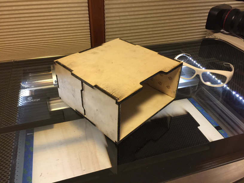

Custom pro-level snug fit courtesy Glowforge, Medium Draft Board, and a bottle of wood glue.
What other ways can we use a $4000 machine to pamper & adorn a $260 machine?

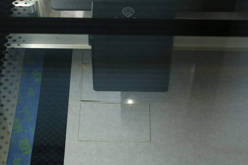

Custom-cut protector for the touchscreen with delicately radiused corners?
No, most laser cutters will not cut Tempered Glass protectors. The Glowforge cuts cheep rigid plastic (polycarbonate?) protectors just fine though. FYI, an iPad Pro sized sheet will yield a dozen protectors for the Elegoo Mars screen.

Aaaand to bring focus back to the glory of the Glowforge, I present to the Elegoo caucus, resin vat insert print files:
-=-=-=-Right-click Space Below -=-=-=-
ElegooMarsDrawerA
ElegooMarsDrawerB
-=-=-=- Right-click Space Above -=-=-=-
This is optimized for two sheets of .125" Medium Draftboard. Might need to re-order the layer sequences in Glowforge UI. Text gets Scored first. Two series of small, internal cuts followed by a single outer perimeter cut. All curves have been optimized to cut once (no overlapping double-cuts)
BOTH files have a stray, separable panel that you can initially ignore and apply toward a scrap, fit-able piece of Draftboard. Exploded image posted earlier should provide a straightforward dry-fit before committing the tabs to glue. When gluing, I found it’s best to assemble from innermost parts outward.
Happy printing - resin and PEW PEW kind!
