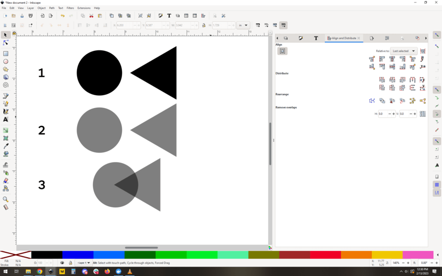

Something like this:
1: Make your shapes.
2: Set the transparency to what you need (I chose 50% just as an example)
3: Overlap. Nice. Now export as a PNG and go nuts with 3d engrave/vary power.

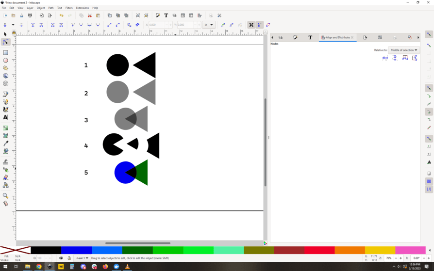

Alternately, use booleans to make three separate shapes, then reassemble your svg.
4: Use booleans to split your shapes into three separate areas. (whole other topic)
5: Color code and reassemble. Now you can assign different settings to the various parts in the GF interface.
Separate sections will be slower than using one pass with a raster image, in this case I’d say probably 2.5x as long to do the three sections separately, depending on settings.
