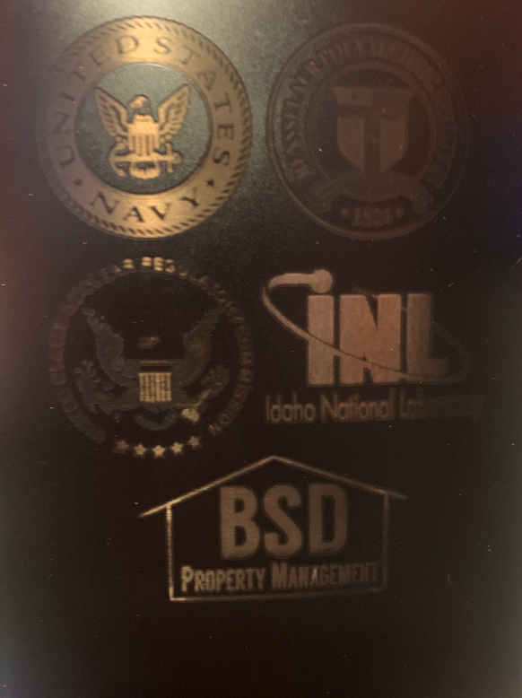

Hello- I engraved a few beautiful designs on black flasks with no issue - then using the same setting Im not able to replicate the results.
I used the silver MacBook Pro setting- first round had great results
Cant seem to replicate it-
Anyone have any suggestions?

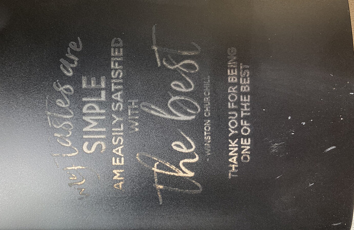

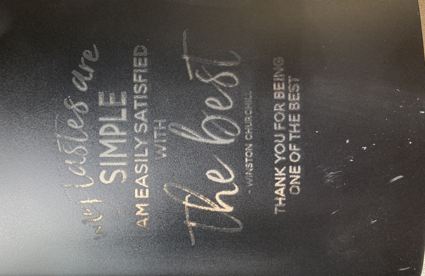

Hello Its power coating - - Its having trouble on the curves- engraves fine in the middle-

You have curved surface so the laser focus isn’t going to be “right” across the entire surface. For best results, you want the focus to be about halfway between the point that’s closest to the laser and the point that’s furthest away. Don’t let the GF auto-focus. Measure the thickness of the flask at the thickest point and use that for the height of your material, but subtract off a couple of mm so the focus is mid-way between the closest and furthest points from the printhead…
GF is making changes/improvements to things all the time. Autofocus is a fairly new change that could easily be affecting your results compared to before. Manually entering focus height might get you back to where you were before.
The laser has to focus at a single level. Anything above or below will not receive the full power. If you focus on the middle the curves will be progressively worse. If you focus below the middle the outer parts will be better but the middle not so good.

So, I wonder, are these the exact same flask? Could it be the earlier ones had less of a curve across the engrave?

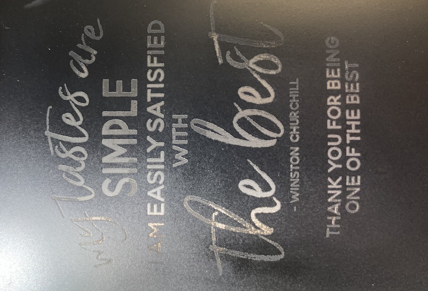

Thank you all - I was able to get this to work Bc of your help!

I used the macbook setting as the material choice, removed my crumb tray, and taped the flask to 1/4" plywood. That worked for me but the designs on the edges needed a second pass. This could be because they were too small or because of the curve, not sure. I may try to reposition the design and run it again or just start with a new flask.
