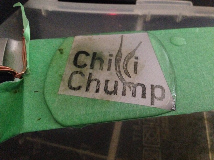

Just a proof of concept, but I wanted to be able to etch some metal for a project I have coming up so here is my test and the result.
Coated the blade with clear coat spray paint. heated it to dry it and then loaded it into the machine to remove the paint to create my resist.
I taped off the area and hooked up power. passing the electrode over the areas I wanted to remove.

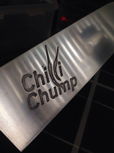

After a few passes washing it gently in between, I cleaned off the paint and gave it a quick polish.
This is the result.

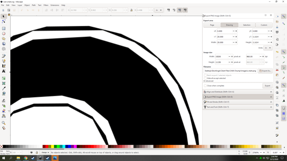

Mistakes were made the first time where the original file was from when I first started cutting on the laser and makes me cringe to look back at it low, so a better starting image would be better.

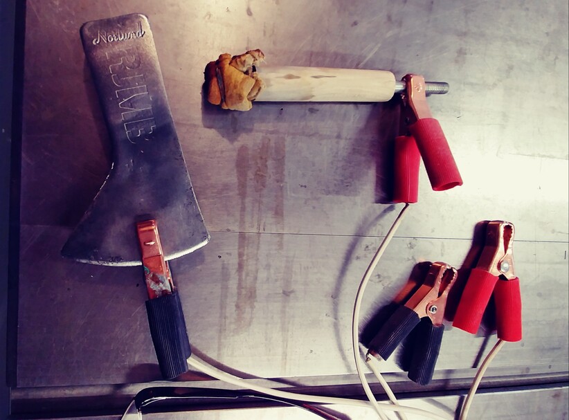

This is how I do it:

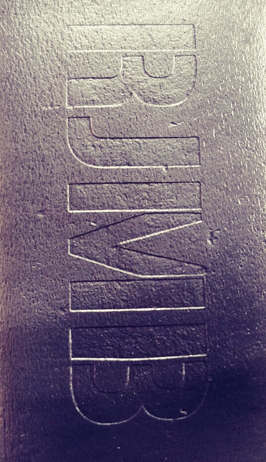

I drilled a 3/8 inch hole through a wooden dowel and pushed a 3/8 bolt into it. Then I wrapped the bolt head with cloth. Using a double strand of electrical wire with alligator clips attached to all 4 ends I connect one end to the bolt and the other to the batteries negative terminal. The pic shows the red clip which would usually indicate positive so I should have used the black clip on the bolt for that picture. The other ends are connected to the positive terminal and the work piece. I then hook up my battery charger to the battery. When it’s all hooked up and turned on I dip the cloth end into salty water and rub it slowly over my stencil on the metal. Each pass removes a small amount of metal so you can go as deep as you like.
Do you need to use a special material on the end that holds the solution?
Nope. Just something that will hold a little of the salty water. I just used a piece of cotton rag.
You’re really just providing better contact for the electrical current.
