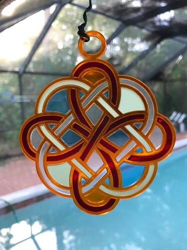

I have tried this but I seem to still get some tiny gaps between the acrylic pieces and frame, see attached pics. you can see the white light come through where the acrylic doesn’t seem to go all the way to the frame. I have offset my interior pieces in Inkscape by .2mm, any thoughts on how to get the pieces cut exactly correct for no gaping?
You keep adjusting for kerf. Also, consider flipping the internal pieces so the angle of the edge is opposite that of the frame.
@uhsoccer In theory, you shouldn’t need to adjust the kerf at all. @dklgood restated what I wrote earlier in a way that might be better understood:
compared to:
yes I have. what do you mean I don’t need to adjust the kerf, if I don’t offset the pieces in the frame, they would just fall right through.
I’ve done exactly this. Once you get the kerf just right, the pieces fit into place and don’t come out. Well, you can push them out. And, if dropped. some might pop out. But I’ve yet to weld using press-fit.
I have made quite a few stained glass acrylic pieces by cutting them out. It is a bit tricky, but I like the results. You do have to adjust for the kerf. The best thing I have found for holding the pieces together is MicroMark’s Same Stuff plastic welder. But the pieces must fit tightly to use it. CA glue works, but I’m hopelessly bad with it, and the bits of skin really show up in the translucent acrylic. I guess flipping would work sometimes, but not all of mine are flippable - that is, they aren’t symmetrical.
Those are great. You’ve got a lot of patience :slight_smile:
Quality CA comes in multiple viscosities, including gel, and there are many options for fine control, including cheap, disposable pipettes with needle-thin teflon tubes. I use them for Weld-On acrylic solvent as well.
All designs can be flipped, just reverse them in the design app. I do this for nested acrylic inlay all the time, gives a snug fit once you get the numbers right. I did this for the “Big Chicken” piece I submitted for the community dodecahedron we made for GF staff, for example. The pieces fit well enough, they held together without adhesive - although each panel used a backing plate for joining to the next, so they were ultimately glued to that.
