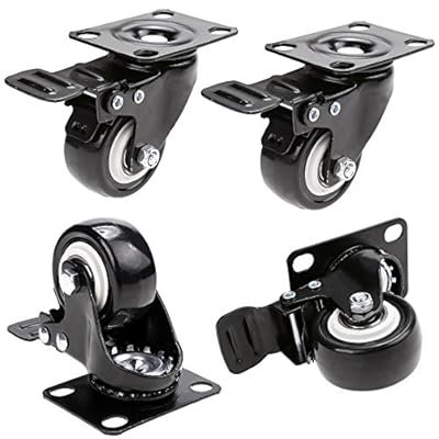

I can’t quite tell from this picture - do you have casters on this? I really like this hack, but assumed that it wouldn’t work with casters. If I’m wrong about that, I may revisit this idea.

Yep! I ordered a pair of these casters on Amazon since I didn’t want the setup to get too tall. I had drill holes into all of the tables to attach the legs that weren’t mean for them, so I just did the same with the casters. I just lock the front ones so I can unlock them to move it easily. The only issue I’ve had so far is the glue holding the bottom of the legs of each layer to the next table top coming undone when I tried to pull from the top layer. Luckily I discovered that prior to getting the Glowforge. Now I just pull from the bottom and it’s not an issue. I wasn’t sure what glue to buy, so I chalk that issue up to user error. :stuck_out_tongue:

Ah. Well I love your setup, but I will want to use the pass-through when it’s enabled so I’ll have to put casters on. I like the ones that can be put down only when you need them so that the platform is totally stable. Maybe it’s not an issue, but with a moving head, I’d like to be sure that no extra vibration or shifting causes accuracy issues.

Casters:
