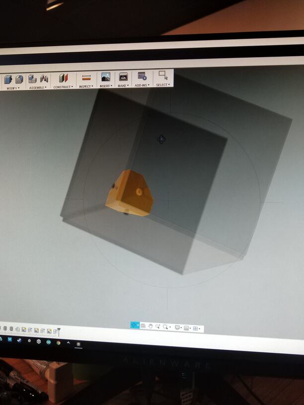

Nothing too crazy, just wanted to make something with simple parts that could be put together to make something more interesting. I just repaired my 3D printer (Well one of them) and made these little nodes to connect panels of acrylic I cut on the forge.
I had fun… pretty cool… simple but it’s a nice warm up.
