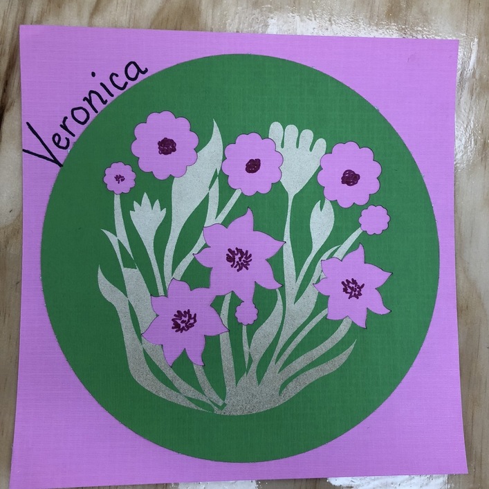

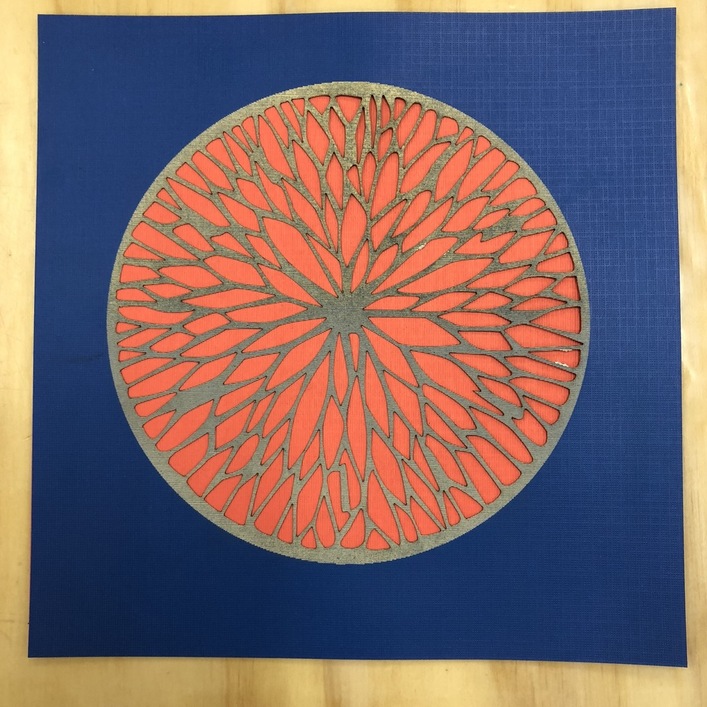

First try cutting and engraving cardstock
I have wanted to learn to engrave cardstock, and I decided to work on Mother’s Day cards for my mom and sister-in-law. My background is on the engineering side, not the art side, but I am having fun learning and applying new skills.
Very pretty! I’m a huge fan of hand-made cards. :grinning:
What kind of sustem did you use to keep these down.
I went with super-easy and used blue painter’s tape on the corners. The air assist blew the small pieces out of the way, but I did keep a close watch in case of flare-ups. No problems. On another design I engraved today, I learned that engraving over the blue tape marks the tape but not the paper with the settings I used. Cutting goes right through the tape, though.
Material thickness: 0.01"
Engrave: 1000/25 125 LPI (75 LPI on the blue and coral design)
cut: 500/47

They came out very nice! I especially like the chrysanthemum one.
Love the top one especially … Purple is very pretty!
