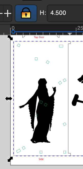

Has the link to the file changed since this was uploaded? The file I downloaded creates a tower that is 2 1/4" x 4 1/2" - which is too small for a standard die. Any ideas about what could have happened?
Hi! Thanks for giving it a shot, and sorry for the trouble. It’s the same file it always was; are you importing it directly into the Glowforge web editor or using an app to edit it?
If I remember right the Adobe Illustrator SVG export I posted only has relative units, not lengths measured in inches or mm, and AI defaults to 72 units (pixels) per inch while Inkscape defaults to 96 units per inch. That’d make your output at 72/96 = 75% the normal size, or 4.5" tall, and aside from the troublesome dice size it wouldn’t even fit together unless you’re cutting unusual 3/32" stock. I don’t remember what Glowforge Web defaults to but it’s very possible it’s changed its behavior since I posted the file.
I’d put it in step 1 of the instructions, but you should make absolutely sure the tall panels are precisely 6" tall in your design app, which might mean scaling the contents proportionally by 4/3 (133.33%) if your app requires it. At that point it should cut and assemble fine on either 1/8" or 3mm stock.
That is precisely the case. Inkscape shows those panels to be 4.5", but in the GF UI they are 6"…
Thanks! The miniaturized version actually fit together just fine, which is what threw me. I’ll keep the Illustrator-to-Inkscape problem in mind in the future.
