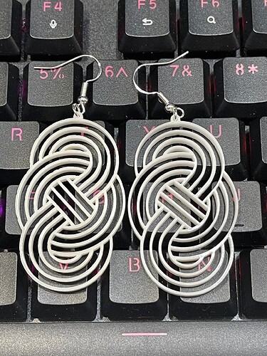

By request of my dear sister, I created the design on InkScape and cut this on medium acrylic.

The geometry of your design is very pleasing looking. I don’t get tired of looking at it. ![]()

Lovely! Great job on the design and the execution of the design is perfect.
Cool design, great proportions.
I do notice some inconsistency in the acrylic thickness. That may be in the design or may be the result of flashback.
If it’s flashback it means you’re overpowering the cut. A material test should help you get it dialed in. #6 here covers that:
Thanks! I will look into experimenting with more settings. These are challenging because of the “thinness” of the lines ![]()
