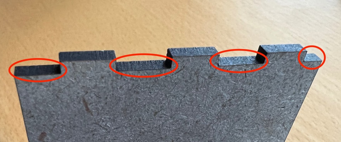

Spread glue on the lower edges of the front, back, and side pieces (see picture), and glue them all together. The two holes in the back piece should be at the top, away from the bottom piece.
