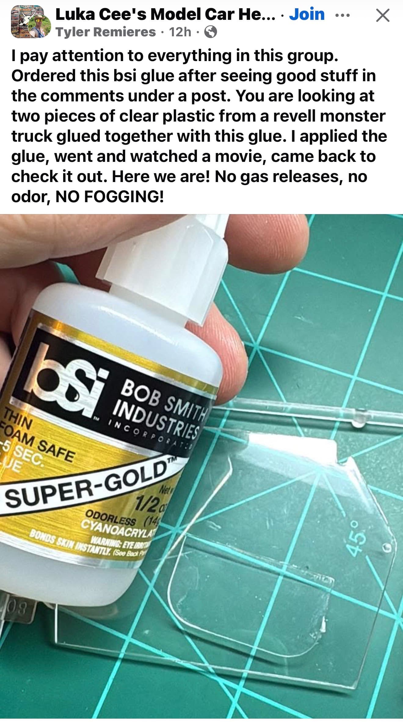

Glue for clear acrylic
I haven’t tried this, but I really hope it’s true!

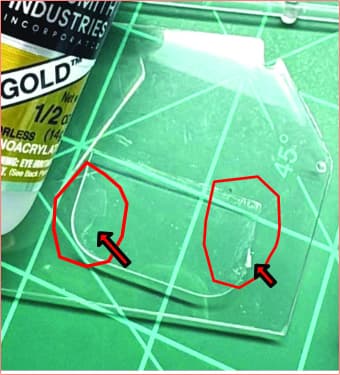

I’m also going to look for this…it would be worth the cost to just see if this works. I am though a bit skeptical…that is unless I’m looking at the wrong parts that are glued together (the photo is pretty bad in that regard)……this still looks like a mess to me.

I was about to comment “if it’s CA glue, how can it be any different from CA glue?” but then I decided to fact check myself and went down the rabbit hole of learning that cyanoacrylates are a family of adhesives.
Most “super glue” and the like seem to be ethyl cyanoacrylate. And then there’s butyl cyanoacrylate for medical use. And alkoxyethyl cyanoacrylate is the low-vapor one that presumably they’re selling here. Also available as Loctite 403, Permabond 940, etc.

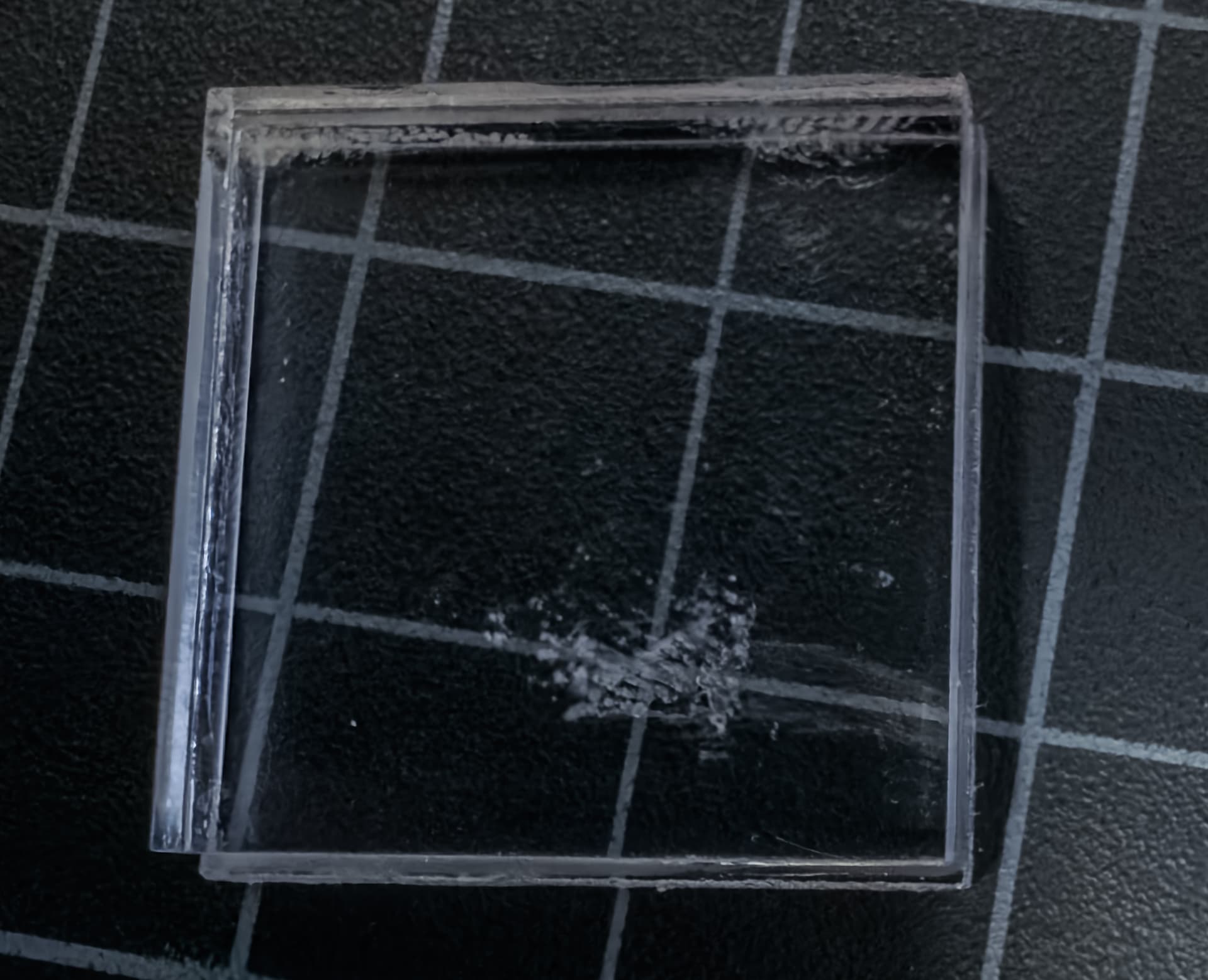

So, a quick and dirty test. It’s super thin. I accidentally flooded, even over flooded. The mark you see is on the back side where I left a CA finger smudge. Other than that, with the flood, it’s pretty clean.
instructions actually say to press together and squirt into the seams. Which I didn’t do. Probably because it has a viscosity closer to Weldon 4. I’ll do some more testing later, but these results felt pretty promising. I’ll try actually following directions tomorrow. :wink: for now it’s time to go find some acetate to clean up my fingers…
