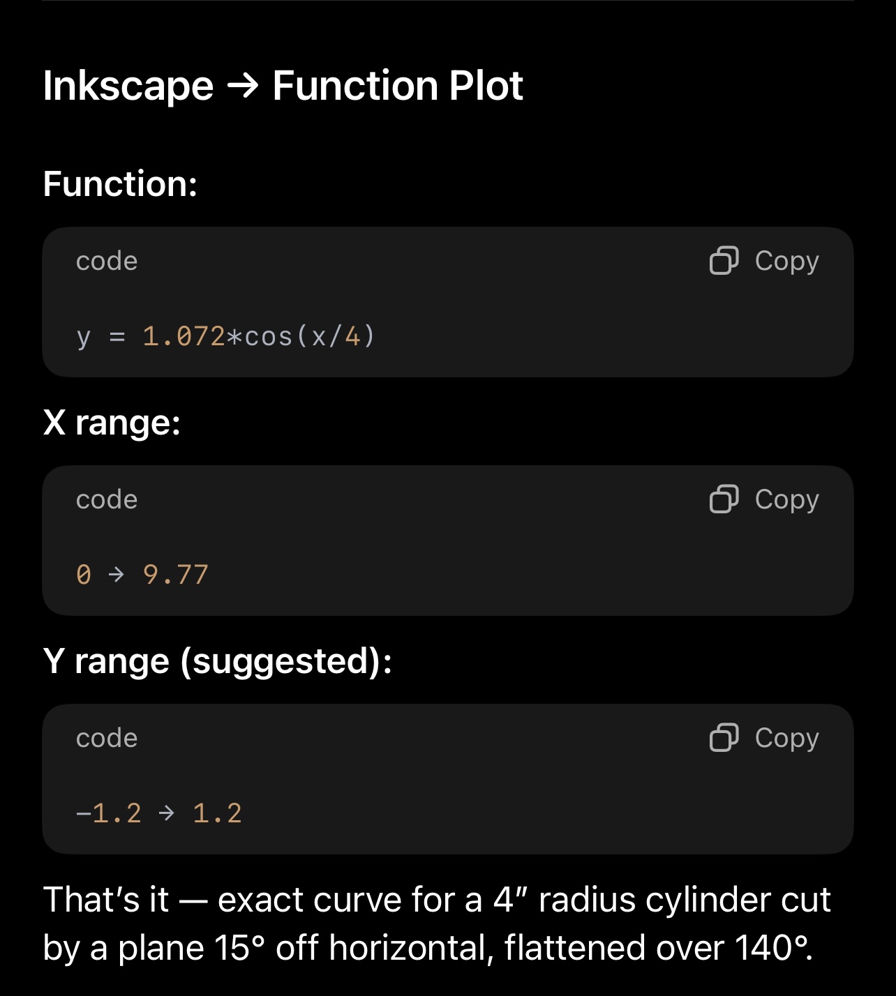

I am not at my pc so I can’t test it but I think you’d use the function plot extension and use function
You didn’t constrain your requirements enough to get a firm answer so I assumed a couple of things:
4” radius cylinder
15 degree plane angle from horizontal
Then because math is hard I asked GPT to help me work out the formulae. GPT is very confident but can be super wrong so I’d recommend testing with something like cardstock to get this dialed in:
Also you’re talking about bending a material which may also introduce inaccuracy.
This is all fine and will probably get you close. Then it’s just a matter of using that curve as the top of your rectangular wall segment.

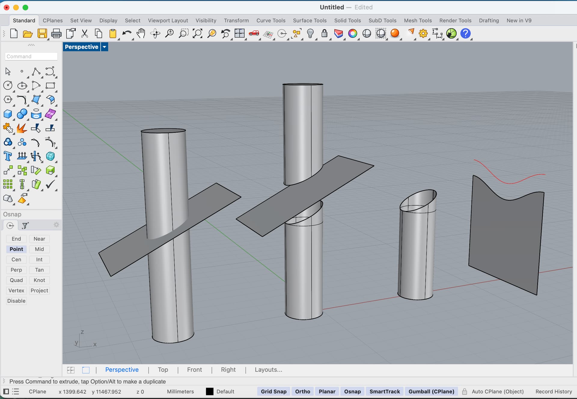

@timjedwards is spot-on. Using a 2D illustration program to investigate something that CAD software is best equipped to reveal is a fruitless endeavor.
Having slept through my fair share of geometry & trig classes, the only highlights that stuck include the notion that if a cylinder were sliced by a planar surface, the cut edge forms a sinusoidal or parabolic curve.
This is the unfinished CAD example started last night before dozing off…
The UnrollSrf command in Rhino3D demonstrates how you’ll never get a straight line from this planar cut UNLESS it’s perpendicular to the cylinder.

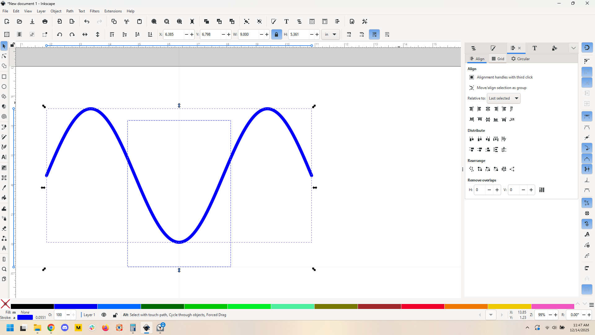

Not gonna fool with functions so I go find an svg.
Cool.
Gonna make 2 assumptions: 6" diameter frame, 1" frame depth, with a 15 degree angled section.
OK, going to do it and see how long it takes.. done. Ten minutes, while figuring it out.
Here’s what I did.
First, some math: 2* pi * r, 18.85" total frame circumference. 140 degree angle, so length of “cut” edge (140 degree arc) would be 140/360 * 18.85 = 7.23"

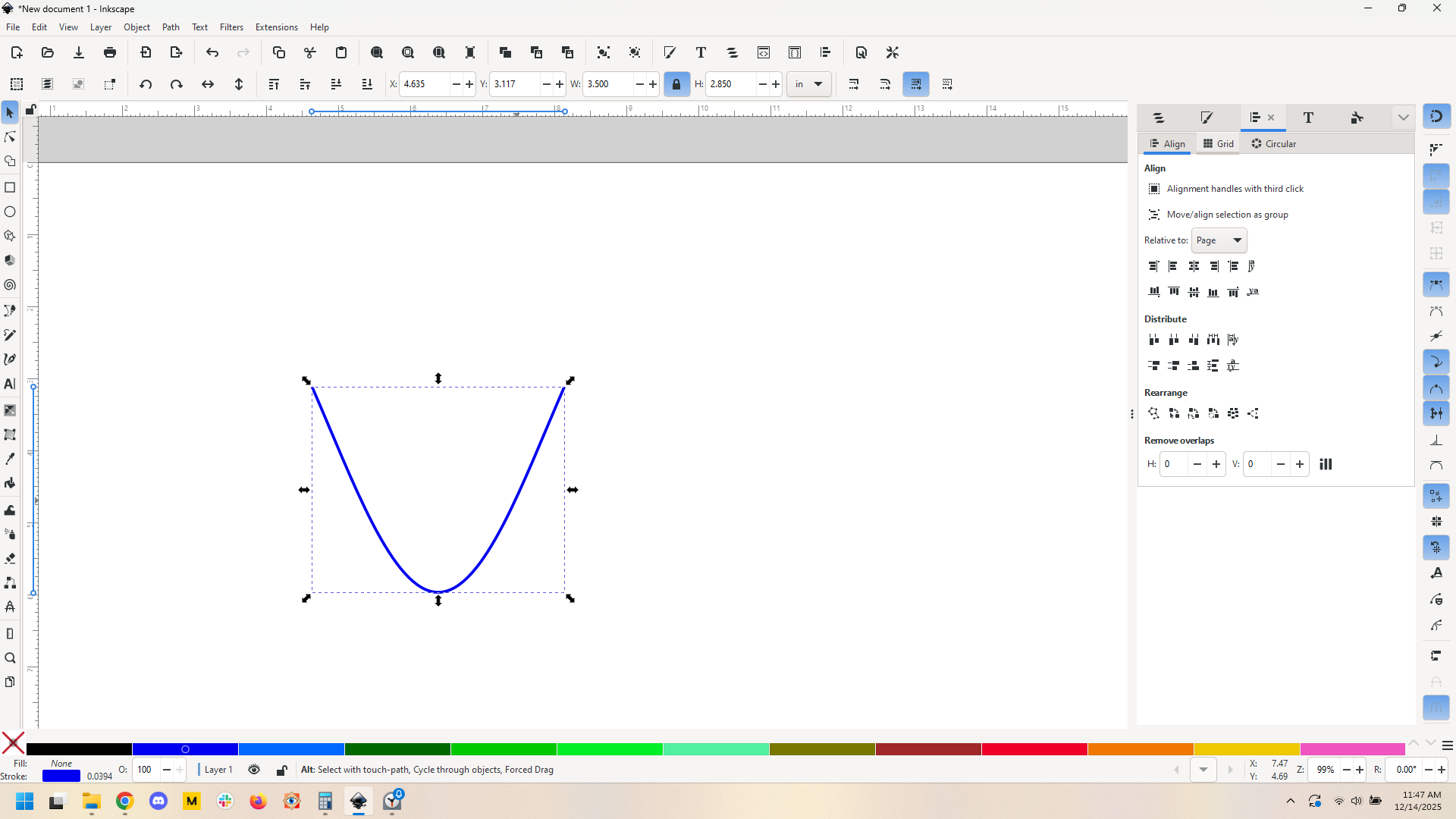

OK so now we need a segment of the sine that is 140 degrees, that’s easy enough:
Get our sine, measure its width. Mine was 9" so the segment we want is similar to the way e figured out the cut edge. 140/360 * 9. I make a rectangle that is that wide, then use alignment
and cut path

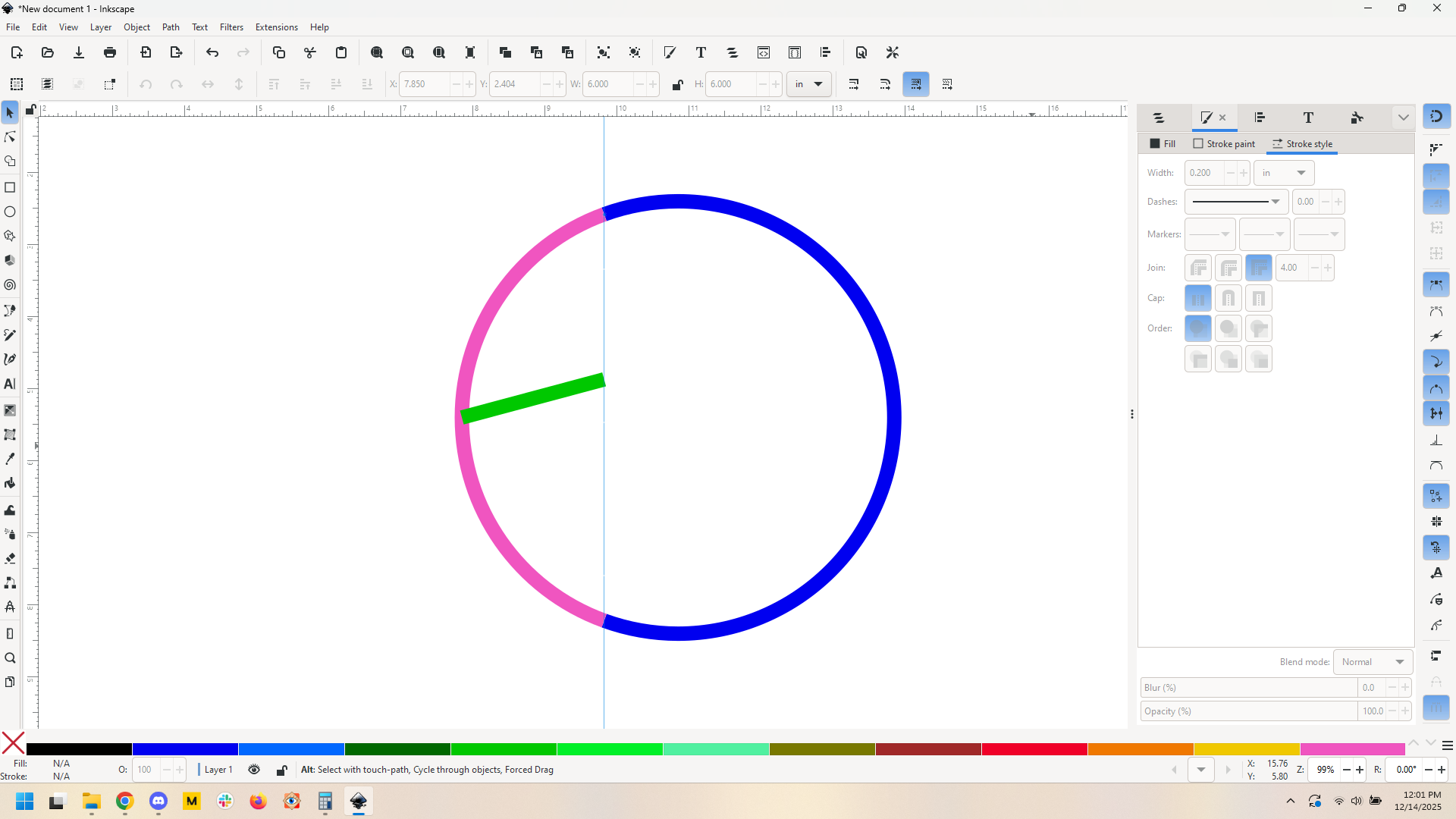

That’s the sine wave. Now we need to know how tall that sine wave needs to be. For that I make a scale circle (blue), cut out a 140 degree arc from it using a path at set angle (pink), then make a 15 degree line that crosses the width of the segment of the circle (green).
Therefore our sine chunk needs to be 0.529" tall.

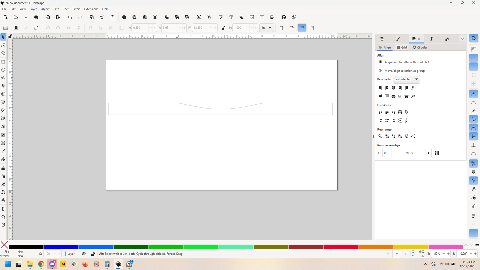

Scale the sine portion to be that height, then align it to our 18.85" rectangle. Some quick path operations later and we get this:
And that should be our frame edge.
I still think a disc sander is the way to go here, but it’s definitely doable in Inkscape, and in ten minutes including time to work it out. If I were to start fresh knowing what I know now, it’ll probably be something like 3 minutes.
Of course this all assumes that I am right about the sine wave here and that the sine wave file from wiki is an accurate size wave (it’s wiki so I think we’re ok). I think I am, but I reserve the right to be wrong :slight_smile:
