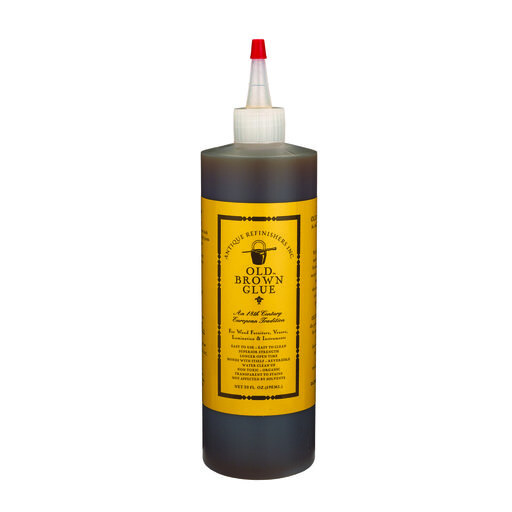

used hide glue for the first time today. just for gluing down some felt in my machinist chest, but i think i’m going to try it on some other things now. the traditional way (melting a block of it) is something i was going to do originally, but instead i found a container of old brown glue from Woodcraft and it was a whole lot easier to use. just put the bottle in a pot of 140 degree water to warm it up, and squirt it out of the tip where you need it.
it’s strong enough it’s a traditional glue for making furniture, so i’m considering the idea of testing it on my next box make. has anyone else used it before?
