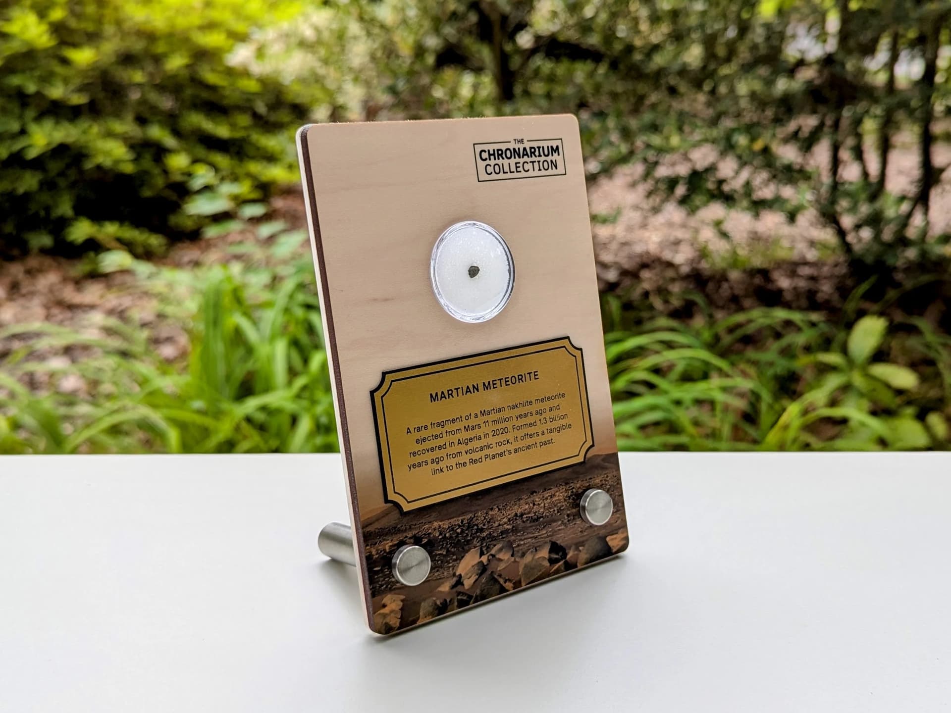

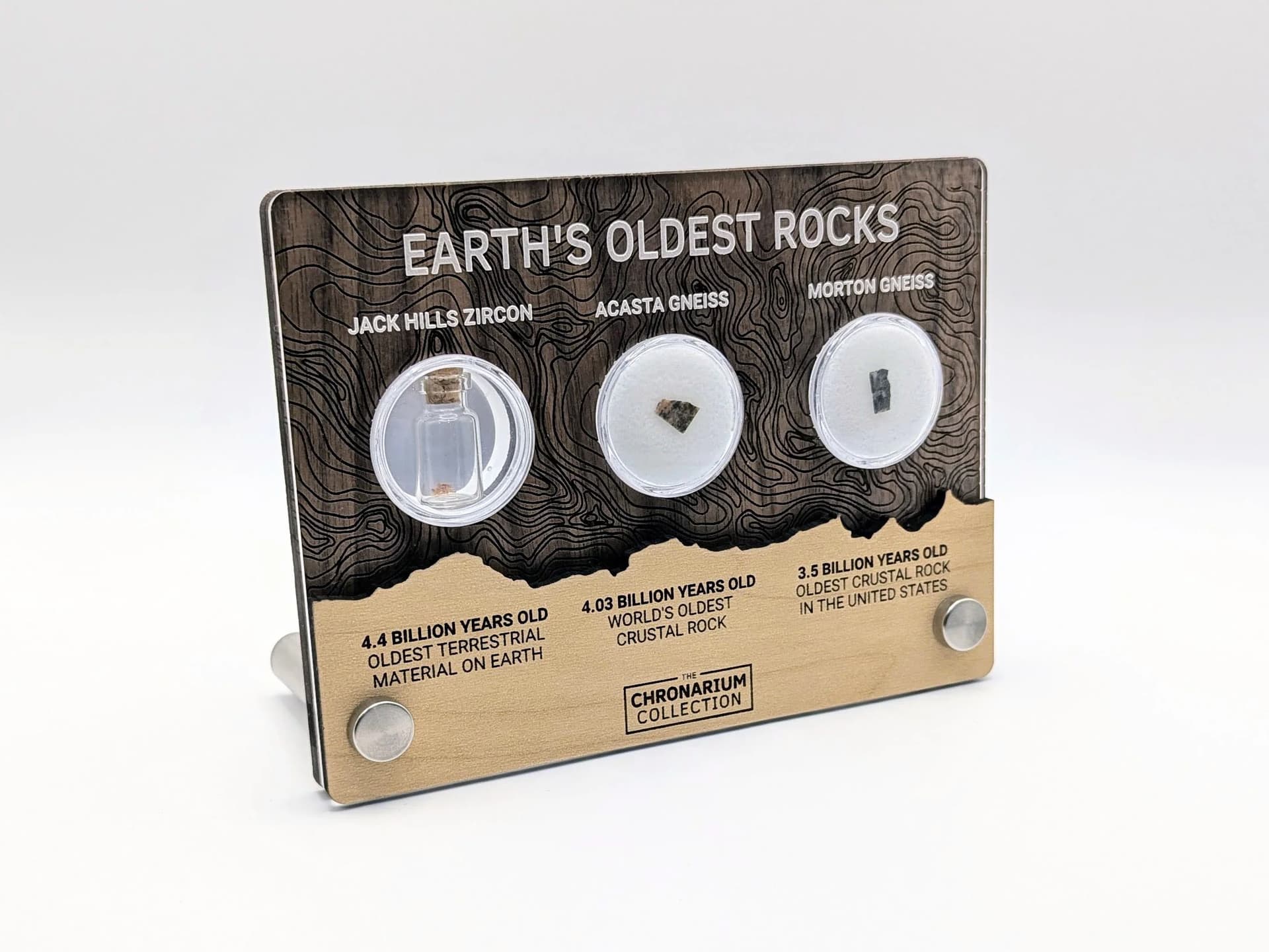

I was in a creative funk for most of 2022 and 2023, not designing much of anything new for the laser aside from making retail displays to help my wife get her glass art business going.

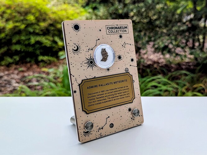

Over the winter I found a new hobby in collecting interesting artifacts from auctions and estate sales and displaying them in a lighted glass cabinet in our house. I’ve indulged my bad habit of monetizing all hobbies by starting to use the ol’ Glowforge Pro and a sublimation printer to make new displays for some of these things to see if I can sell them as gifts for other science and history nerds.
This is how they’re looking so far. Most of it is made with Proofgrade acrylic and maple plywood, a lot of which I got at under $8/sheet from Joanns stores going out of business. I cleaned them out wherever I found the 12x20" wood sheets still for sale. The full color prints use Chromaluxe Maple which is maple ply that has a clear sublimation coating already applied.
I’m not 100% sold on these designs and might start over this summer when I hopefully pick up my first UV printer to be able to print directly on wood and acrylic.

So perfect. My favorite is the earth’s oldest rocks, but they all look amazing.

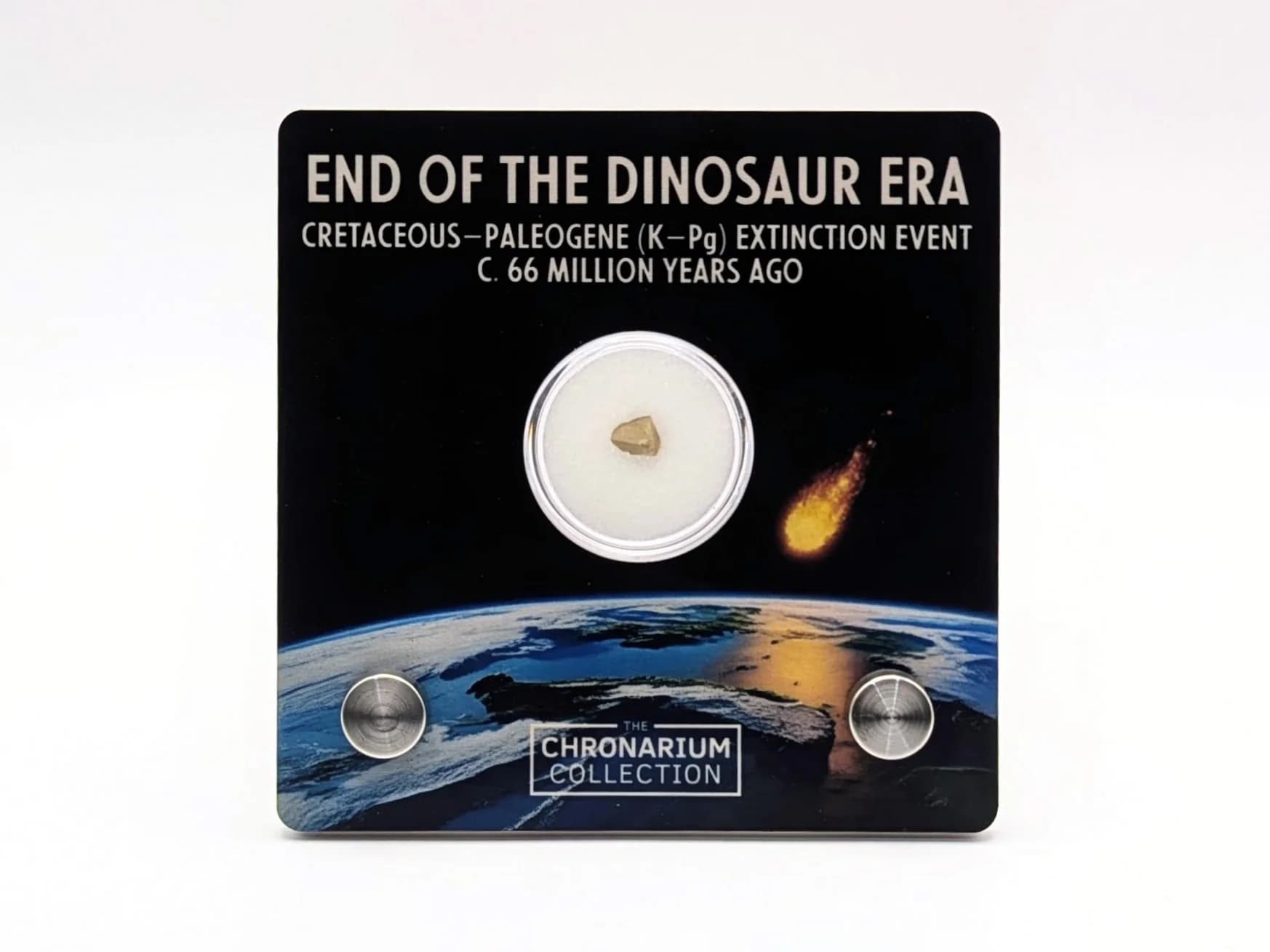

Is this a fragment of the K–Pg boundary? This would have to be my personal favorite.
What fun!! Nice hobby!
It is! The best-preserved and most-studied K–Pg boundary section is in Bidart, France which is where this sample comes from. I had a bigger chunk of the clay and broke it up into smaller pieces for the displays.

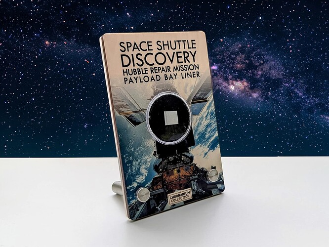

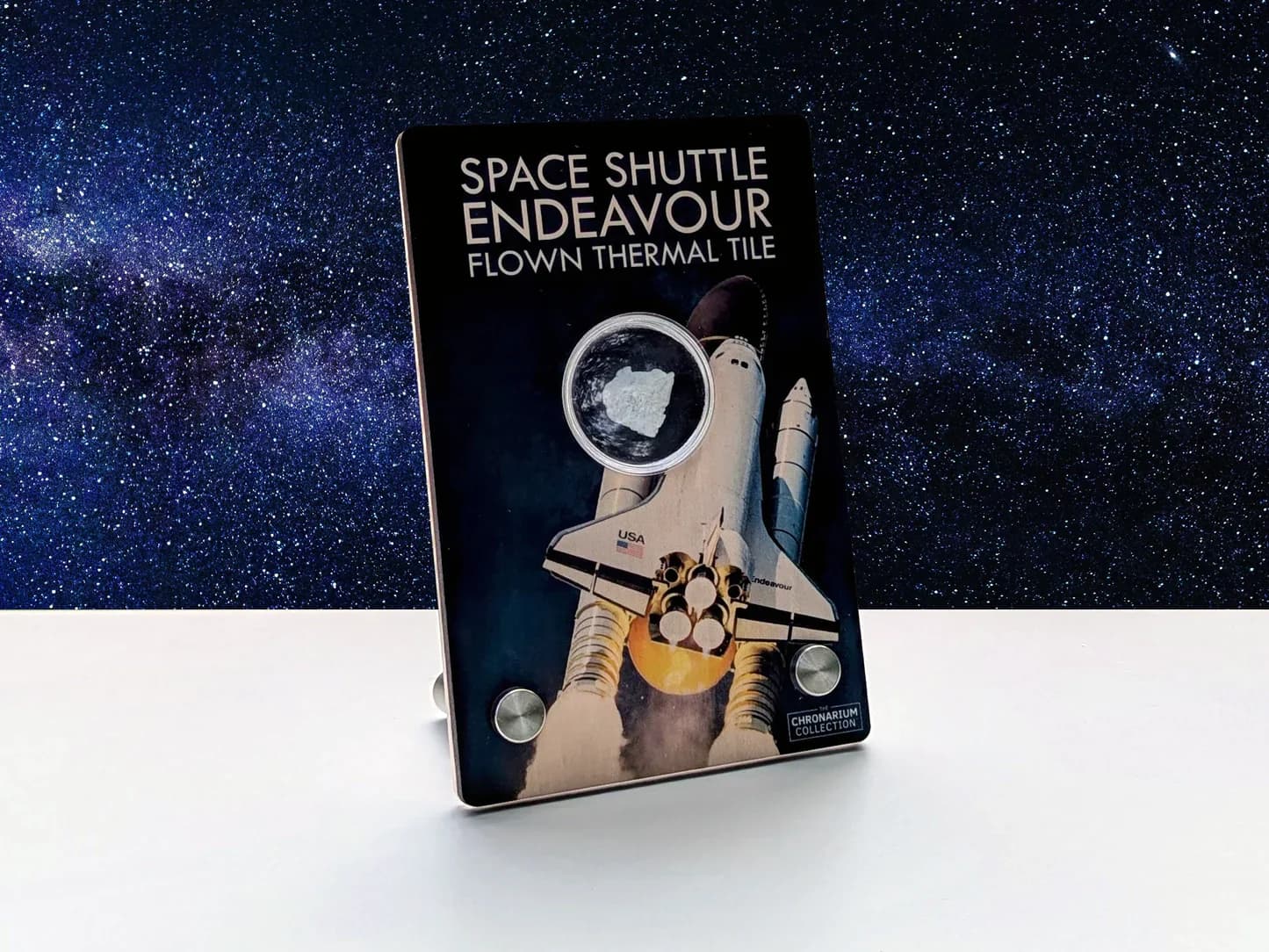

I love those Space Shuttle displays. I actually helped plan the Hubble Space Telescope service mission, along with ~50 other shuttle missions.

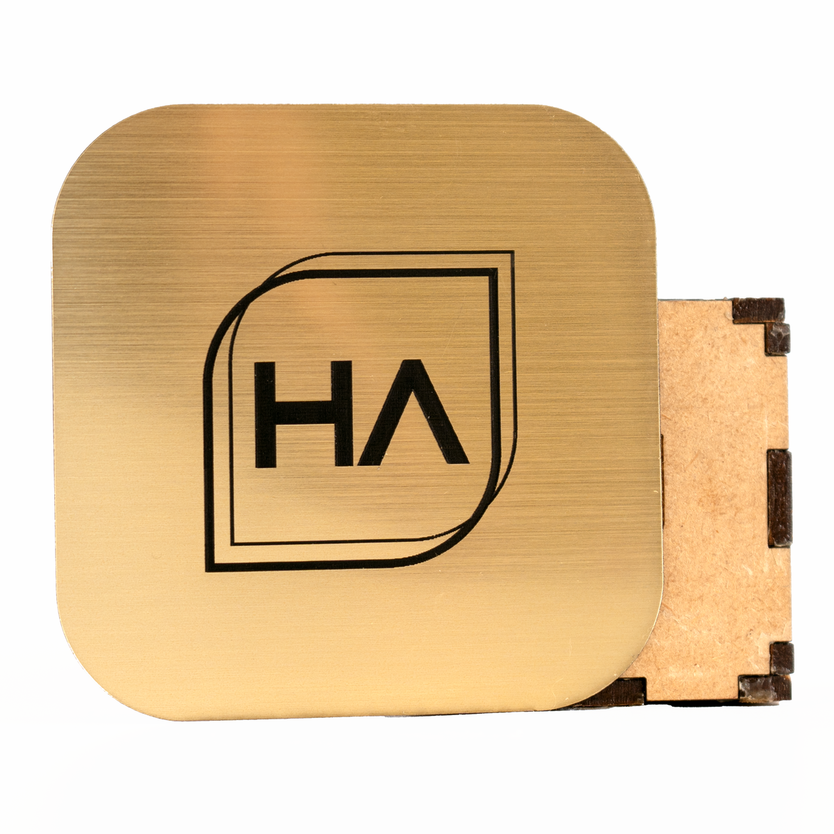

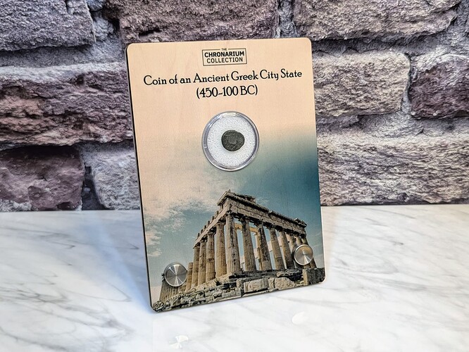

These are great! I have a project that could use some label plaques like that (can’t tell if they’re brass or just brass-looking). I did some experiments with marking spray but got distracted and set it aside.
The plaques are made with Rowmark FlexiBrass. It’s a brushed metal foil on .02" thin black acrylic, so just a quick engrave and cut. I buy it with 3M adhesive pre-applied to the back from Johnson Plastics.
Houston Acrylic also just started carrying Rowmark products. I already order most of my acrylic from them so I’ll probably restock this from them in the future.

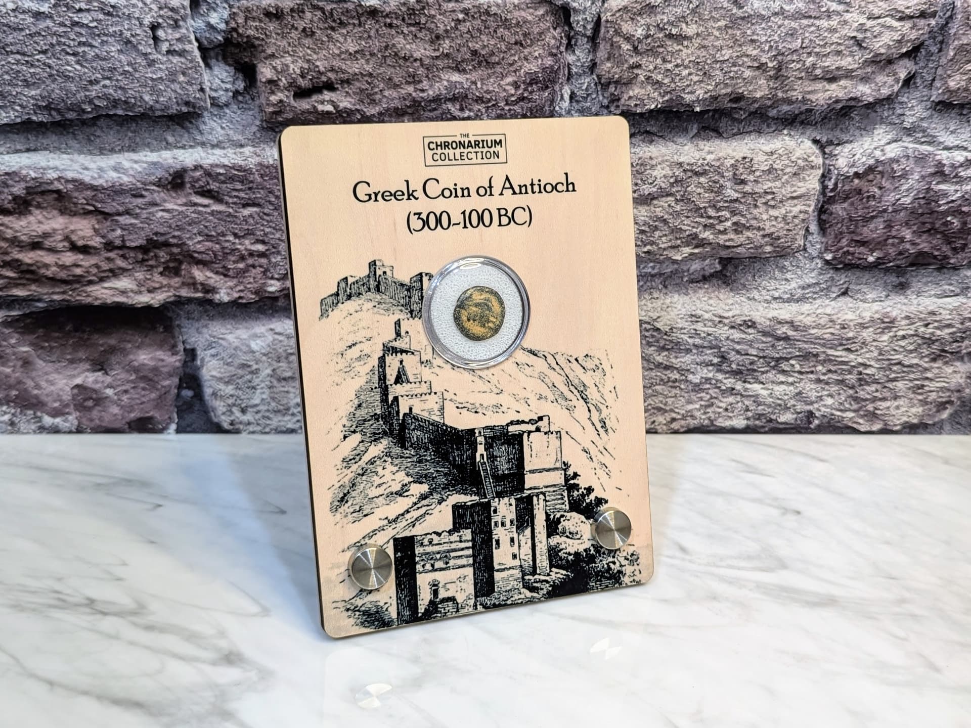

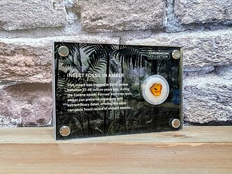

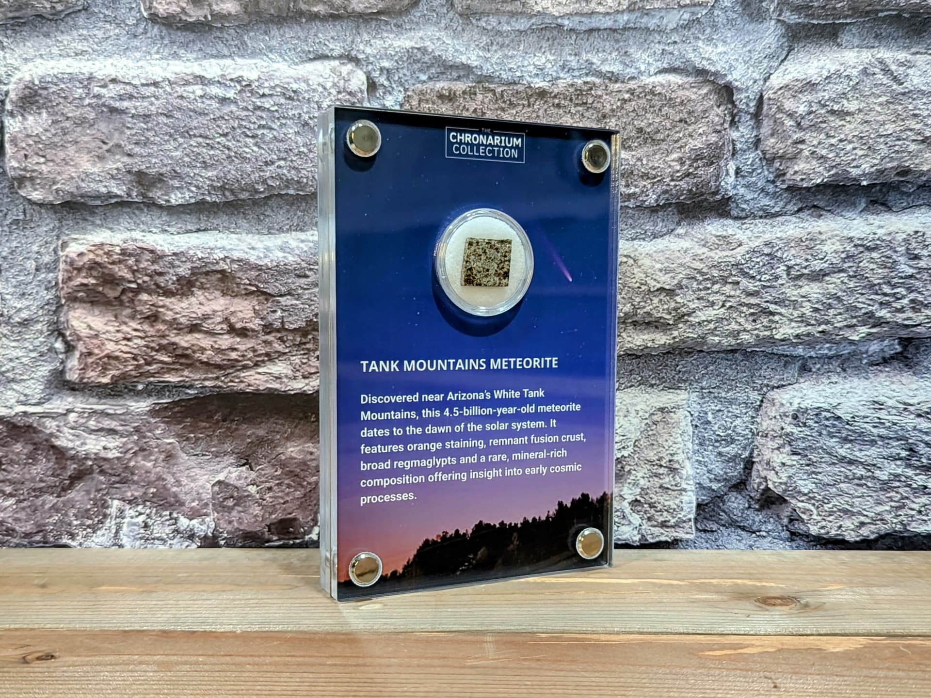

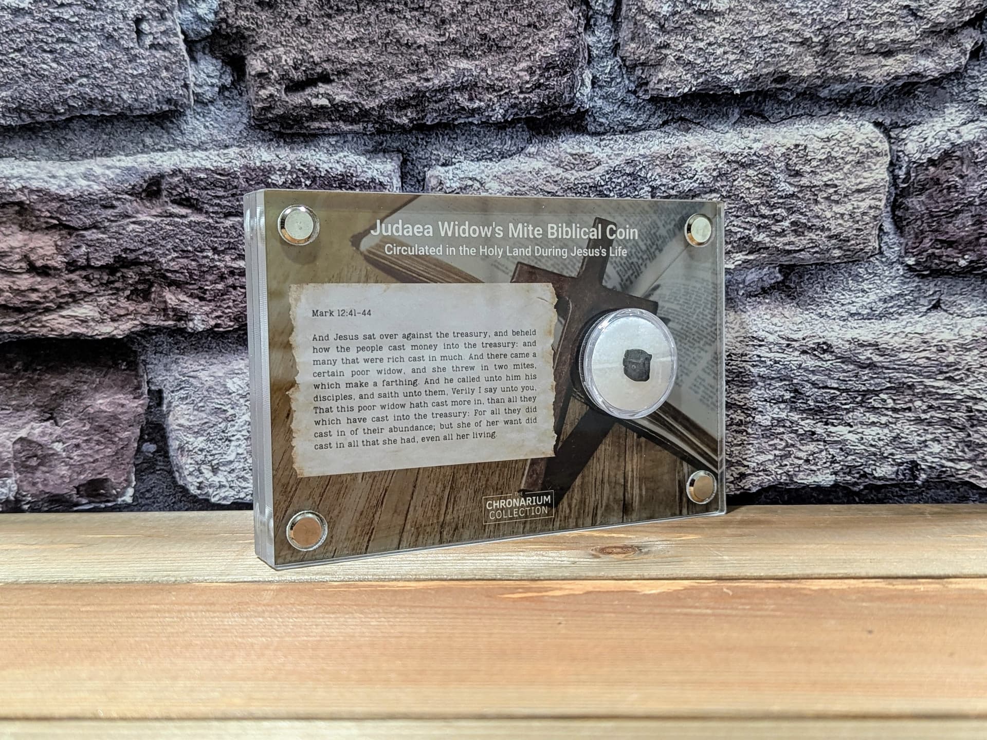

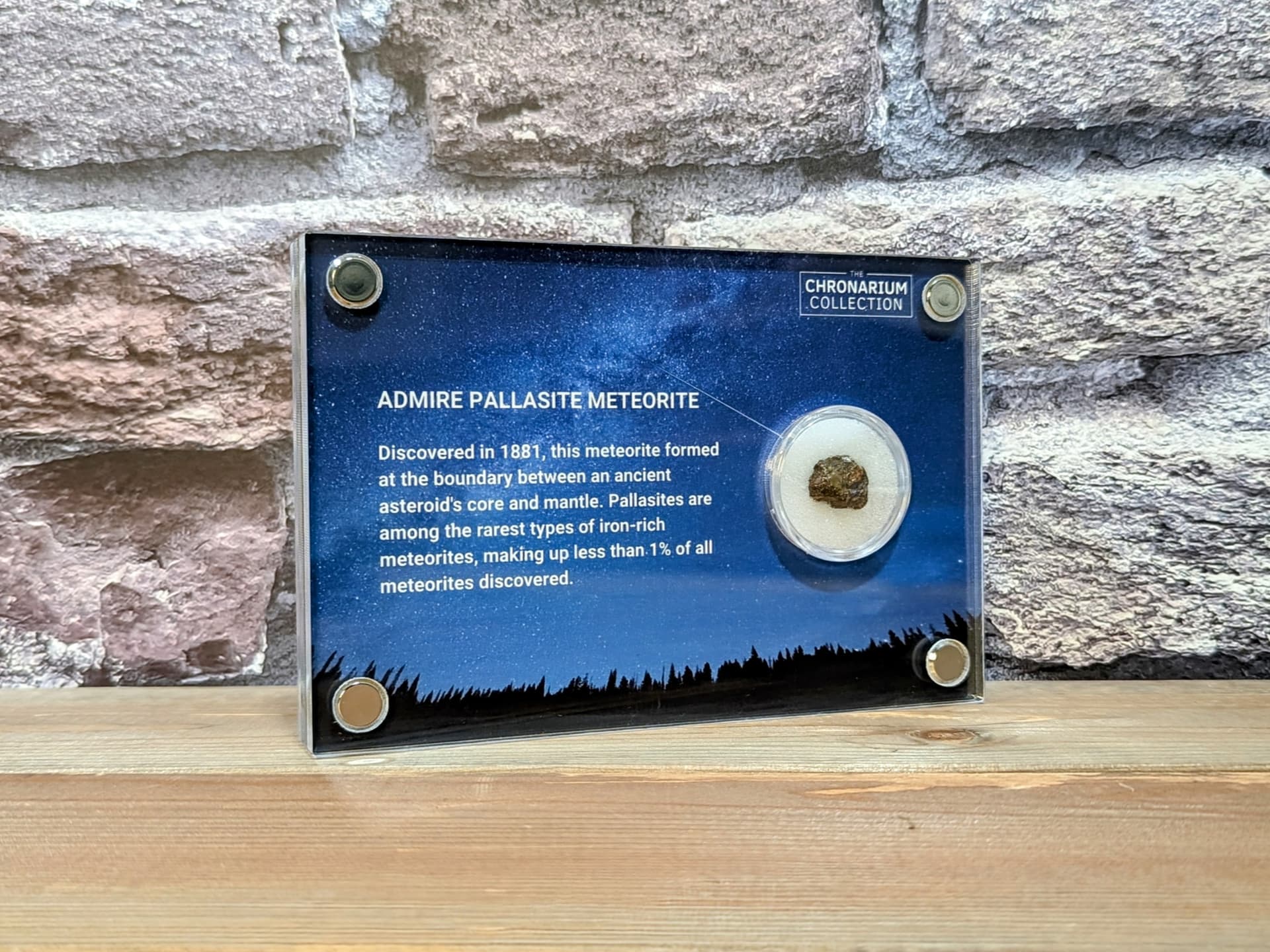

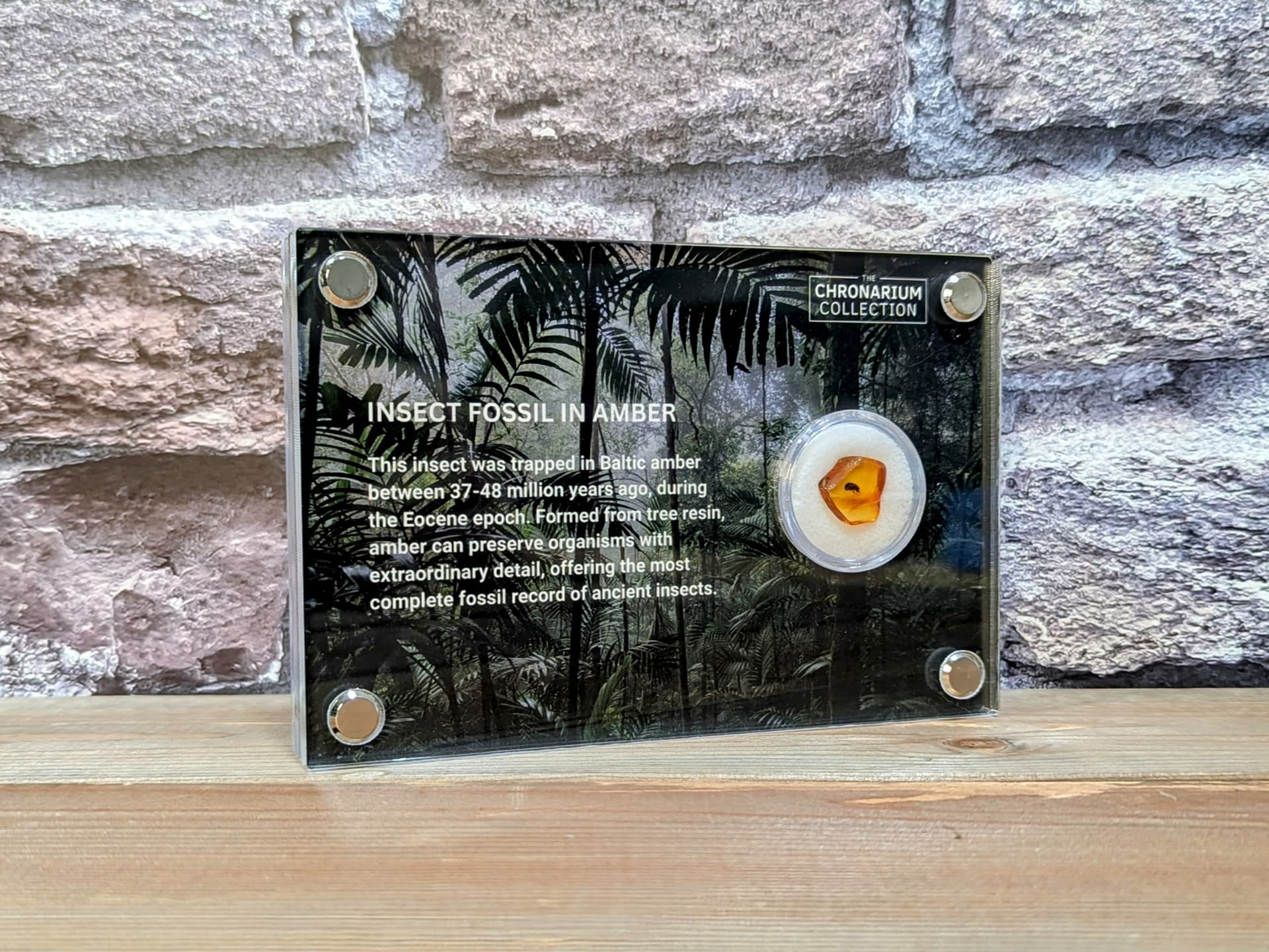

I ended up redesigning a lot of the displays to be made of acrylic instead of wood. They feel nice in your hand but are thick enough to stand on a shelf, and I ship them in cotton-padded gift boxes. Everyone seems to like these a lot more than the other style. They’re layered acrylic connected with chicago screws. I countersunk the screws by deep engraving circles around the screws holes so the tops/bottoms sit flat with the acrylic surface.
Some examples:
