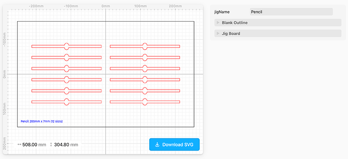

If you still have issues with locking it down for other users or need parametric or non-destructive editing. I would recommend Cuttle. A cloud based design tool.
I use this jig maker file here. You have to have a Cuttle account (free for personal use) to export.
(edit: added links)
