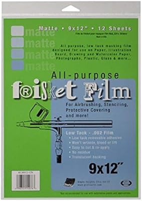

#6
Or I just remembered Grafix Frisket Film. As I say “Duh!” to myself.
#7
Oh! That’s perfect!!! :smiley: :smiley: :smiley:
