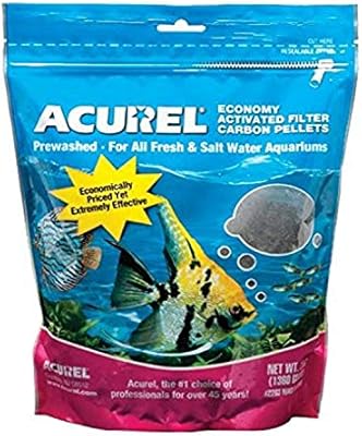

Also being from Canada – Alberta, mind you – I feel your pain of wanting to lase in the middle of winter. I didn’t opt into buying the $500 filter, because having heard that the base 40W will feature a standard 4" dryer hose, I intend to build my own filter box to attach to the end of the hose.
You can get activated charcoal/carbon on Amazon (normally used for fish tank filters) for ~$8 CDN for 3 lbs to filter the toxic stuff, and if you add a furnace hepa filter you get the sub-micron smoke/smells. You should be able to make something suitable for ~$30-35, depending how fancy you get with the ‘box’ part of it.

You’ll definitely want to make something easy to replace the consumables, like the charcoal/carbon and filter. I like the second video. I might make a half-size version of that.
I like the idea of making my own filter. It does scare me a little considering that we’re dealing with potentially bad gasses. But man… its so tempting… I’ll continue to look into it. If anyone does it, let me know!!!
