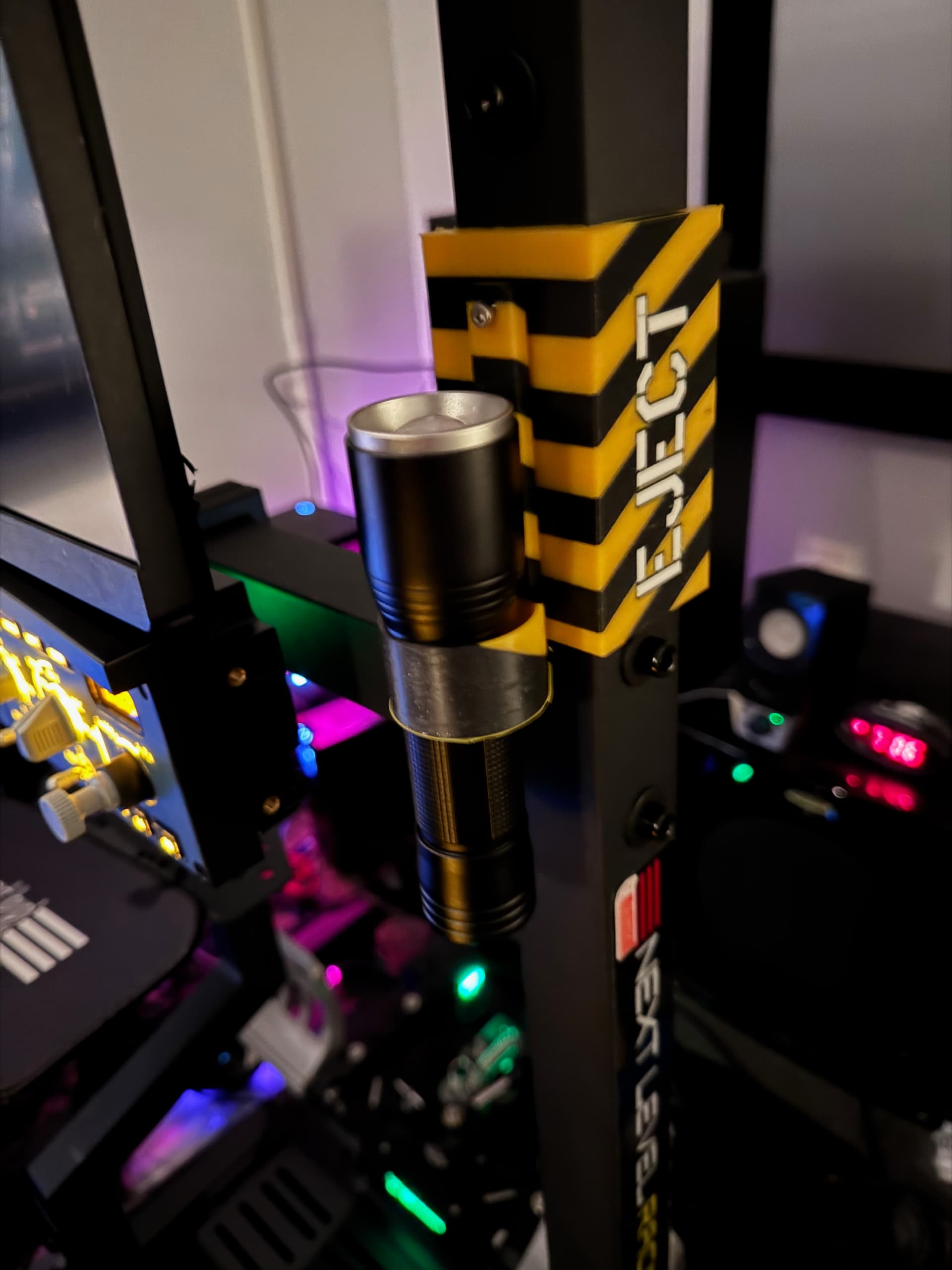

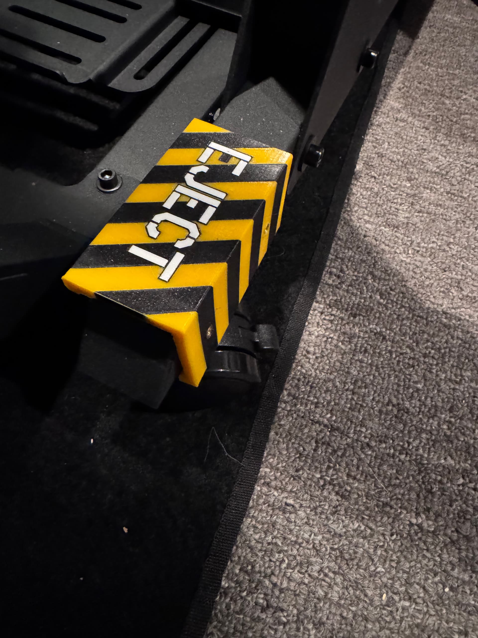

No, not from the GF community, one of my holiday presents for myself was a real sim-pit rather than the precarious balancing of all my WinWing hardware on my lap (just like in a real airbus! :grinning_face_with_smiling_eyes: ) Anyway, I bought a Next Level Racing MSFS 2024 sim-pit (it’s nice!). However like most modern stereo gear, everything is black, and you mostly use the sim in the dark, so A) it is a tripping hazard and B) you can’t see all the black USB-C cables to the gear (to debug). So at first I was just going to put reflective tape on the entry points and corners, but then the voice in my head said “What, the guy who put ATV off-road lights and a flashing beacon on his snowblower is going to just use reflective tape???” haha, so off to CAD (I try to learn a new method each time). So I decided to make it kind of airplane themed, and once I made one I realized I was going to make them modular to be able to put different accessories on it (go big or go home):

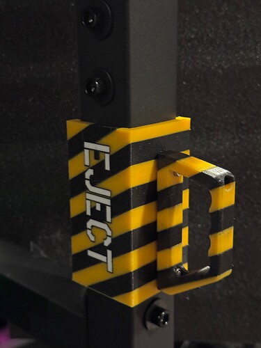

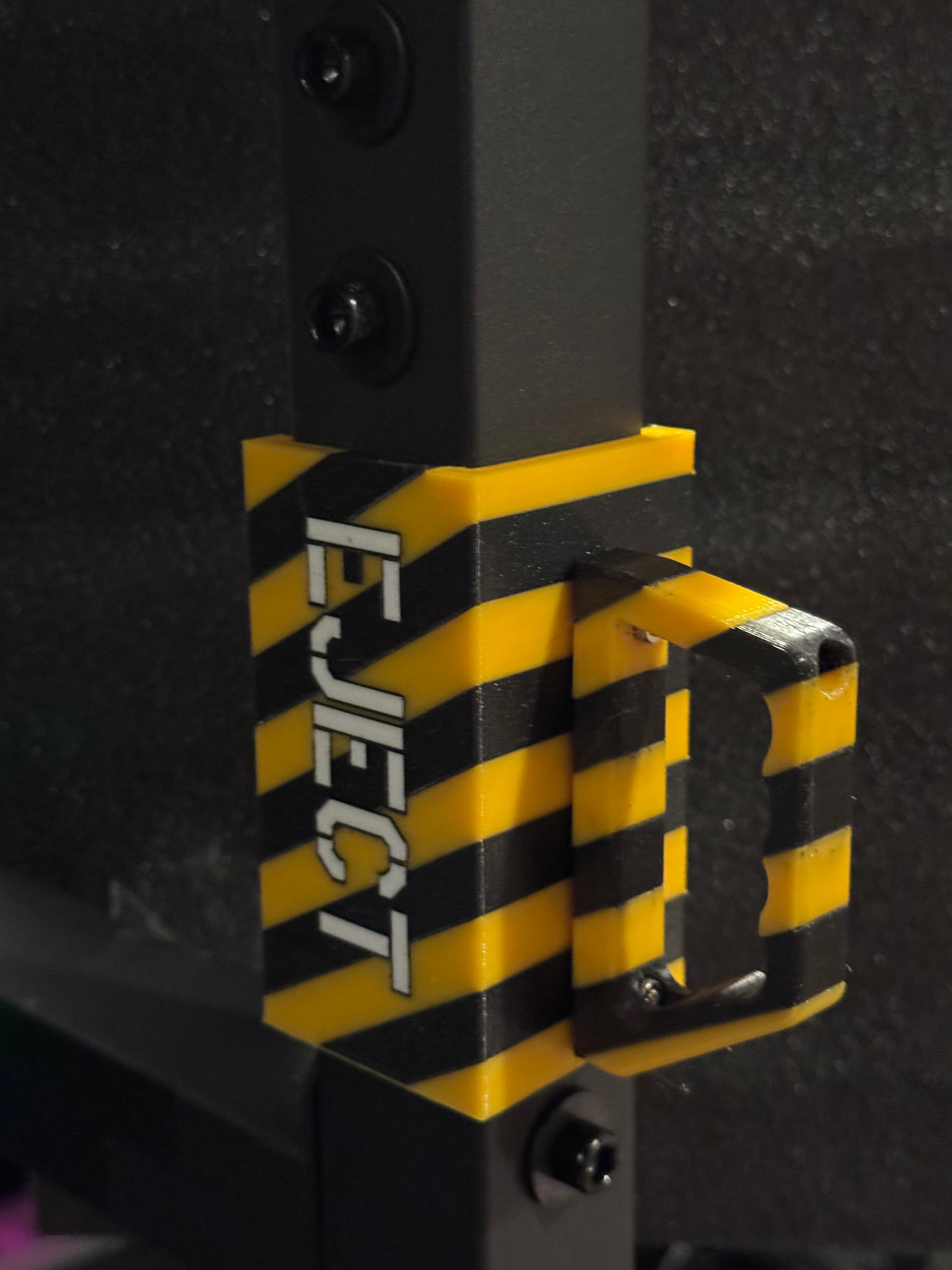

These are all printed in 3 colors of PETG on the Prusa XL. That is actually modeled like this (not surface paint that is full thickness geometry!). If anyone wants, it’s currently up on my printables page including the STEP files
just the safety marker
cosmetic ejection handle
Flashlight holder

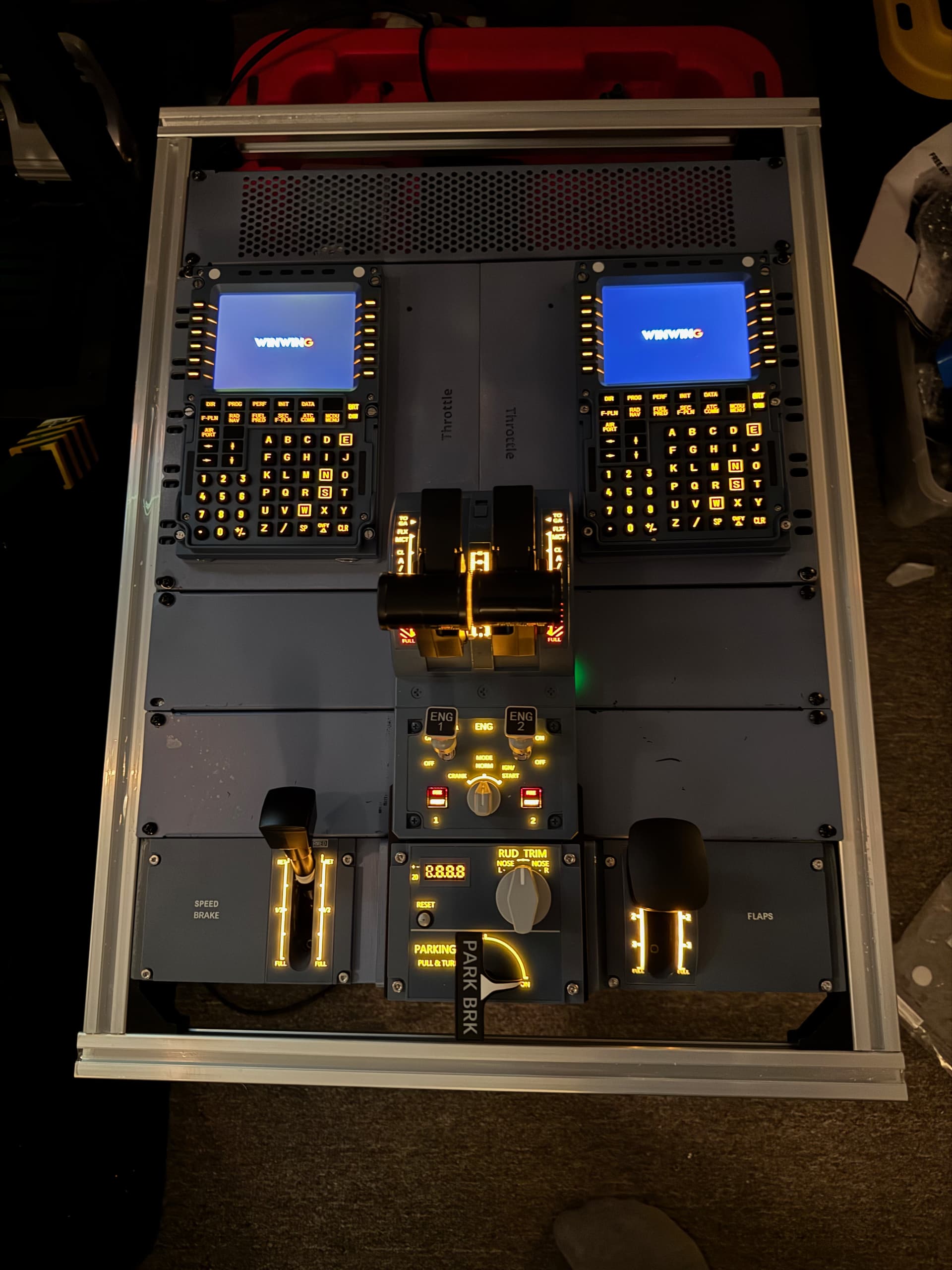

Just for a progress report, here is the top of the center pedestal (for scale that is a 19” rack in the middle which is what the Airbus has inside the pedestal) The panel that holds the two MCDUs at the top (and will hold the ECAM panel when WinWing ships it where the words “Throttle” are) is done in CAD and 3D printed with all the mounting holes can cable management for the panels, and then the panel that the flaps and spoilers mount on is a custom panel that I made to support those between the rack rails and the little rails on the sides of the throttle body (they use a M4 square nut as their holding nut. The frame is 3030 aluminum extrusions, and soon the side frame will be in place (it will sit at a 10 degree angle). There are vented panels on the top and on the front since a subwoofer sits under it. There is a USB hub inside and a 12-outlet power strip. They will eventually ship the radio and comm panels which sit below the MCDUs. Right now it is sitting on a rubbermaid container for testing next to the simpit
