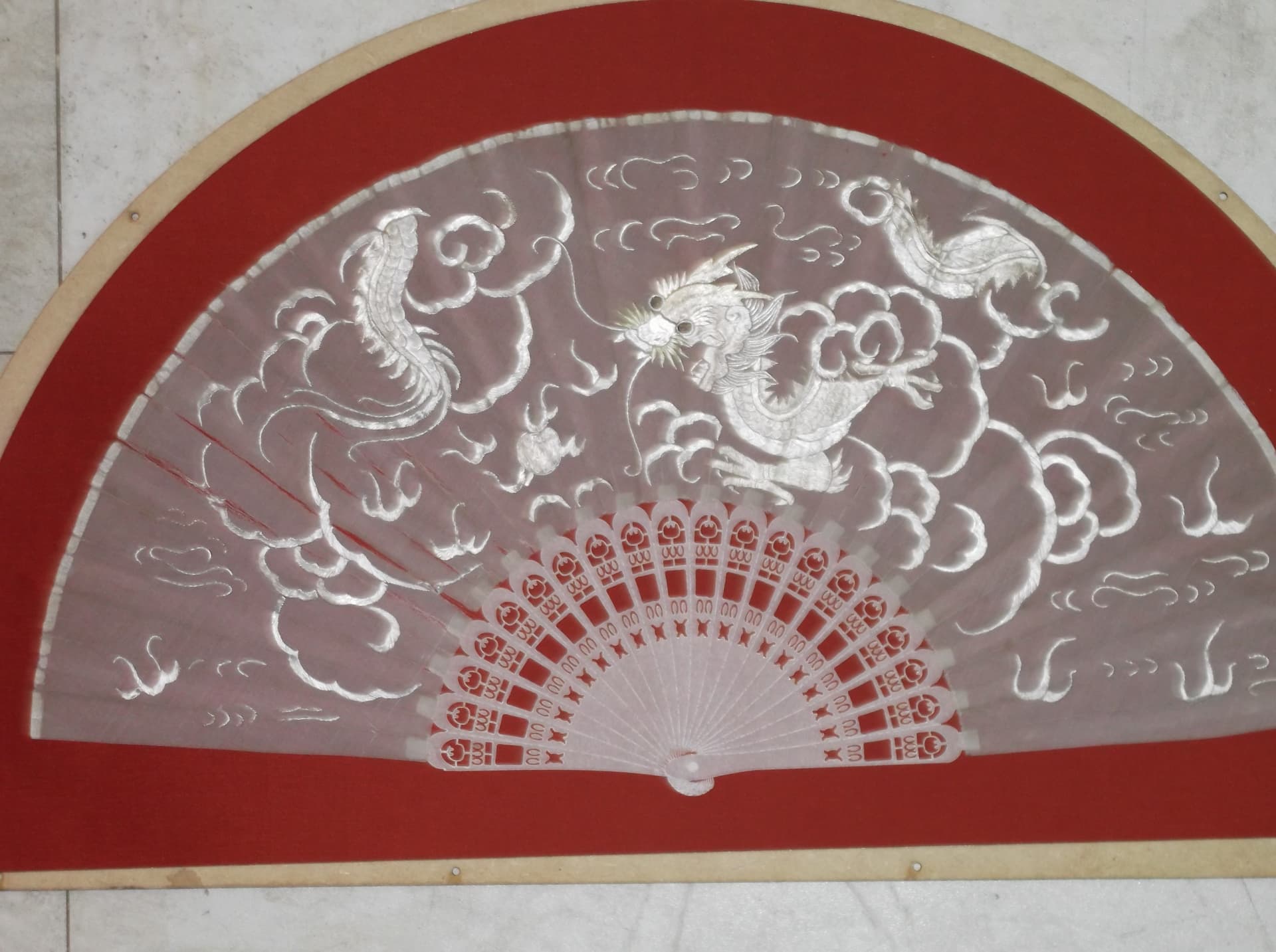

So I have a few antique Chinese embroidered fan leaves. Silk dragon, flowers etc, on probably habutai silk fabric.
With the granddaughters taking a fancy to them, they’re being framed as graduation presents, with what Wendy has christened ‘ghost sticks’ (engraved and cut vellum) to complete their appearance as fans (sticks disappeared long ago ).
This got me to wondering if I could reproduce the effect of the silk embroidery with a suitable iridescent/lustrous paper, and engraving the lines of the embroidery on it
Cutting out the design is straight forward, and creating the engraved lines of the embroidery in different directions is challenging, but not impossible, so I thought I’d post the first idea here, to see if anyone has done something similar.

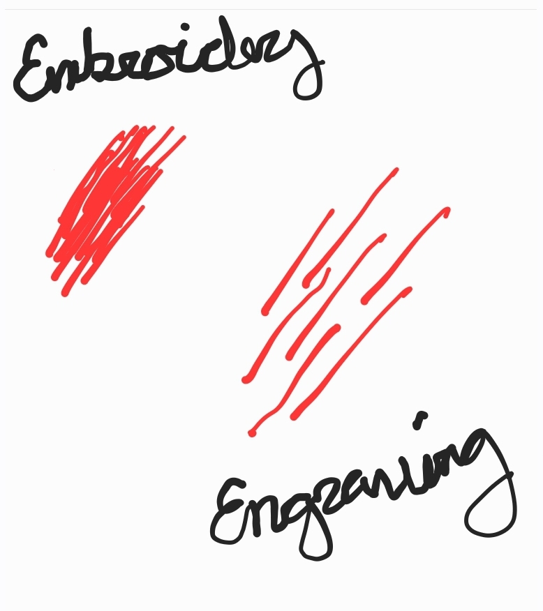

You can definitely engrave lines into vellum, and as stitches are tiny short lines on the surface you should be able to recreate some of that, but if you want it to be visible as stitch lines you’ll need to leave unengraved vellum in between, rather than the embroidery where the goal is to get the stitches as close to each other as possible.

Could you post an example of what you’re trying to achieve - an image from the web perhaps?
I’ll have a go later today. Setting up the lighting might be a bit of a challenge !
Overnight thoughts have only produced the image of a head-height brick wall ahead of me, but a few more glimmers show through the cracks.
John
You might even want to try making the “stitches” a little bit crescent shaped to give a bit of Depth of field. You could even choose a center point and make everything crescent around that.
If this is not enough, you could gently add “twist” to the “threads”.
Anything worth doing, is worth overdoing :slight_smile:
:upside_down_face:
I mean a web image of something similar… I’m having a hard time understanding what you want to achieve.
I have simulated “stitching” on brown paper…
This is the original leaf with my ‘ghost’ sticks, made from vellum on Goldfinger,
below it.
John
Got it.
I think you’d be engraving away too much for them to hold together, but if perhaps if the paper was first bonded to a backing (like the red in your pic)?
