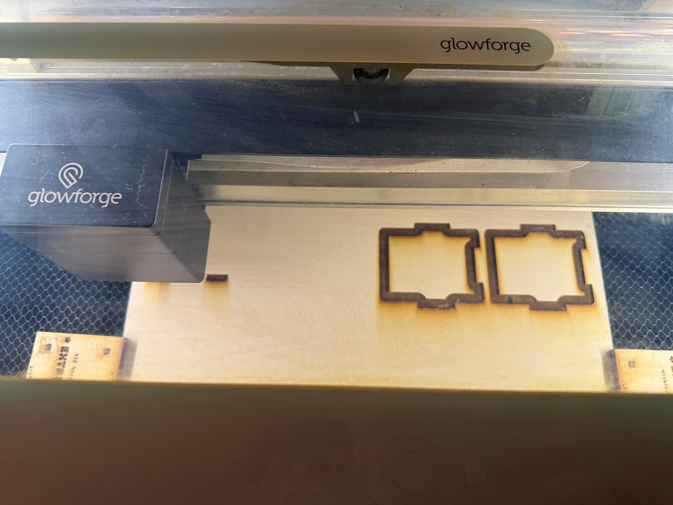

For me it was cleaning out the chute that directs the air from the fan to the cut that fixed it. It looked clean to the eye but when I shoved a qtip through it, a bunch of trapped dust was released!
@jenesperanza100 if when you cut your flame isn’t visibly being blown forward, check the chute. If it’s clean, your burn marks will all be blown towards the front of the machine:
Gently shoved. I hope ![]()
