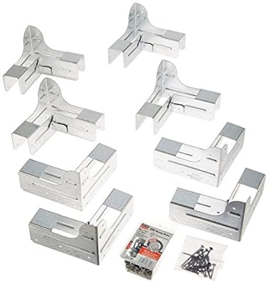

I know ive posted this somewhere on here before, probably multiple times, but if youre looking for sturdy and easy, this is what I, and a number of my friends have, and its been like a rock:
Similar to @takitus link, or if for whatever reason you’re plastic-averse… these are almost 25% cheaper…
Those Simpson strong-ties are what I used to build my layout table, but I just bought the pieces I needed at Home Depot.
It will take a bit more work than the plastic leg kit to get everything leveled out just right, but if you have a tape measure and a helper it is easy. I managed by myself and a bunch of clamps, but it was a bit awkward. The upside is that you can choose the perfect table and shelf height just for you.
Well that’d also be assuming that the floor is level as well, and that’s something which the plastic legs will have a problem with.
If you do all the legs at the same time and measure carefully, leg height adjustment screws (not included) would take care of the rest, I’d think.
