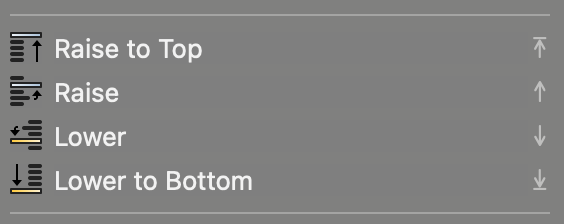

I use the object stacking function a lot, and although Inkscape Object menu shows keyboard shortcut symbols, I can’t find a key combination that works.
To be clear, the Layer shortcuts work fine, I am talking about simply objects where I want to pull one ahead of another, drop one to the bottom, etc.
Anyone know if this can be done? The symbols shown are simply the arrow keys, plain for up and down, and with shift for “to top” or “to bottom”. Obviously, those keys just move the object around in the workspace.

Thx. As my Macbook does not have a full-size KB with home and end, page up or down, I had tried the KB combos that work in other apps without success… Glad to see there should be a way, though.
Maybe this?
That is what I use in other apps all the time, it does not work (for me) to stack objects in inkscape.

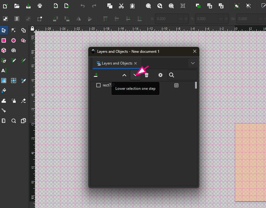

If you can manage a second screen, It is great to have the pop-ups there as they change based on what is happening so you have a much better “situational awareness.”
This is where you can move stuff up and down easily…

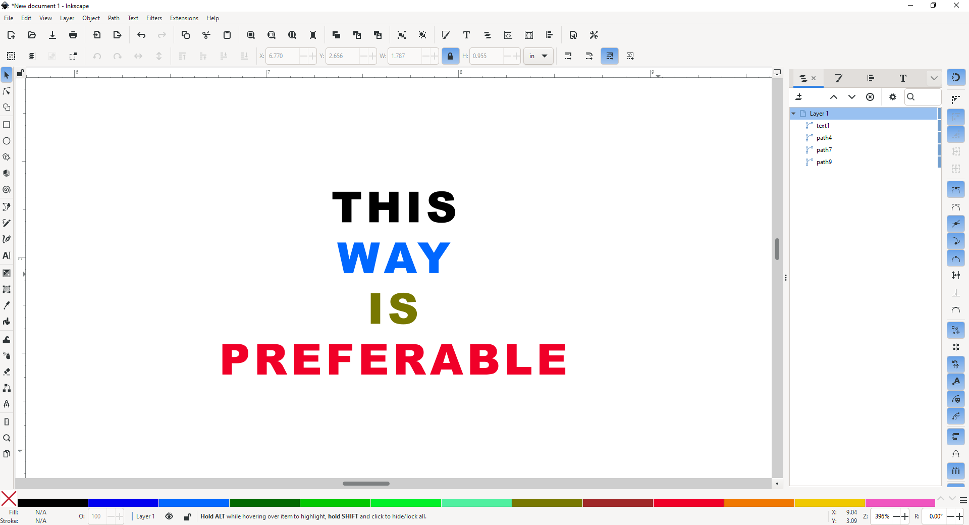

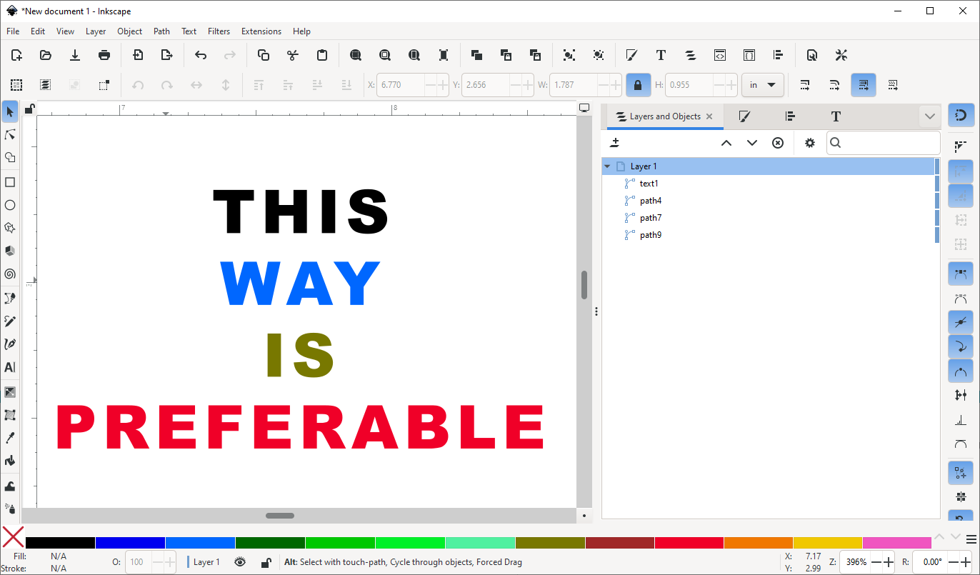

You don’t need to do a second screen, you can make it so that those dialogues pop up inside your primary inscape window as a sidebar. I never use the extra windows, the side bar works really well for me.

I try to use my mouse as little as possible. Moving to another screen is never going to be my preference. My screen looks a bit like this when I have the layer dialog open:
In reality, I use it full screen and the proportions are different:
For me, that’s plenty of working area and I don’t have to hunt around across multiple windows to find what I need.
