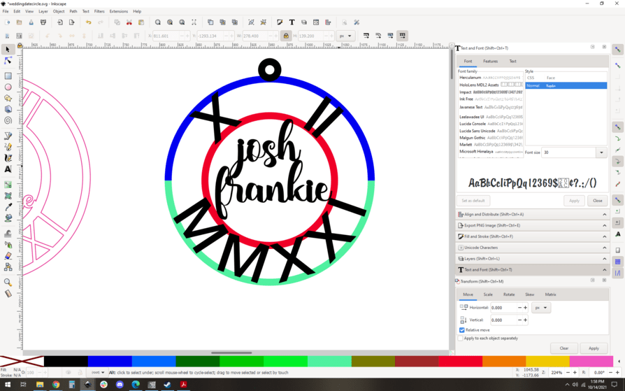

@evansd2 Here’s an example of something I was having problems with. I made the two circles then added the Roman dates and the names. I was able to do a union on the names, but when i tried to union everything together, I just can’t figure it out…so, i go in and break the paths on the circles and the names/numbers and ‘make’ it work…but way more trouble than i know i need to, just can’t figure out how!

Convert the circles to curves before you try to union them. Same with the text. Here’s how I do it in AD:

So your circle is ‘filled’ but will still cut okay? I need a ring around the name with the name part of the ring-make sense?
So i just tried this!! And, it works:-) Thank you guys so much! @geek2nurse I wasn’t converting my circles to a path! Appreciate the help.
Hang on…it ‘unioned’ it but if i cut it out, it will cut out the name from the ring…ryan and  abbl

If you’re cutting the circle but not the name, you don’t need to do the subtracting part (subtracting the letters from the circle). Just make the letters a different color from the circle so you can set them to score/engrave instead of cut.

OK. So this is a simple project when it comes down to it, but it does require a lot of steps to get it done with tight control and precision, so here’s how I would attack it.
Start with your art. measure the desired circle size, and match it. I made my circle have a stroke width of 0.1", again, matching your art.
Repeat for the inner circle and align.
Use the text tool to write your roman numerals.
Put the text on the path of your outer circle. Oh no, alignment is wacky!
This is about the direction of the path. To fix it, I break my circle into to halves (upper and lower) using the node tool. Then I use path->reverse to flip the direction of the lower half of the circle. Then, put the text on path again:
Much better, but it’s way over on the left and too small and too close together. One thing at a time.
Fix the size…
Fix the spacing… (I just added a space between each letter, easier than fooling with kerning settings.)
And now we fix the rotation of the text. You can do it a few ways, but I am going for max control so I am actually going to manually rotate it. Step one, find the rotation center you need. Snap nodes to the center of your circle… Turn on center snapping and pull nodes in.
Now turn on rotation center snapping and select your text. You can see the rotation crosshairs (small black plus). Grab that and snap it to guide your crosshairs.
Now, you can freely rotate the text to the correct spot…
Looking good! I want to convert that text to paths now, the standard way: path->object to path
Ungroup (note the letters are all in their own selection boxes now)
and union. Now the “M M X X I I” is one path object. Excellent.
Repeat the process for the roman numerals on top. I won’t bother with the steps here, it’s exactly the same. I made the X and II separately, and rotated them manually using a guide to keep them aligned correctly. (note the guide at the center bottom of the X and the center bottom of the II)
Now you add your text, sized and aligned as you see fit.
Lookin good! Convert that text to a single path, much the same way as we’ve done before: object to path, ungroup, union. (control-shift-C, control-shift-G, control-shift-plus. It takes literally 0.5 seconds with practice), Make a small circle loop and align it to the top of your original circle…
Great. Next we convert the circles to filled shapes: I color coded things so you can see how we have left things. Remember how we split that large circle into two parts? First thing up, we heal that by joining the nodes:
Now we have three circles to convert to shapes. Select the black loop, the inner red circle, and the blue circle, and do Path->stroke to path. You’ll now have filled shapes.
See the loop at the top with the nodes around the outside? Filled shape.
At this point I like to copy the whole thing and paste a new copy. This will let me keep the constituent parts separate incase I want to edit it later, but it’s optional.
And now the final step: select everything in your copy, and do a union. They are immediately joined into a single shape, and you’re done! (on right)
Now if we’re prepping this for a cut, you want to get rid of the fill…
Then since it’s best practice to cut from the inside out we want to color code it. First, we break it apart (control-shift-k)
then select the outer shape and change its color…
And then if we’re being super precise and want to keep best practices, let’s group the whole thing back up, so you cant accidentally move individual parts.
And that’s it! The skills here are quite basic: snapping, rotation, object to path, text on a path, etc… but they do need to be handled with some care and rigor to get it just right. You could cut corners and get it done a little faster at the expense of perfect alignment of things, but the steps are largely unchanged.
